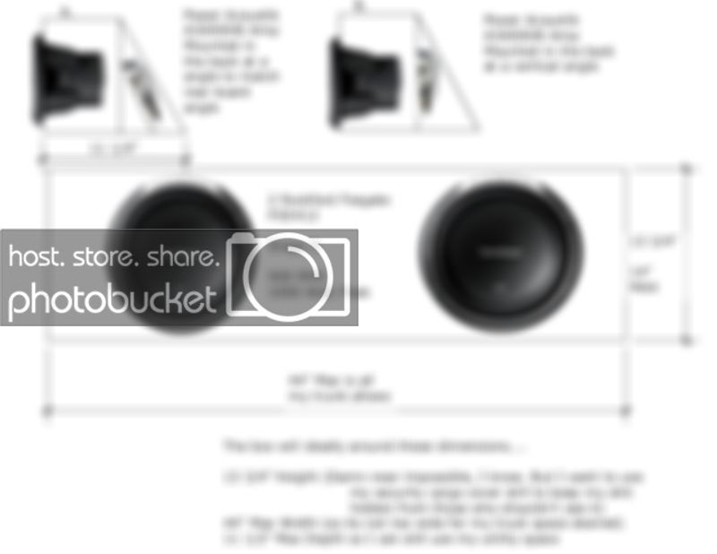

I need a custom box.
2007 Jeep Grand Cherokee
Ideally made from 3/4"
NOT ported. Carpeted to match the light gray of the interior.
This is my idea....
I could use some info as far as if its even possible based on the measurements I gave.
Any input from other is appreciated. Don't be annoying. I'm SERIOUSLY looking for someone who knows what they are doing and can show other work.

They suggested 1.09 cubic ft for a sealed box which seems small?
14 Height, 10 Depth, 13 Width Seemed the "default" suggestion.

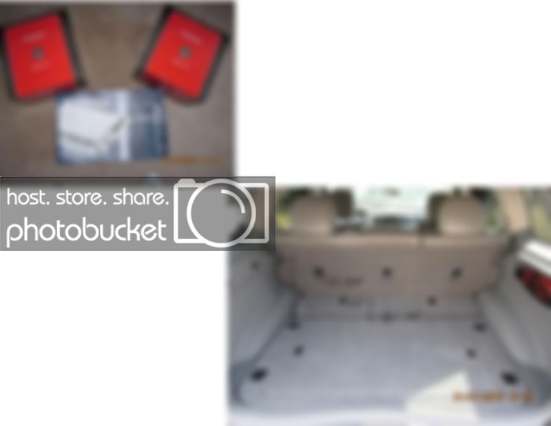

Mine will probably be more along the lines of 14 Height, 8-11 Depth depending on how I mount the amp, and about 43-44 Length to scale my entire cab so things sit flush. If you look at the pictures/drawings you'll have an idea.
And I may have a double box like shown in my picture with the amp behind the subs...
I may need to draw up more ideas tonight to maximize my possible cu ft. and mount my amp a certain way. I think I have an idea as to how I want to do it.

OK, I just went to RF site for your sub. click on that, then "new box advisor" then follow..... your sub wants 1.9^3ft. No way you are getting 2 of them in those dementions you want. good luck though
Rockford Fosgate -
1.094 Target cubic ft
H-14
W-19.25
D-10
Box is 1.0 cubic feet.
The woofer displaces .094
That means if I want to do 2 woofers I need .188 of woofer displacement to worry about.
2 + .188 = 2.188
With the measurements I plan on doing, externally, I will have:
H - 13.75
W - 43.5
D1 (bottom) - 10.5
D2 (top) - 7
I get 2.25 cubic feet.
Subtract the .118
I’m left with 2.062 which is more than what is asked for.
