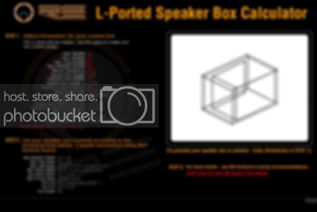

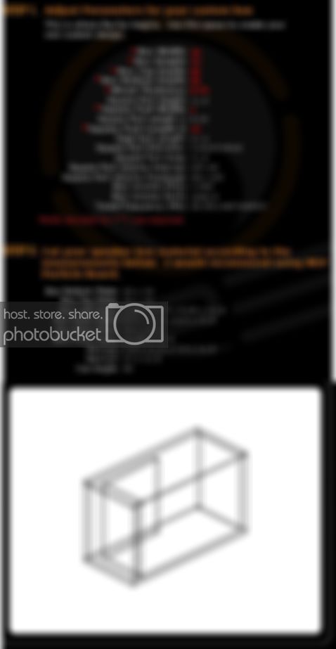

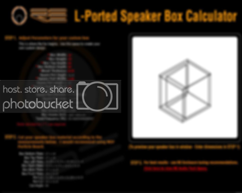

Im new to the board and was wondering if I could get everyones opinions on these boxes .
Do you see any benifit to one over the other and if so why?
They are two options I was looking at for a Type R 10.
Personally, i would do more around 1.5 @ 30-32hz for a daily setup. And i would want more port area.
OK I was just basing them off the info in the Alpine manual, its suggested 1 cube net tuned to 35 Hz
Out of curiousity why would you run more volume then what the spec sheet says?
Does this one look a little better? I really dont want to go any bigger, as the purpose of this single ten was to downsize the box from my 2 12's. This box is already approaching the size of the old one.
But being ported vs the sealed 12's. And a better quality sub (type R 10 vs 15 year old waveform 12's) I'm hoping to keep the output similar if not a little better with the new setup.
