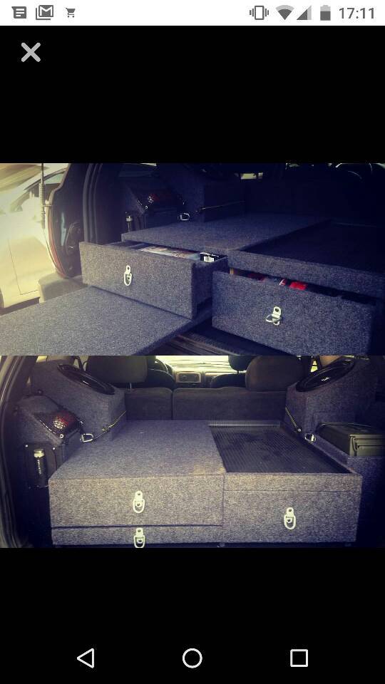

My thought for placement of the sub would be between the middle seats and some drawers

That's a good lookin SUV if the pics I just looked at are accurate.

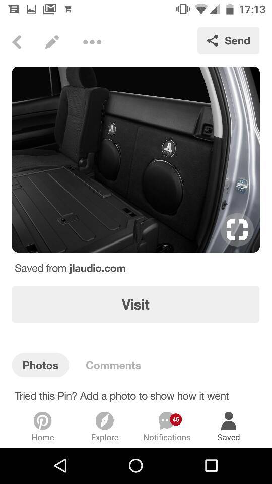

Usually some room in one of those for an enclosure.
I'm kinda lost as to where you are referring to for the enclosure to go... something is lost in translation I think.
Do you mean like these?
That's a good lookin SUV if the pics I just looked at are accurate. Usually some room in one of those for an enclosure.
Yeah it's a **** beast! Exactly right. Basically where the cage is so the drawers would be more shallow and the plan is between the back of the drawers and the 3 seats
Sent from my Nexus 5 using Tapatalk
Watcha thinkin?... sealed or ported?.. personally I prefer ported... better use of available power and you can tune to taste... wierd spot tho... kinda far forward in the cabin
