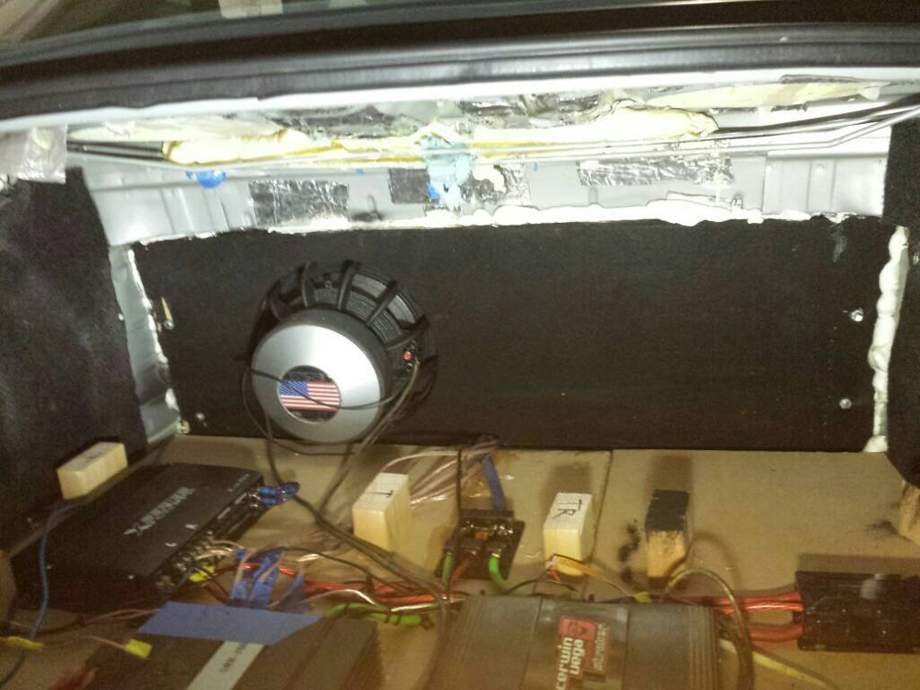

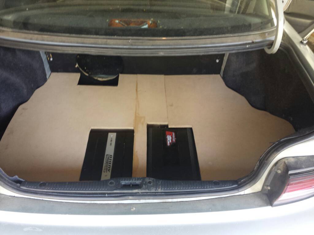

I mounted all my amps and then cut pieces of 2x4s the height i wanted thefloor to be, about 3mm higher than my tallest amp. I glued those pieces down to the base floor and then made/cut the 2nd layer. The top part of the false floor. You do what need to in order to figure out where those pieces will be under the top floor and then screwed the top to the 2x4s.
