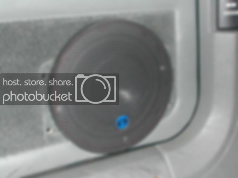

You sire, have inspired me to re-upholster my door skins this summer. This is how they sit now: (Stock speakers were 5.25's, and for some reason had a 4x6" cover laying flat, now I have 6.5s there). I will build an MDF ring for spacing and create a door skin with the correct size hole
