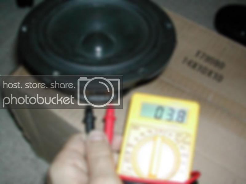

The meter was on ohms and it never got off reading "1". I placed the negative on the negative and the pos. on the pos. of the same set of coils. I don't know what to do.
any ideas? Anything specific I should check for??? I don't know what to do, how much would it cost for somebody to look at it?
When I put the neg. and pos. on one coil at a time I get close to .5 ohms for every coil. Is that the way I check to see if they are working? I assumed I put the + on the + of sub, and the - on the - on the sub. I always got a reading of 1 when I did that.
One thing I am thinking of right now is that when I had them wired up before I had 14g to every coil on both subs and I "may" have had one wire that was 16g on this sub. Would that affect it at all?
If not, how would I go about taking off the dustcap of the CVR so I can take a look...
One coil, one positive, one negative. No wiring hooked up. This shows a 4 ohm coil's DCR reading.
Okay I can't figure this out for the life of me. Every coil gets a .5 reading and I am ready to tear the sub apart. How do I go about doing that, take the dustcap off? I poked around at it and I don't know where to start. All the wires coming off of the coils look like they are in good shape. If anyone can help me in taking it apart, any ideas on what to look for?
