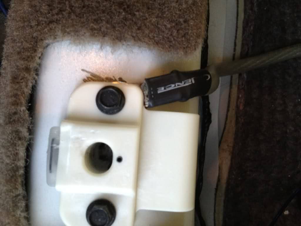

i just quoted everyone in here to see everyone's opinion on this ground is it good or ******?
It looks like your grounded it to plastic...that is a horrible ground.
You need bare metal that connects to the frame, not plastic.
ah great looks like i'll never have the same guy do anything to my car again. what would a better place be without having to add a new bolt? the car is a 2003 mustang
Yeah idk what your friend is doing or how hes working at a shop now. Pretty much any bare metal area that connects to the frame will work.
Find a bolt on bare metal. The Chassis preferably if you can get to it, and sand down a small patch of paint under and around the bolt. Put the ground on that and then use spray paint or whatever to cover it up after it is secure so you don't get any rust or corrosion.
