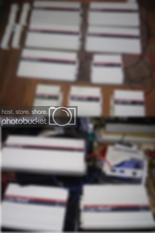

Yeah 2 punch 45's mint, 1 punch 75 pre hd, 2 punch 150HDs, 2 punch 250.1 powers (favorite), 2 punch 400.4s, 1 power 400@4 and 1 punch 250.2 power. Also have 2 PPI X3 crossovers, 1 AF 4, 1 punch X and a Alpine 3311 equalizer/crossover. I only like Rockford Fosgate.
Oh and a Lanzar Opti 1000.1 and 100.4 (ZED) awesome amplifiers. When I get the time and nerve I am putting the punch 250.1 power on my woofers and punch 400.4 on my mids and highs. Nothing like the old school made in USA amps.
how bout these bad boy's //content.invisioncic.com/y282845/emoticons/smile.gif.1ebc41e1811405b213edfc4622c41e27.gif
I am sure you already know about my collection, but what do you have for old school ciaonzo ? Anything rare or interesting that we need to see?
