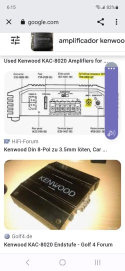

Im attaching a drawing to demonstrate the shape of socket its the power on left not hilighted din Screenshot_20230624_061533_Chrome.jpg

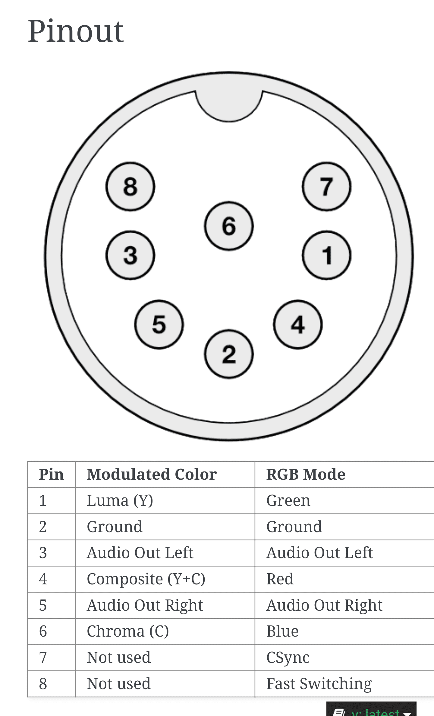

It looks like a standard 8-pin DIN cable. Those pins are actually standardized so any generic cable that has the RCA plugs will work. 8-pin 262° "horse-shoe" type.

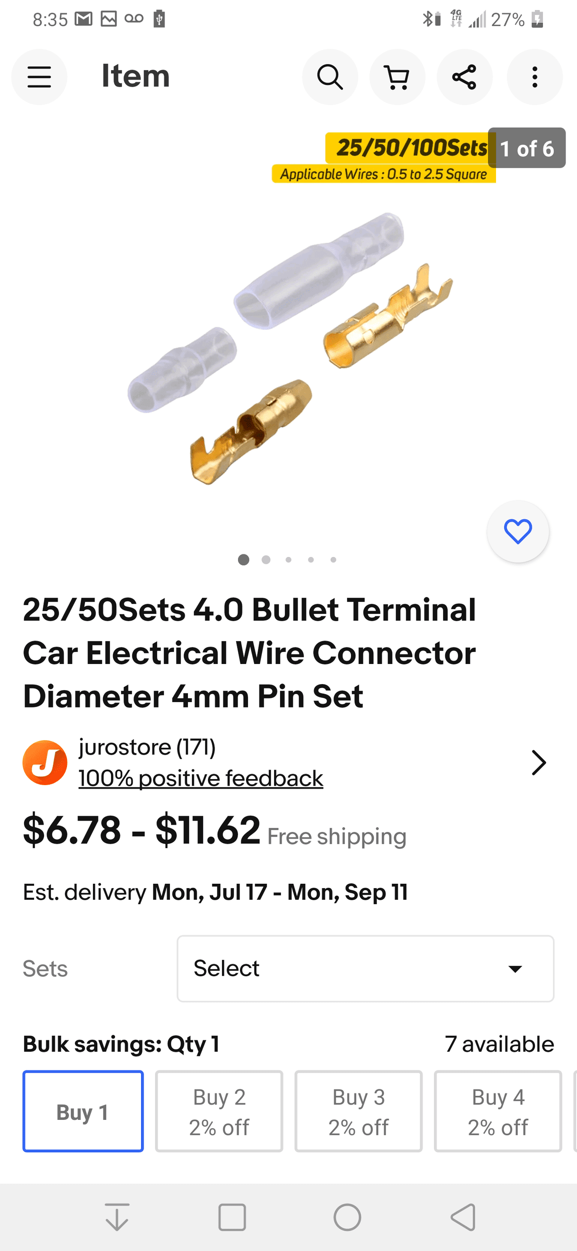

In that case you may have to McGuyver a connector out of raw bullet pins.
You do not have to acquire the actual plastic casing. I have made these out of gasket maker. You plug in the wired pins, inject the gasket maker between the pins, wrap that in painter's tape, then fill in the tape. To keep the silicone from binding onto the amp's harness you can tape the face before inserting the pins.

In that case you may have to McGuyver a connector out of raw bullet pins. View attachment 49879

Awesome...thats the ticket. Thanks again..you folks are great
