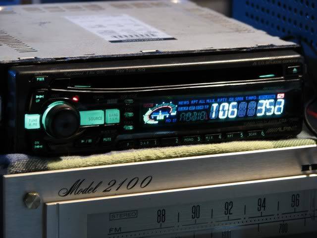

You can use the KCA-121B on CDA-#### head units to gain an aux input through the Ai-Net changer/processor connection. Here are some pics of models i've bought/sold/used in the past 5 years. All of these can play CD-R, have volume knobs, aux input capability, etc. 1996 is about as old as you want to go to still have CD-R capability. And note that with use and age, the ability to read CD-R's diminishes. You can get a replacement optical pick-up from PacParts.com for around $30 though.
Alpine DVA-7996

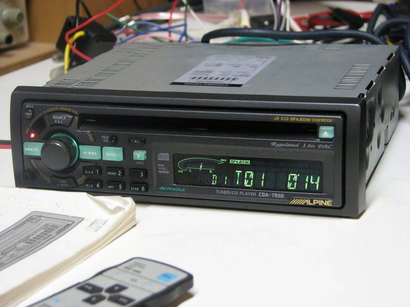

Alpine CDA-7930, ERA-G320, CHA1214
Alpine CDA-7940/7941
Alpine CDA-7939 (doesn't have a knob but doesn't use buttons either)

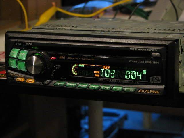

Alpine CDM-7874
This is what i'm using now - a mint condition CDA-7930:

i like the 1st, 3rd and last one.....what are the general feature differences?
Wow, that's a flashback, that 7930 looks exactly like my first HU back in '98. If it wasn't that exact model, it looked the same. //content.invisioncic.com/y282845/emoticons/smile.gif.1ebc41e1811405b213edfc4622c41e27.gif
The first one is VERY nice - the DVA-7996 is a great head unit. It would do everything you would want and more (DVD playback for example). The one pictured I got for a steal but it had some issues, I sold it for more than I paid (full disclosure). I would like one in mint condition.
The third is a great piece, one in Mint condition on ebay right now. I always liked the aesthetics of the CDA-7940 and CDA-7941.
The last is what i'm using today. It was new in 1996 and sat on a shelf for over 10 years. it is Mint, works flawlessly, plays CD-R's like any new hu would.
