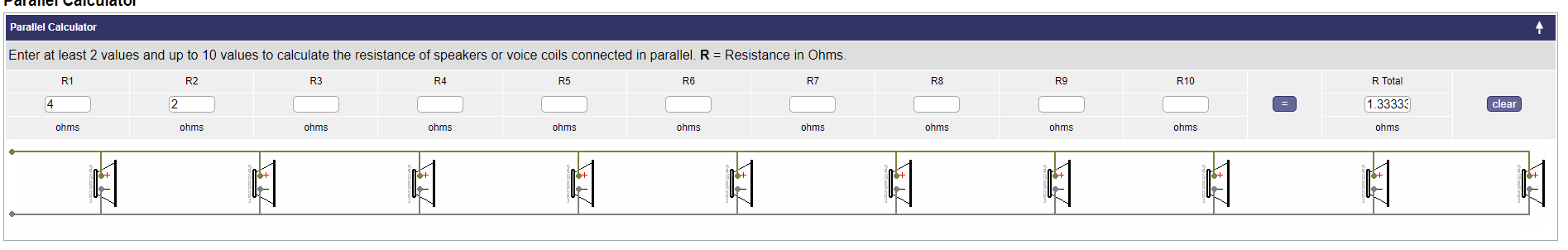

Use this to figure the resistance at the amp.
2 of the subs wired in series to 4 then wired in parallel with one at 2 gives you the option of a 1.33 load.

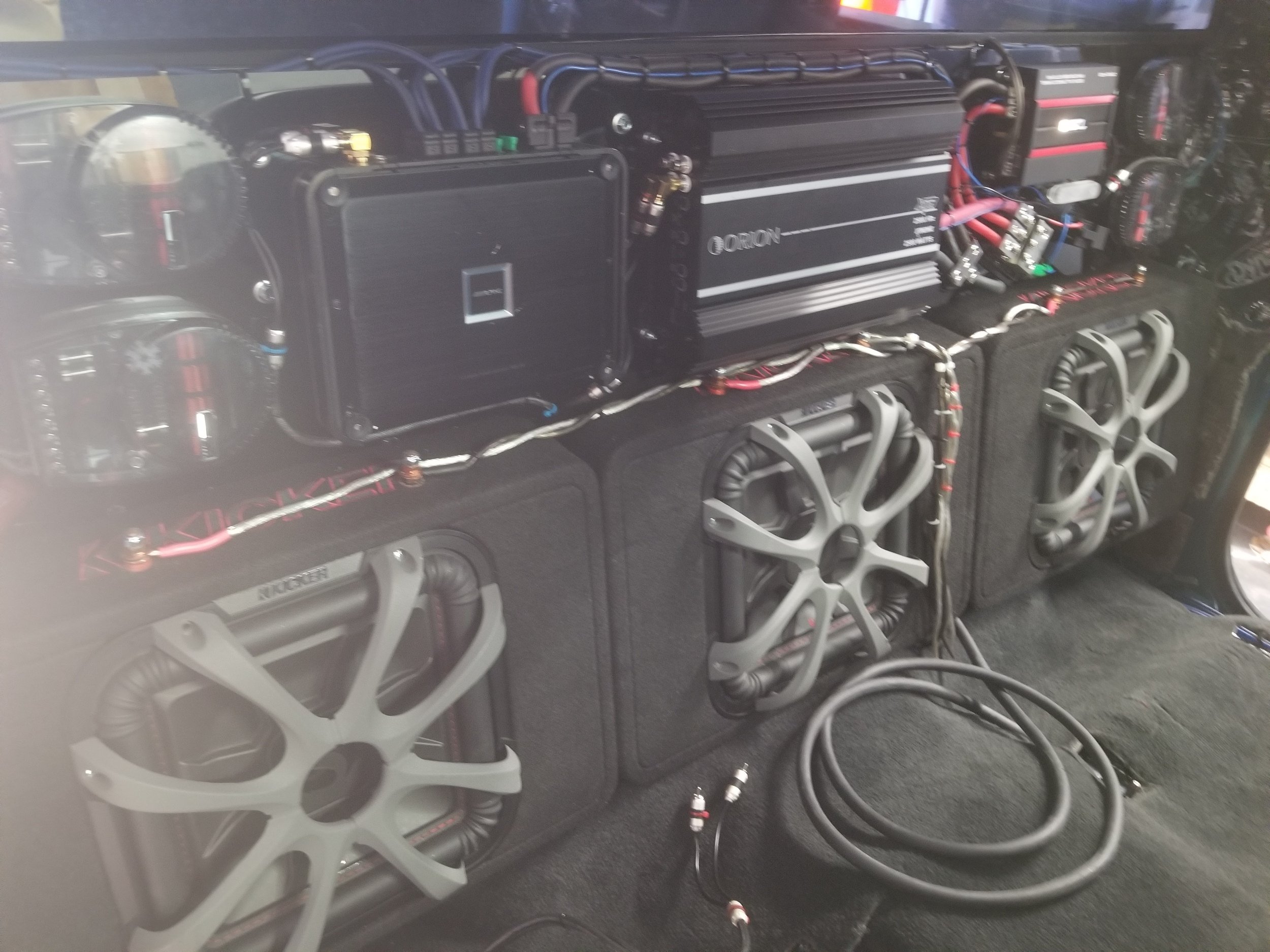

Yeah, if you haven't bought em yet, then get a matching third sub. I would wire them to 1.3ohm, unless for some reason, you have some really nice big sub amp that can't do 1 ohm. Amps don't play only at 1,2, and 4 ohms, that's just the common setups so those are the standard ratings, anything that can do 1 and 2 ohms, can do 1.3. When you do the math, 1.3 is right about the middle of 1 and 2 if you're looking at rated power to get an idea of what will work. I'm running (3) 4ohm dvc subs down to 2.6ohm.
