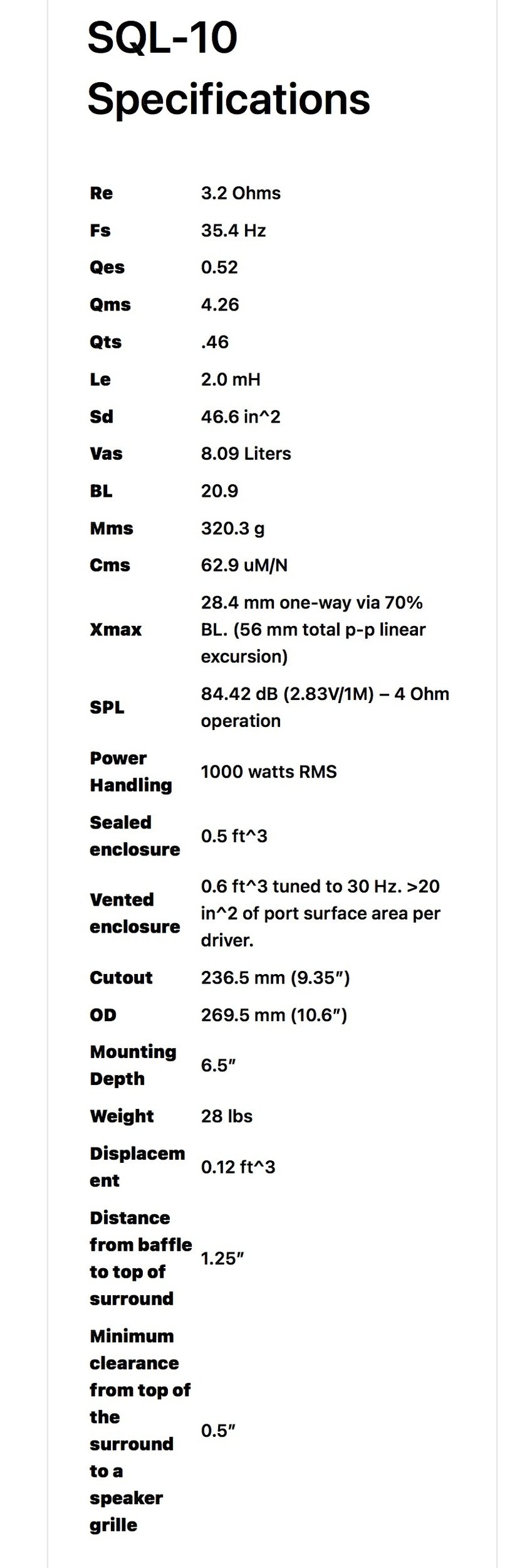

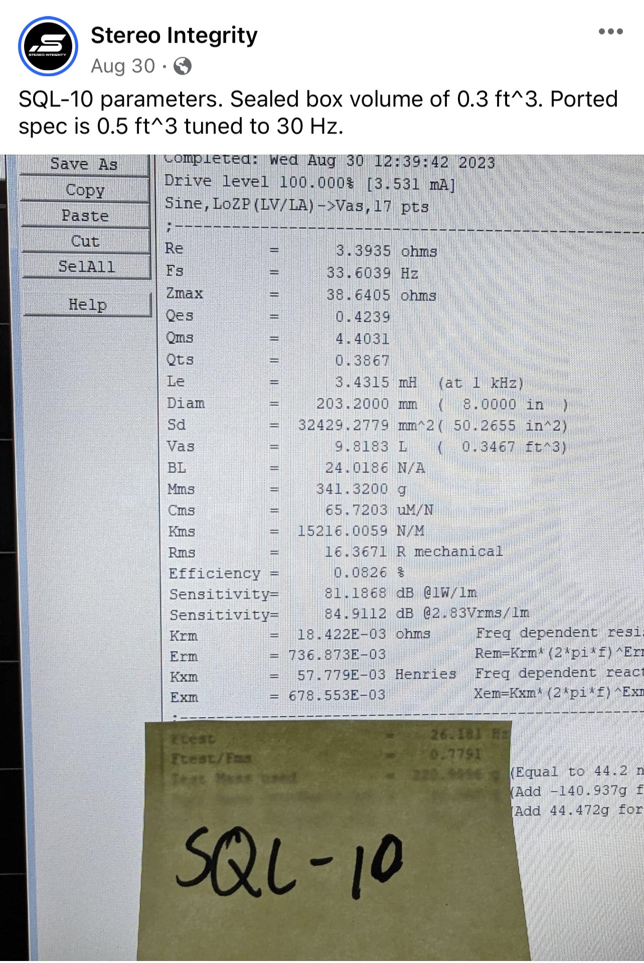

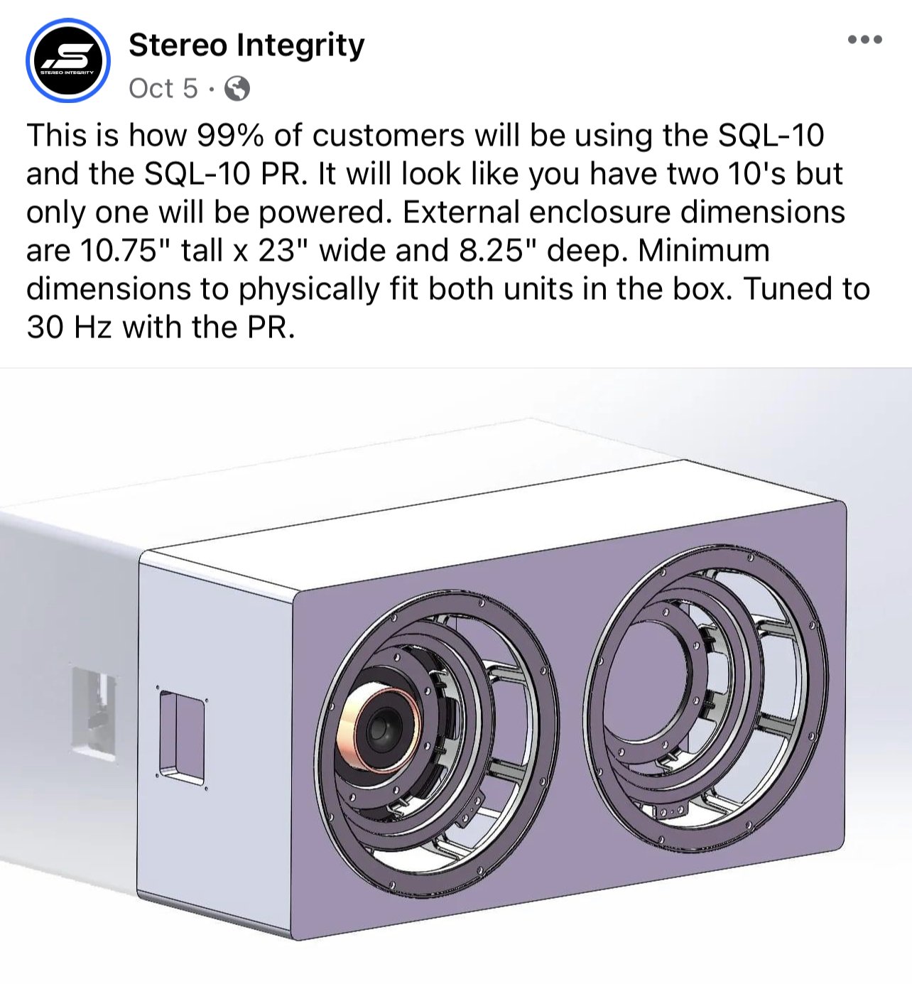

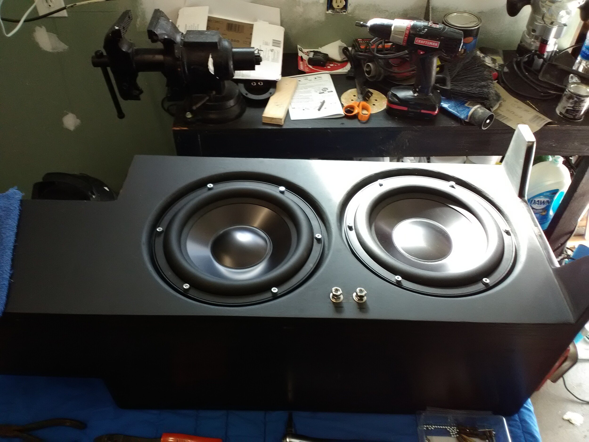

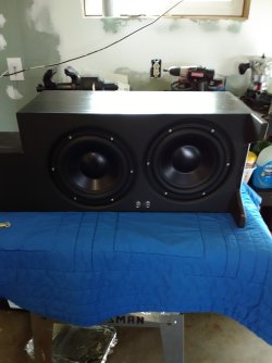

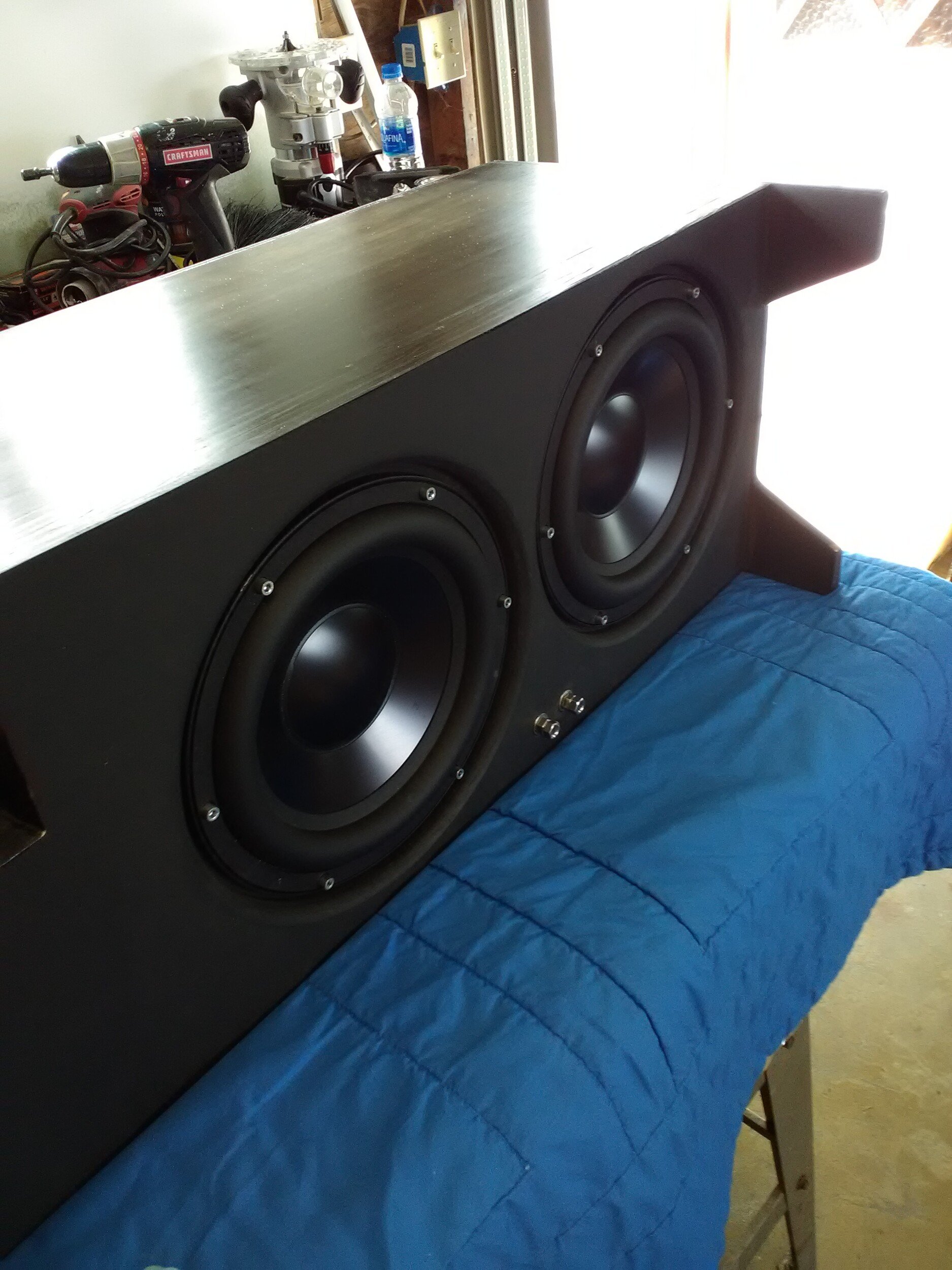

Oh wow! A ported enclosure of 0.5 cu ft! I remember a couple of weeks ago someone asked if you can mix ported with a passive radiator. We now know.
Is that the size they call for? Seems tiny for ported.
They use to say .55 ported on Parts Express and .75 at another time but the box sizes they give are usually for a home setting, The enclosure can be smaller in a vehicle due to cabin gain.

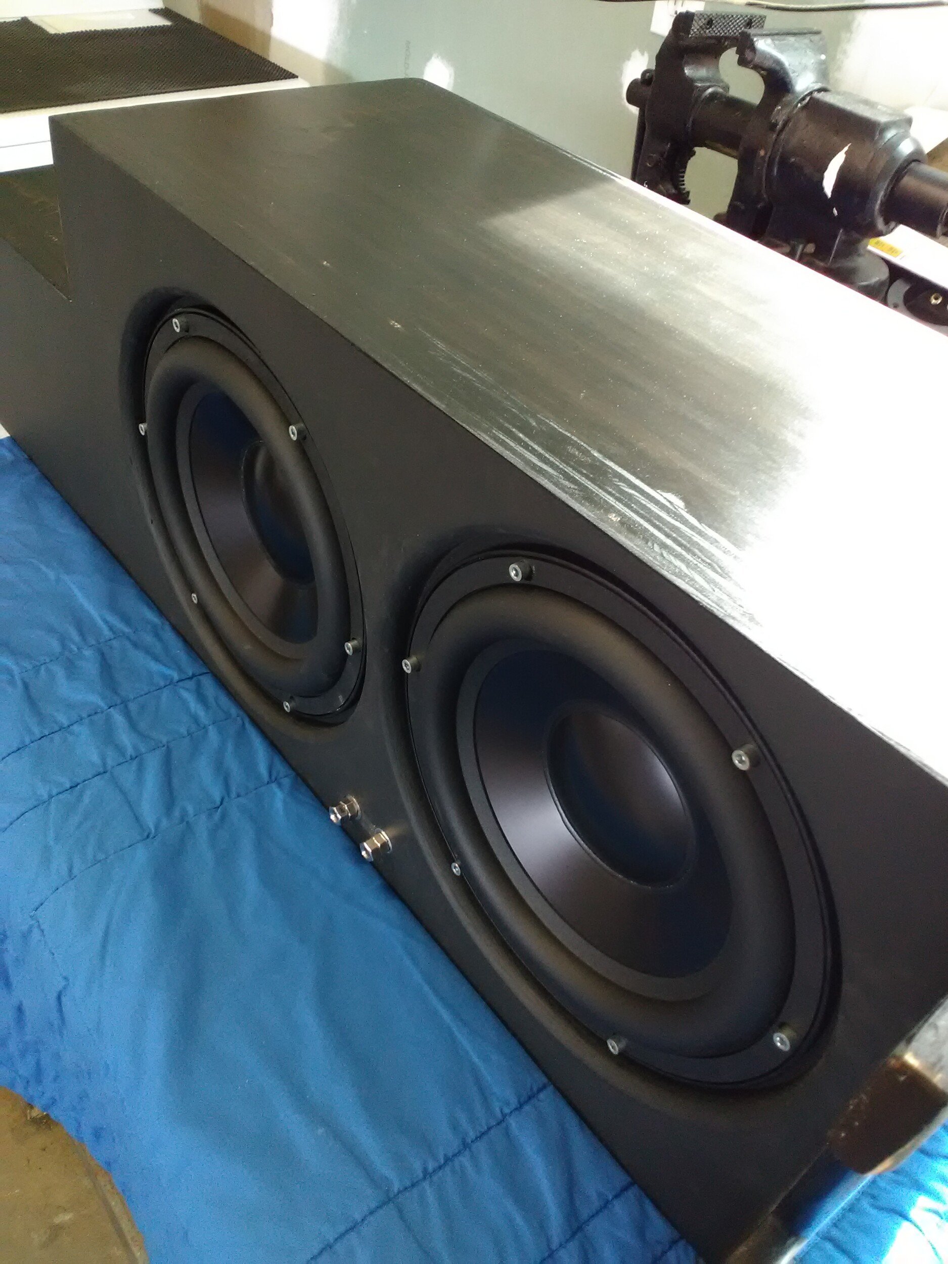

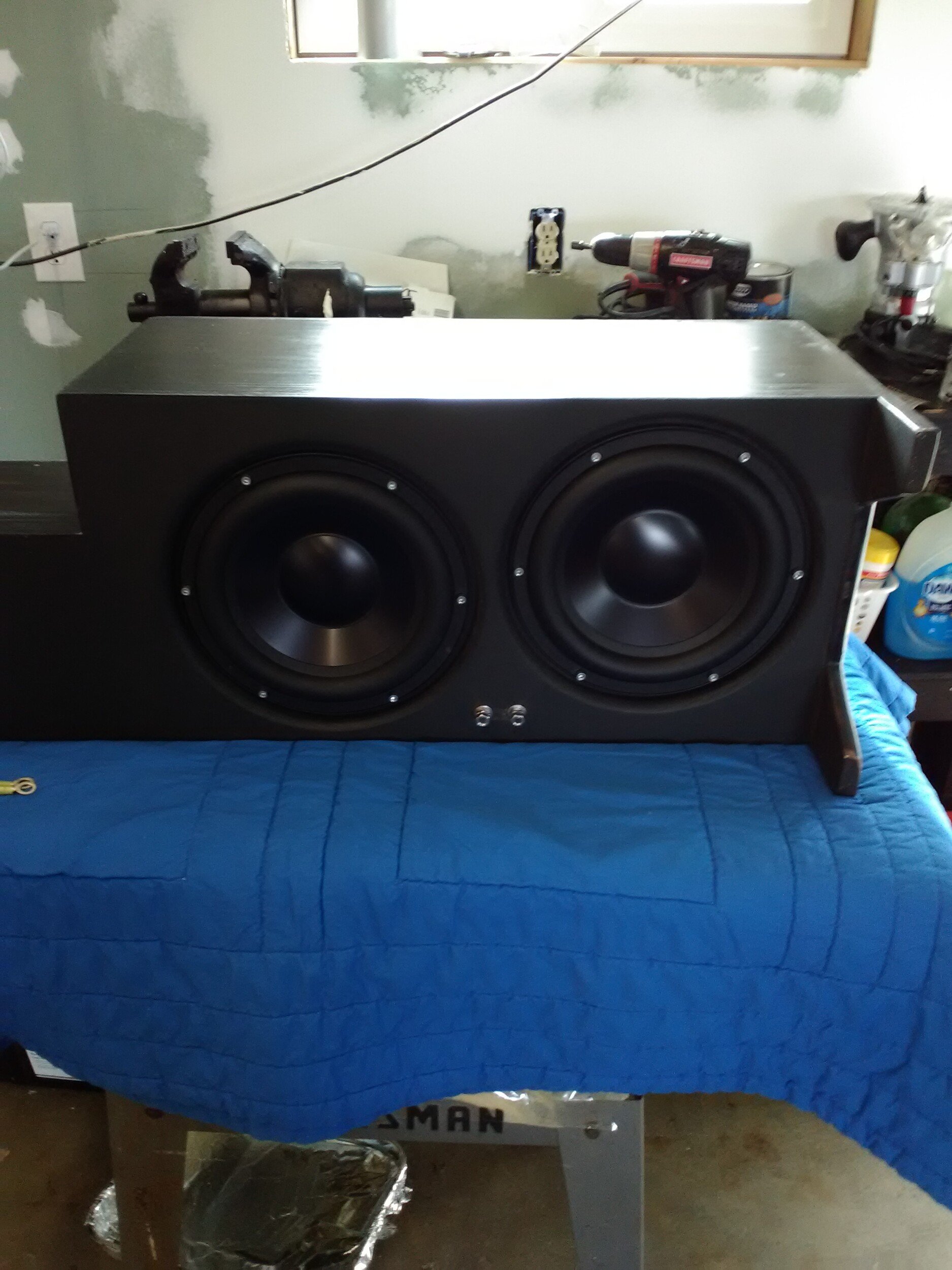

Buck designed the box a couple years ago.

Passive radiators are a port, did I miss something? Is the spec for a sealed w/passive radiator tuned to 30hz and the other for a vented enclosure also tuned to 30hz?

Very clean! Those allen screws are a nice detail, rounded flush mount, smooth black finish. I like it.

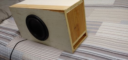

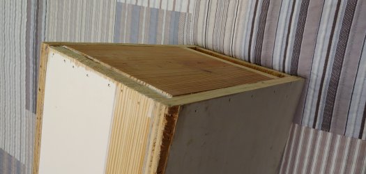

Compare your's to my latest work of art.20231012_221009.jpg20231012_221001.jpg
