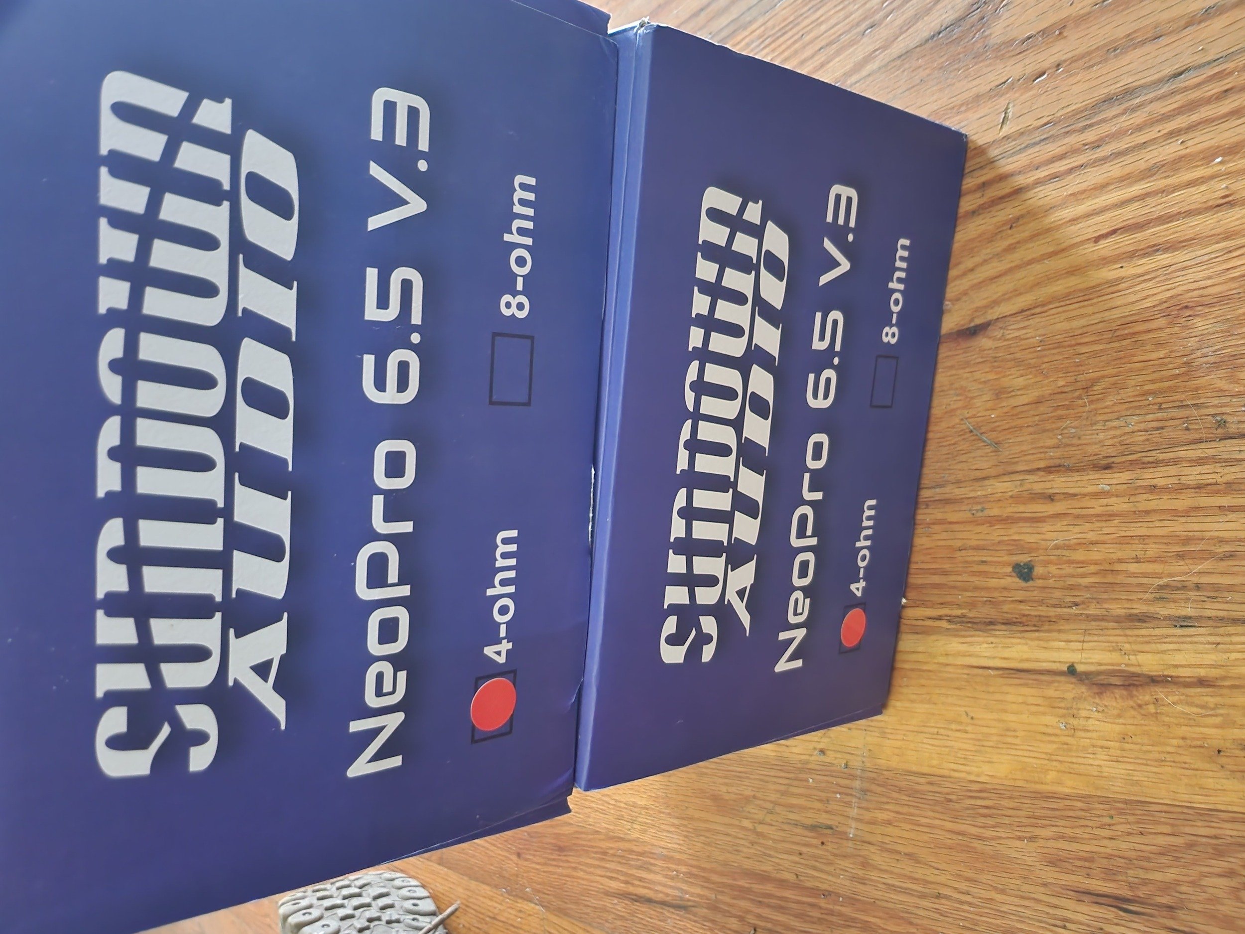

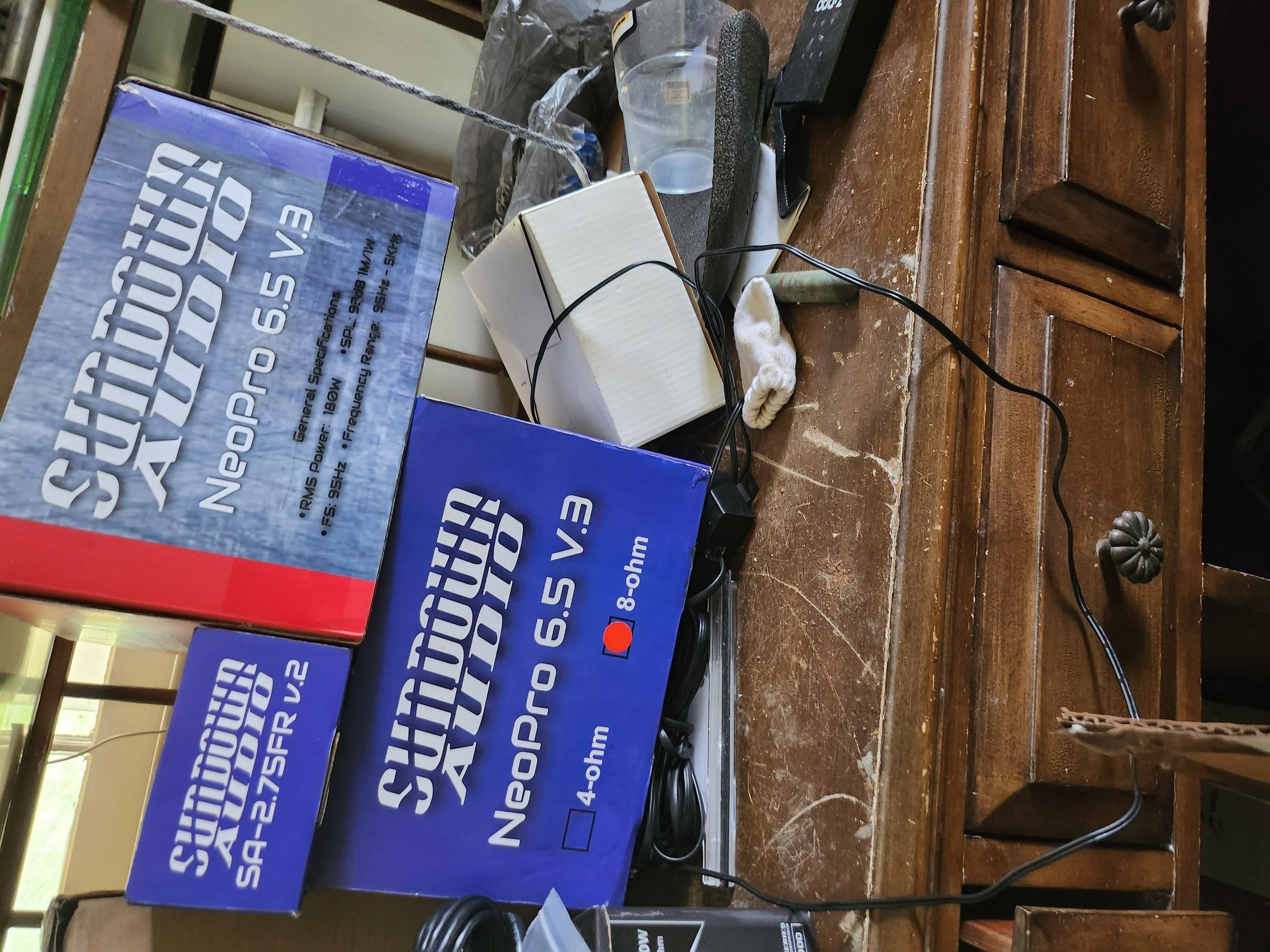

Can I put a 8 ohm an a 4 ohm speaker on the same amp channel? If so, how should I wire them,? I have 2 8 ohm speakers an 2 4 ohm speakers with only a 2 channel amp. Is their a solution for my problem?? The speakers are the same except for the ohms, sundown audio neo pro's 6.5, one set is 4 ohm an the other is 8 ohm.

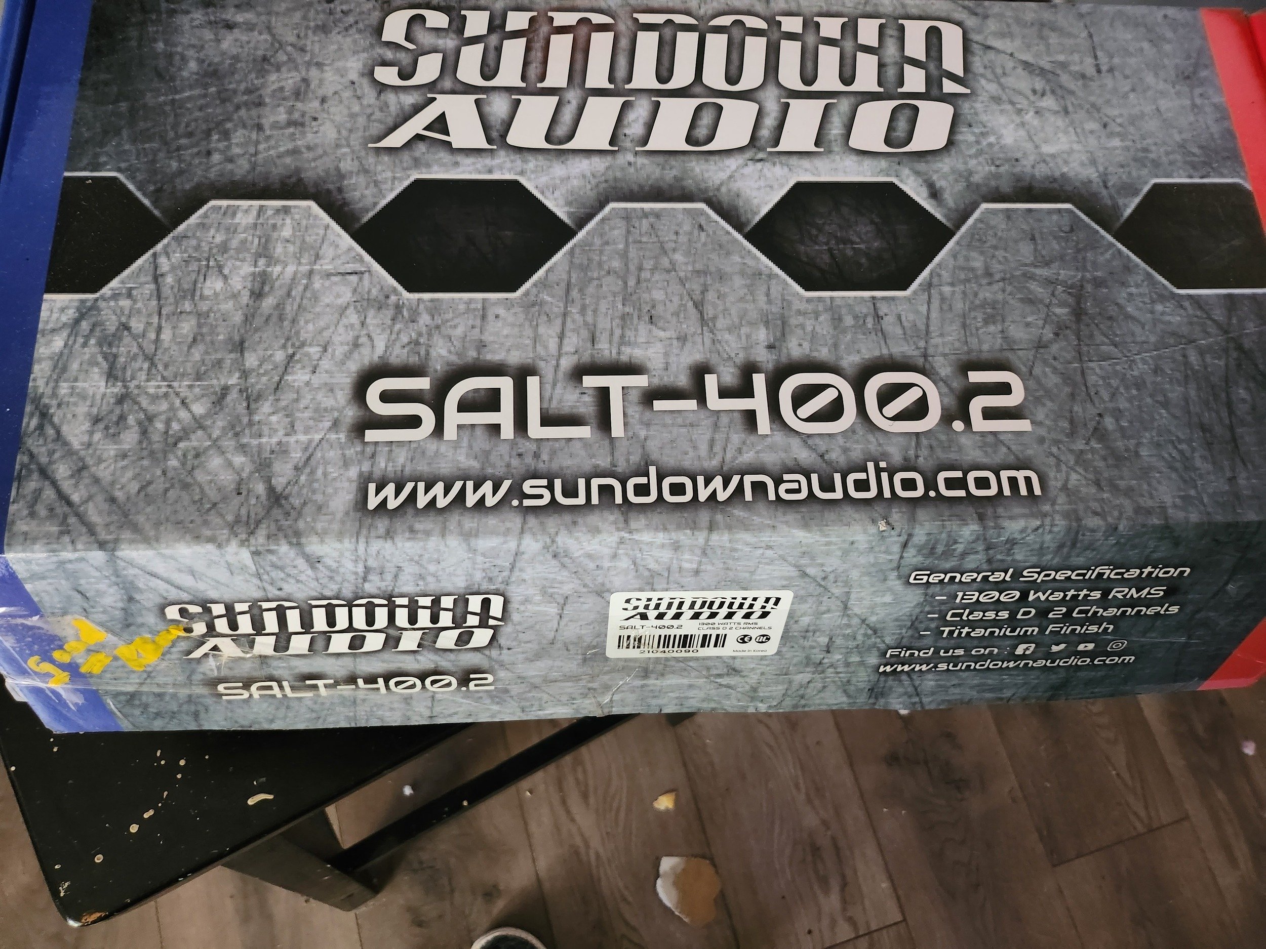

Assuming the amp is 2 ohm stable, you can wire them in parallel to the amp.
It is I'm pretty sure it is ,sundown audio salt 400.2. An is that one channel with 4 ohms an 1 with 8 ohms, or each channel with 1 8 ohm an 4 ohm ?? Cause I know that the 4 ohm in parallel is 2 ohm an 8 ohm in parallel is 4 ohm. Not sure what 8 an 4 ohm in parallel would be.
Should be fine with that amp. 8 + 4ohm in parallel = 2.66 ohms.
