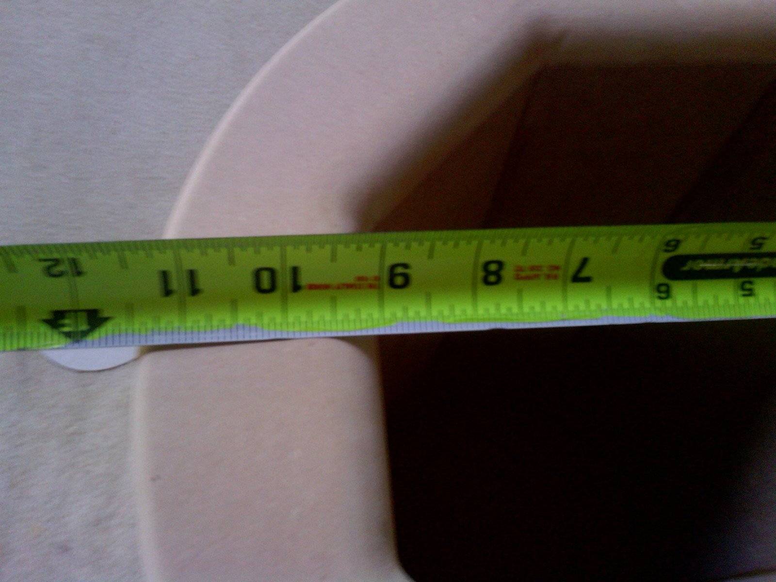

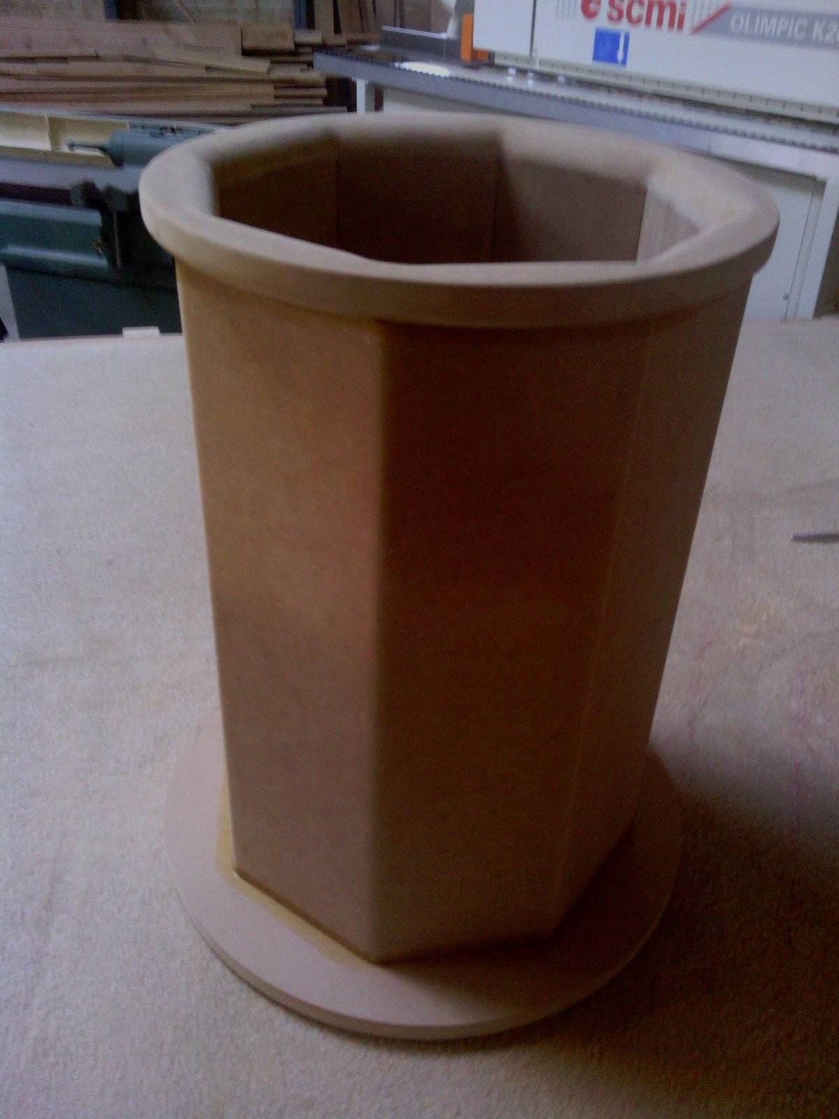

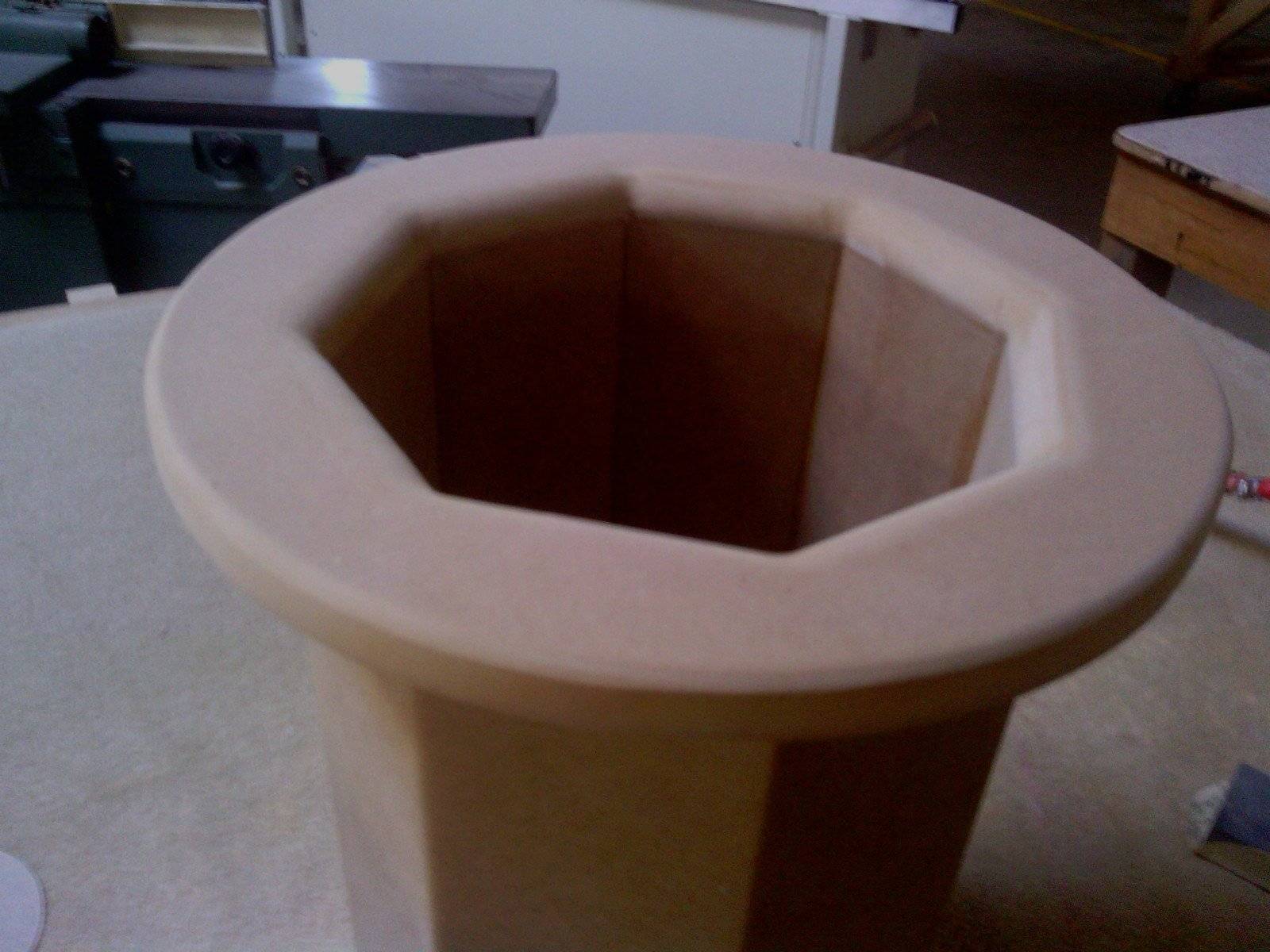

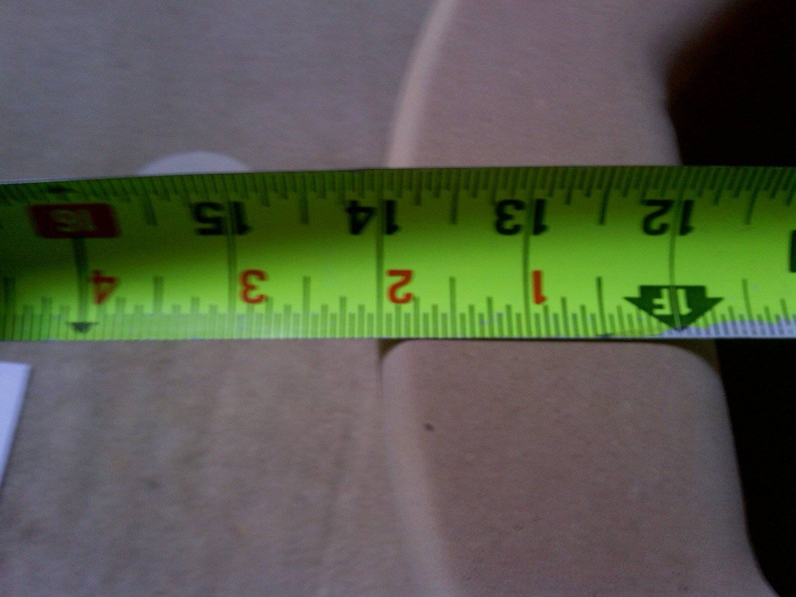

Finished the port and shipped today...should get to Bumfuck, Cananda in 2 months!

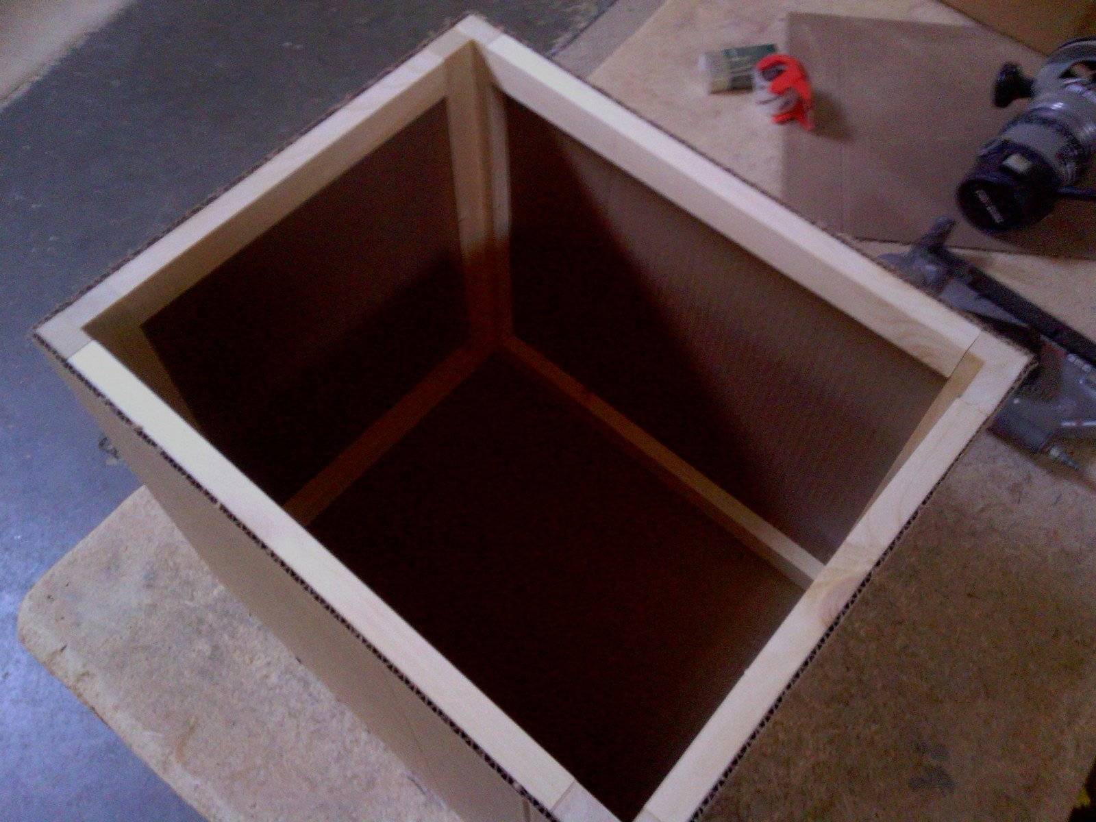

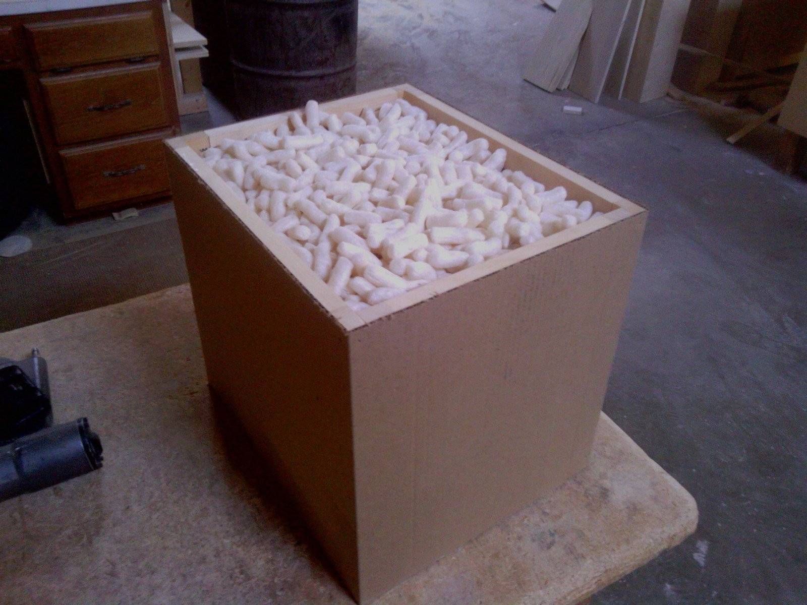

also built a badass shipping box.
