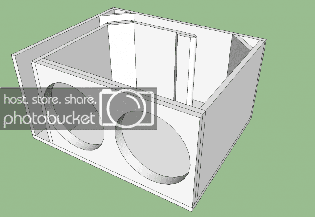

Specs come to:
-1.82 cubic feet net per woofer
-31.5hz tuning
-21.75 sq inches of port per woofer
The design...

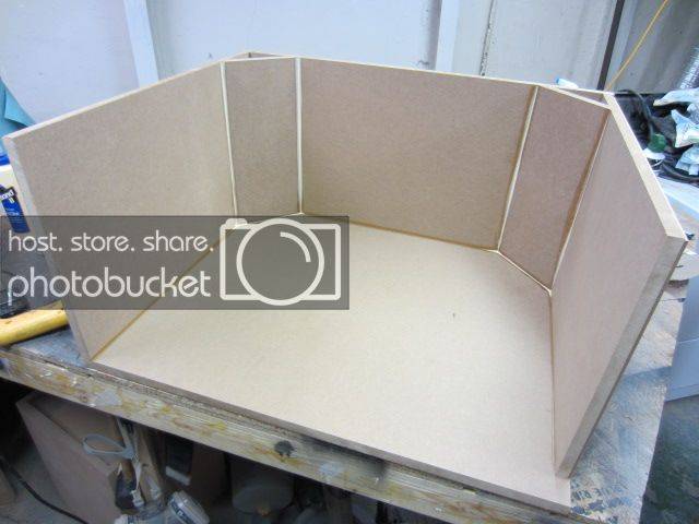

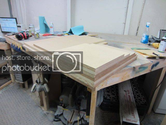

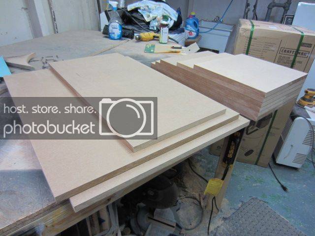

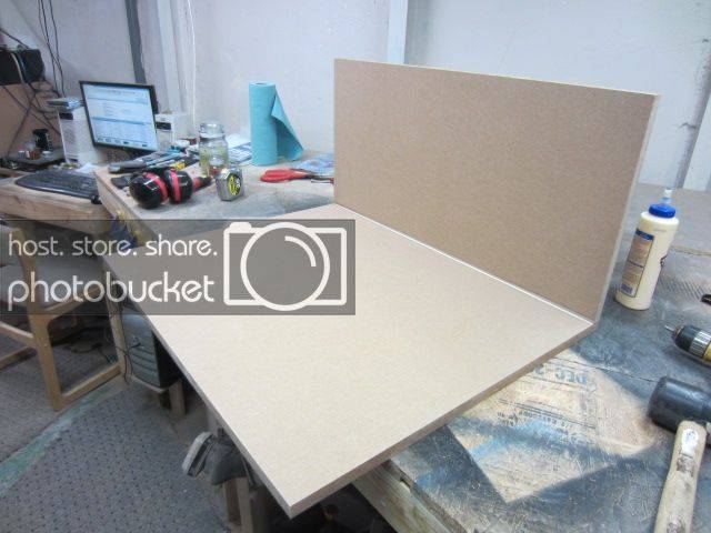

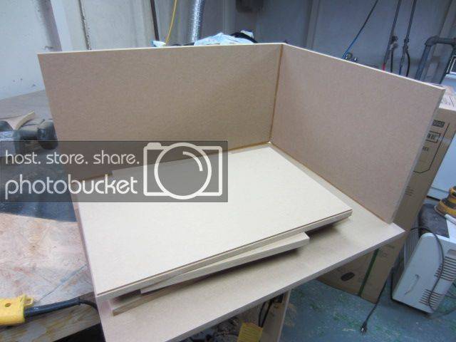

Let's get started...vertical pieces cut...

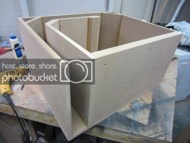

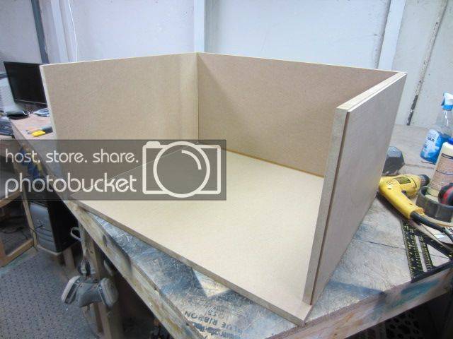

Back on...

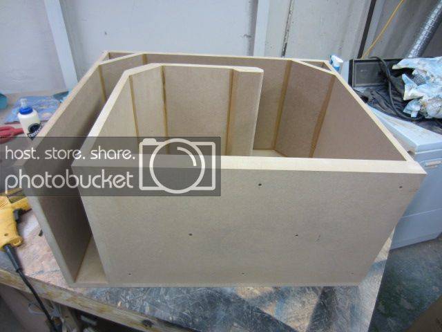

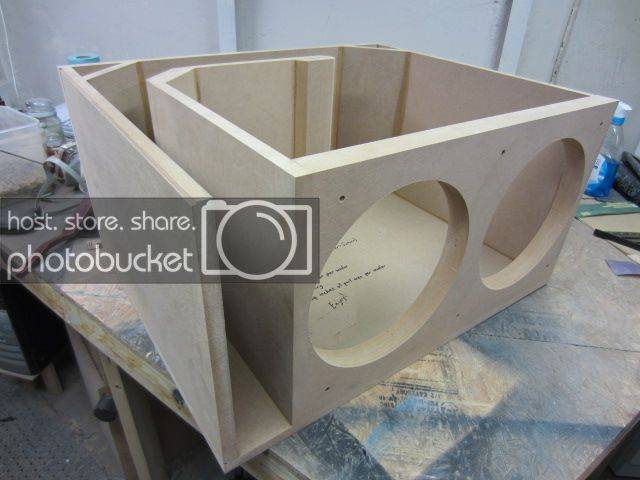

Side on and side pieces rabbited for carpeting...
More to come tomorrow //content.invisioncic.com/y282845/emoticons/wink.gif.608e3ea05f1a9f98611af0861652f8fb.gif

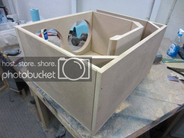

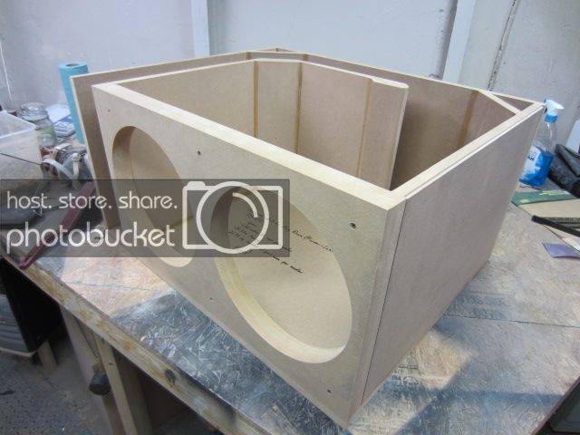

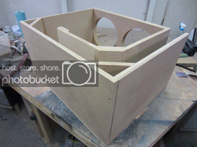

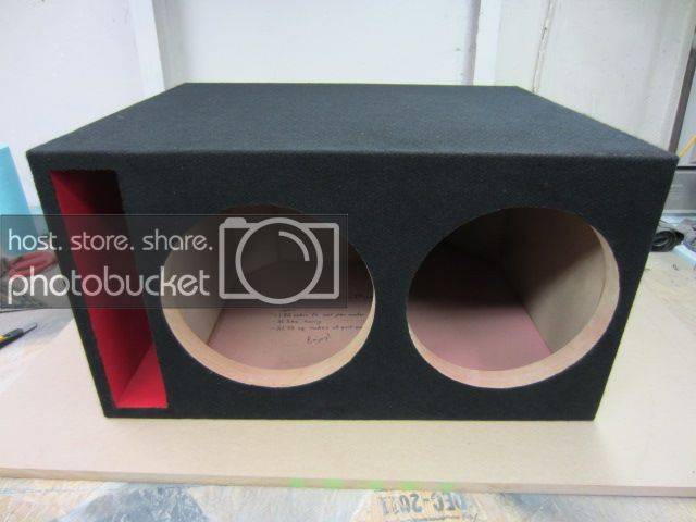

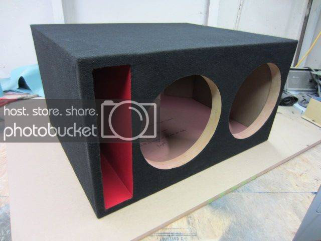

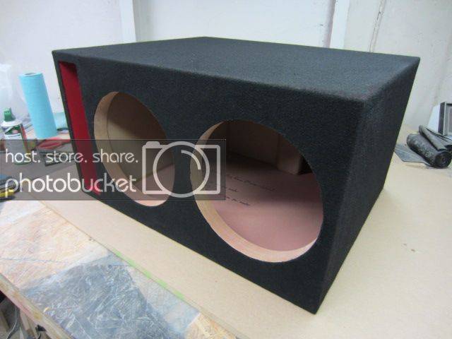

Got cutouts made and everything cleaned up...tomorrow I'll be off from work so this will be completed //content.invisioncic.com/y282845/emoticons/smile.gif.1ebc41e1811405b213edfc4622c41e27.gif It will be getting black carpet and red paint in the port along with gold binding posts //content.invisioncic.com/y282845/emoticons/smile.gif.1ebc41e1811405b213edfc4622c41e27.gif
