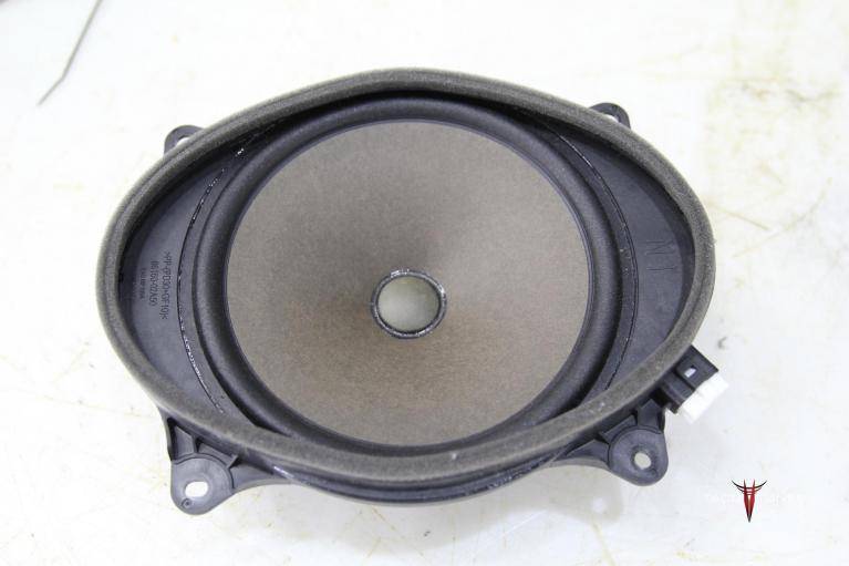

Anyways, anything has to be better than these sad excuse for 6x9s
