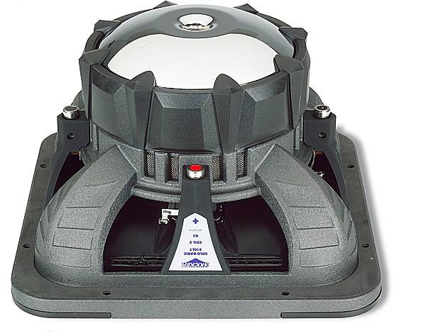

yea i was being sarcastic.................as far as the wire im not talking about the size ,,,im talking about how it hooks to the speaker......the speaker wire hook up on the sub looks like a rca cable hook up.........
What year-model L7 are we talking about? (it will be the first two numbers in the model number on the magnet)
They look like this?
If so you push the terminal down, shove the wire in the hole (found below the push terminal), then release the terminal and the resultant spring-loaded pressure will keep the wire secure.
