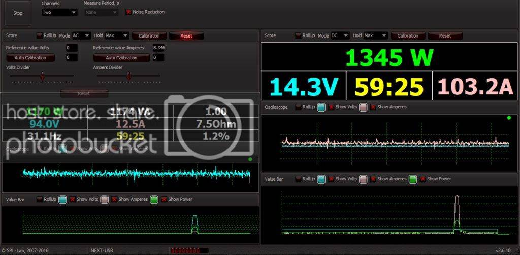

Here is sample of our testing-
In here, we set everything to max to get the maximum True RMS Wattage value but it also holds all other values to max too so we must look at the bottom on the Spectrum Graph to obtain the realtime values for this given test.
With this, we are able to provide the following per test-
VA
True RMS Wattage
Power Factor
AC Voltage
AC Amperage
Impedance
Frequency
Duration since start
THD %
DC Power
DC Voltage
DC Amperage
Efficiency (calculated)
Maximum values
Realtime values
Signal Quality Graph
Spectrum Graph for Volt, Amp and Power
In this test, this was done on a Taramp's DSP-3000 2ohm version.
Given here, we see-
94vAC
12.5aAC
1170w
DC- 1345w
DCa- 103.2A
DCv- 12.88v (14.3 was max before the drop. verified with spectrum graph below)
THD- 1.2%
Frequency- 31Hz
Impedance- 7.5ohm
Efficiency- 87.0%
Temperature- 81.8F (verified with probe)
Amplifier rating from buildhouse-
1142w
1KHz
THD- 5.3%
Impedance- 8ohm
Temperature- 78F
Voltage- 12.6vDC

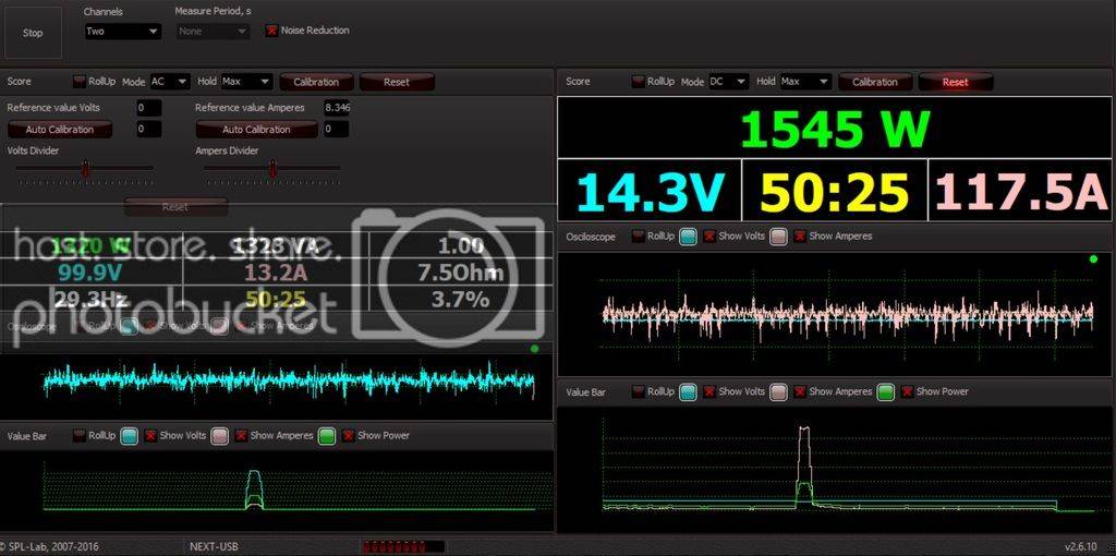

So, as you can see, testing shows it to be pretty close. 0.5ohm lower, 0.28v higher, but at 30hz also which is much harder than 1KHz and our signal was virtually clean. Let's add some distortion to the mix and show how Taramp's does over rated-
This is with 3.7% THD, still lower than 5.3%. Still 7.5ohm vs 8ohm rated. We are now at 13.0v vs 12.6v rated and our temperature is 78.1F, which is dead on with rated.
Now producing 1,320w of power which is almost 200w over rated and still not as distorted as rated.
We have similar results of other powerful amps tested at high impedance before we can test at lower impedance once our lithium cells get here.
