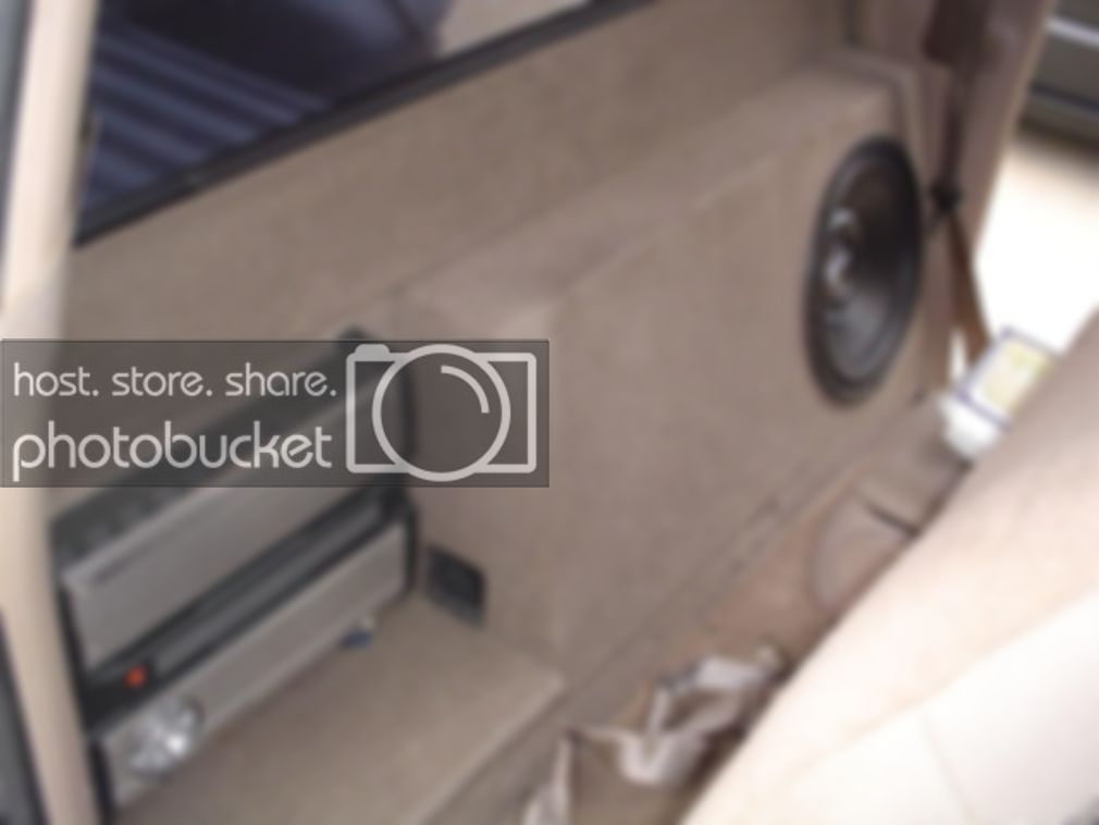

I do plan on ditching the rear speakers. Won't be any room in my single cab truck for anything in the back (see above pic).
