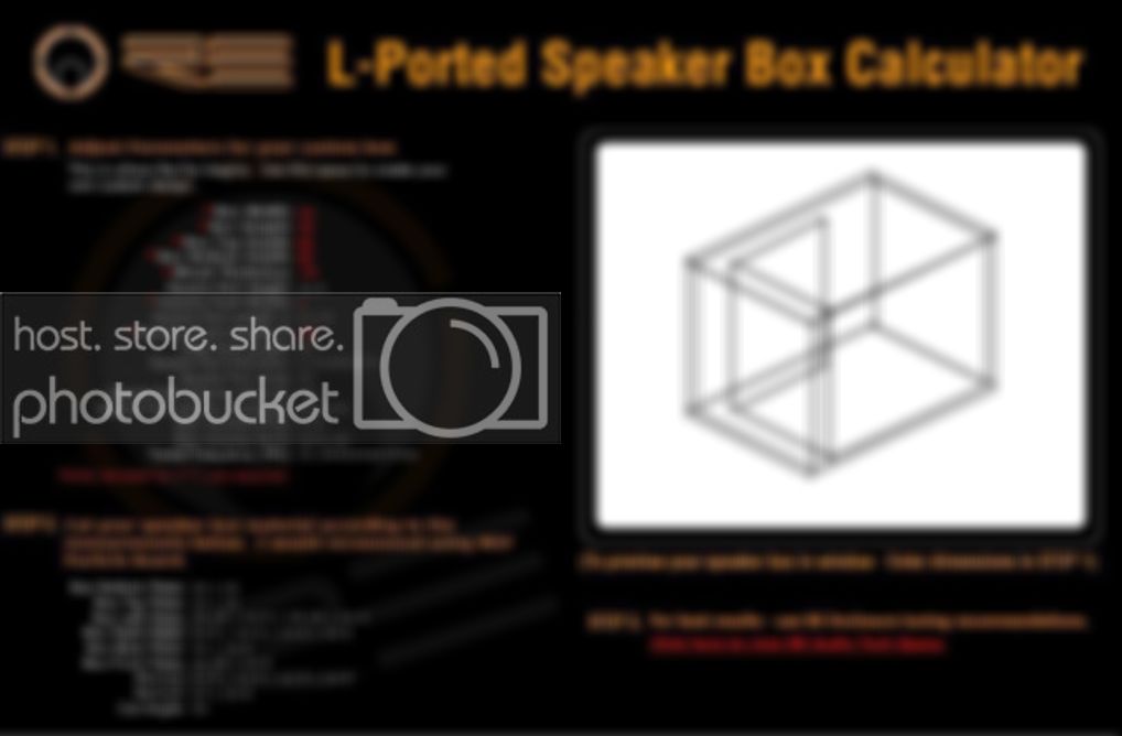

but I figure, slightly bigger box with an L port, two 8 *****, 450W RMS to each should keep me at the same SQ, but a tad louder.....
