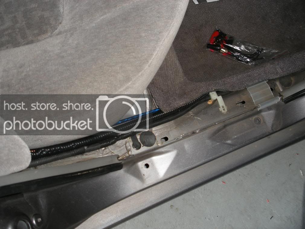

Here are some pictures of the setup, if you need anything specific, let me know and I will be more than happy to go to the car and take pictures:

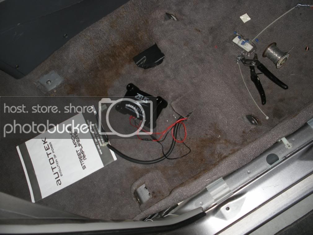

Crossovers put underneath seats.

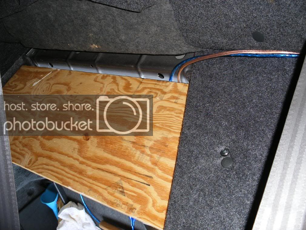

Wiring put underneath carpet along sides of car.
Wiring going up from back of rear seats to amplifier in trunk.

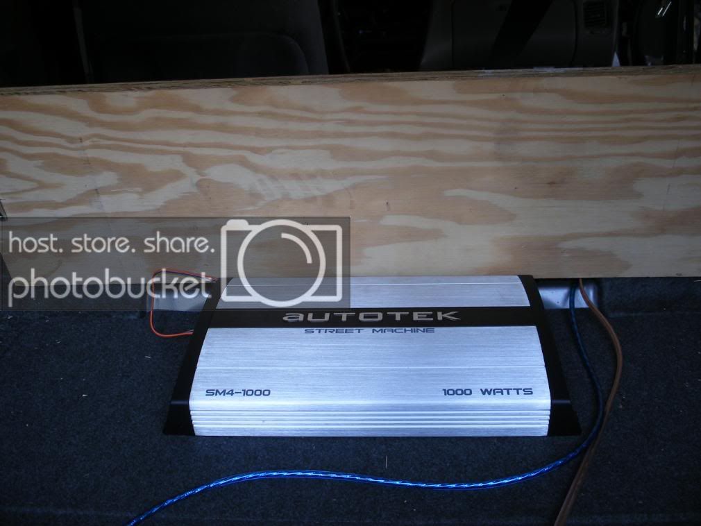

Amplifier in trunk (before mounting).

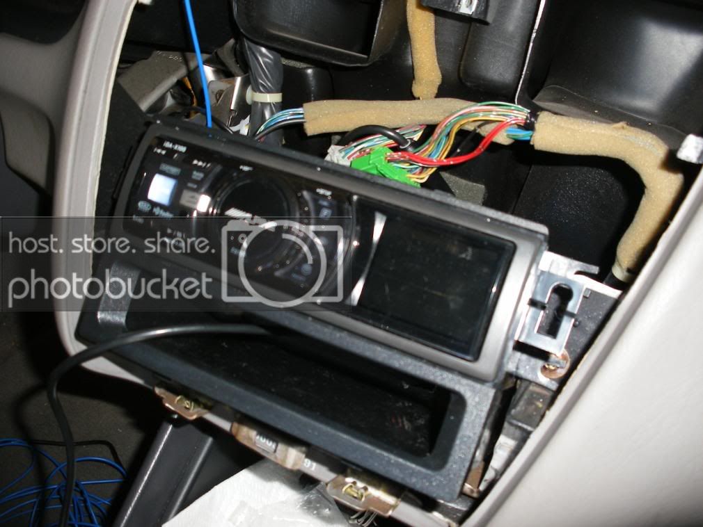

Alpine iDA-x100 Headunit

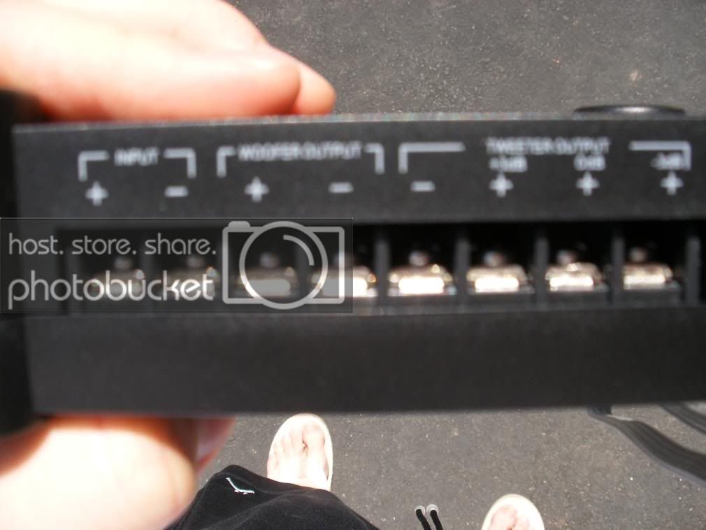

Crossovers.

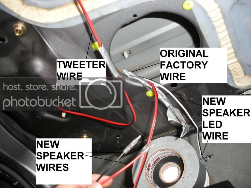

Wires used in front doors for speakers and tweeters.

The duct tape is just holding the original factory wires together, keeping them away from my new mids.
Thus, answering your question: I am NOT using the original factory wires (if that is what you mean connected to kick).
