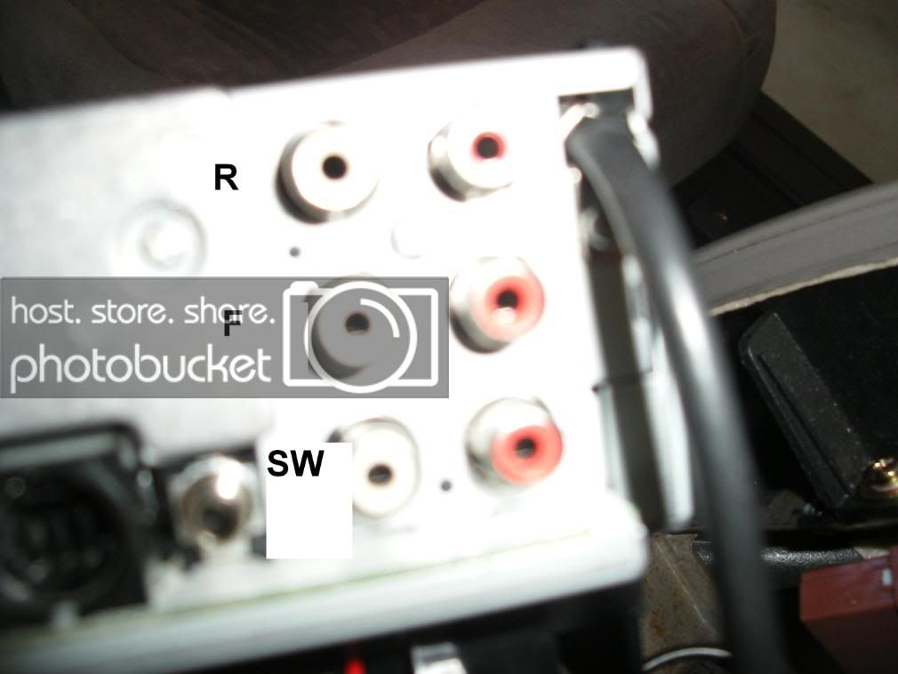

The rear of my headunit: showing RCA input slots.

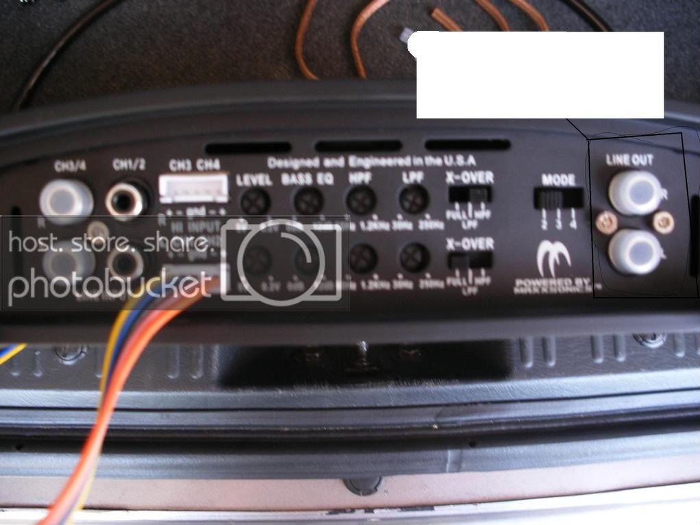

My Amplifier's RCA input/output side.

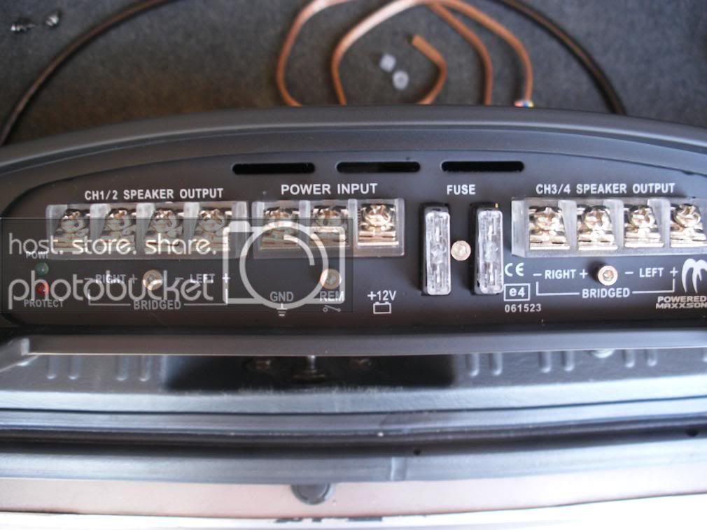

My Amplifier's power/ground/remote/speaker terminal side.

you do have two sets of rca's right? Coming off of the F "F" and "R" on your headunit. You need to plug the front rca into channel 1/2, and youre rear rca into channel 3/4 Then run your front speakers off of channel 1/2 output. and your rear speakers off of channel 3/5 output. Left with left, and right with right.

I've never used that thing you have in channels 1&2. I always ran rcas from the back to the inputs on the amp. Buy yourself 2 sets and try that. If you have everything grounded properly, I'm sure you will get sound from all the speakers.
x2. Pull out the hi-level harness and see if that works.

The way you have it, nothing is in 3/4, and you have the amp set for 2 channel. Switch that one that says 2/3/4 to 4. You don't have to worry about the outs on the amp that you squared off.

3) * Grounding you jacks - Splice 2 pieces of speaker wire, wrap them around the HUs RCA outputs - 1 piece of wire for each L ; 1 piece of wire for R ( Front - since you're using the front ), Splice the other end of each wire and ground them to the rear of your CD player ( Inbetween a tight groove... or a screw that can be loosen on the HU )
4) make sure you ran wires from your Amp to each speaker... * You can't use the factor wire & expect them to play through the amp. *
5) Make sure each all positives and negatives are together... * You might have crossed them some where *
6) Make sure no bare wire or connectors are touching metal inside of your doors.
... That's really all that I can say see without being there. Hopefully that helps. If not, I wish I was closer...

Do I need another RCA cable to connect the R slot on my HU to the 3/4 channel on my amplifier? I have been told that the R slot was for rear speakers, and since I am not using aftermarket rear deck speakers, I don't need it?

1) Make sure you are connecting the speaker wires to the correct side.
* Example:
You put the RCAs in the 1/2 INPUT, but you are connecting the speaker wires in 3/4.
* NOTE! - The Front and Rear is just for the FADE to work PROPERLY! You don't need anymore RCAs. *
And grounding the RCAs is as COMMON as the BIG 3.
2) When you hear " Gains " ...
... That's the volume control on your AMP.
Make sure it's all the way to the right ( Clockwise ) * Might have to use a phillip or flathead *
