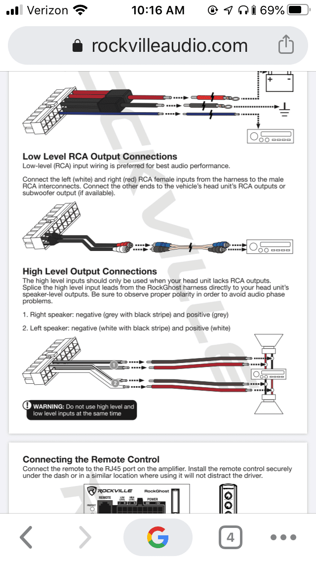

Thanks for the reply! It's only low level for the RCA inputs. It has at separate high level inputs. I'm just trying to figure out which high level outputs to use (factory HU out or mini amp). Here's the section of the subwoofer manual about that:

Yeah but you need a flat de equalized signal which your high level inputs will likely not provide and may even include bass limiting (to protect weak factory speakers). Specific to bass, Your strategy would be better if you had factory subs because you would have high level sub channels. I’d switch that amp to an amp with an extra rca out (like that pioneer)

the speaker high inputs are not subwoofer inputs they are for full range door speakers. They are equalized by the factory headunit. You won’t be able to correct that on the sub if you use those high level inputs for your sub. They’re probably fine for your aftermarket speakers (might sound meh at high volumes)
