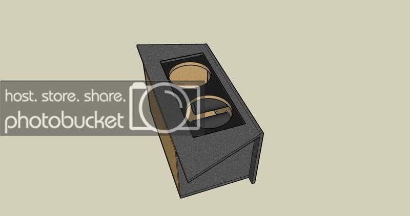

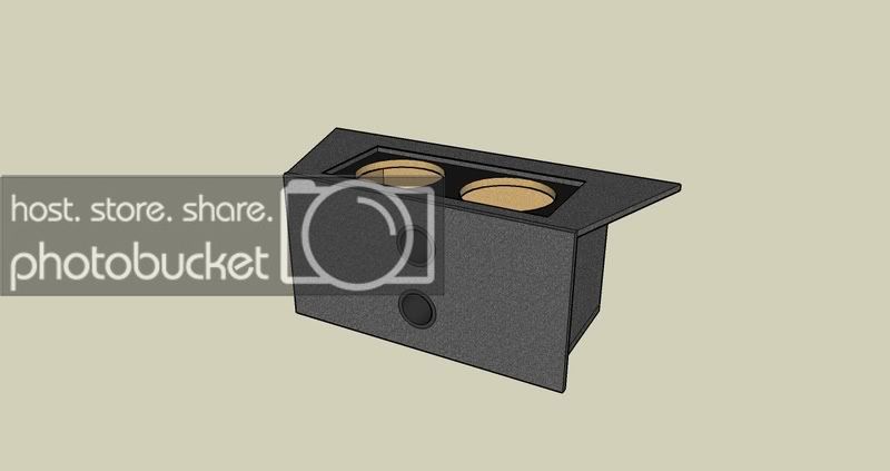

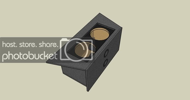

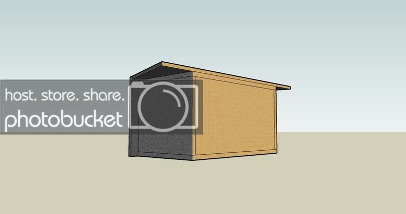

Ok guys im gettin tired of my box i am using right now and am brainstorming and sketching out a new box. It will hold two alpine type r twelves. I will have 5cuft gross volume and will be using 2 4" aero ports for tuning. The box will have two sets of aero ports, one set will be 3" long T 47hz for SPL and the other will 10" long at 32hz for daily driving. It will be going in the back of a 98 dodge ram ext cab (the rear seat is removed)
Here is my desgin in google sketchup. The alpine mrp m-1000 and mrp-f300 will be screwed in on each side of the box with a neon tubes on each side on the backside of the face overhang.
They will be going in this
Let me know what ya think

Speakers up. and i will be fiberglassing panels around the box in the future, probably some backlit plexi too. I also use this as a daily driver and i do go 4x4ing with so i want SOME room back there for luggage
yes for spl i compete. I had my 2 12" revo's doing a 144.6 on 37 hz with about 2k rms. Sounds amazing on music too
hmm well that might be next times plans. I have already started cutting out the enclosure above
