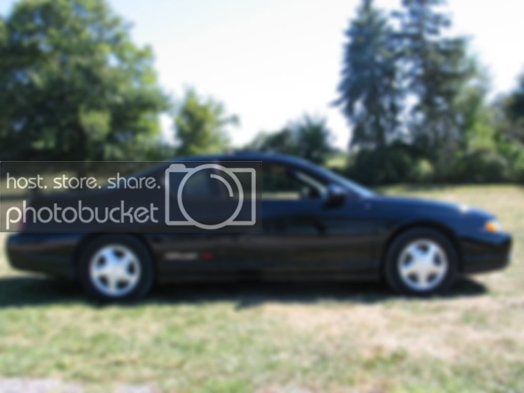

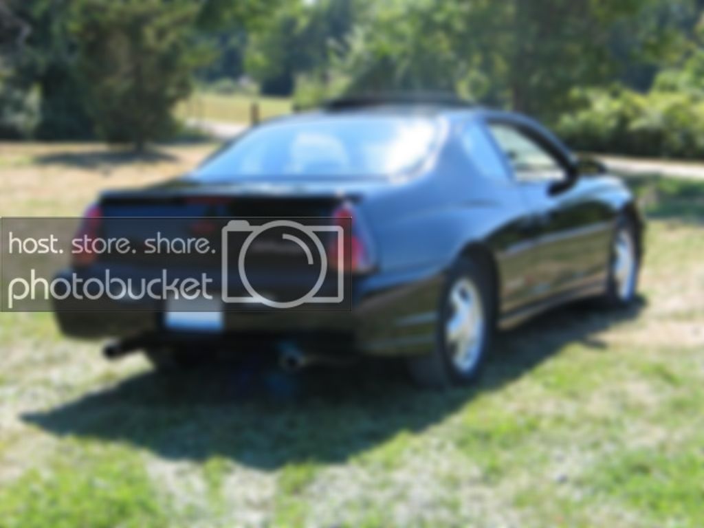

pics of the car
Yea, I'm sure I could do better than kicker, but its really hard for me to pass the prices up I can get them for. I was thinking a 3.5 cu.ft box, and from what I've calculated, I would need a 6"dia x 14.5" long round port to make it 34hz? Does this sound right? If I do it I plan on using aeroports...
Here's a few pics of my car when it wasn't cold as hell out here. //content.invisioncic.com/y282845/emoticons/wink.gif.608e3ea05f1a9f98611af0861652f8fb.gif
