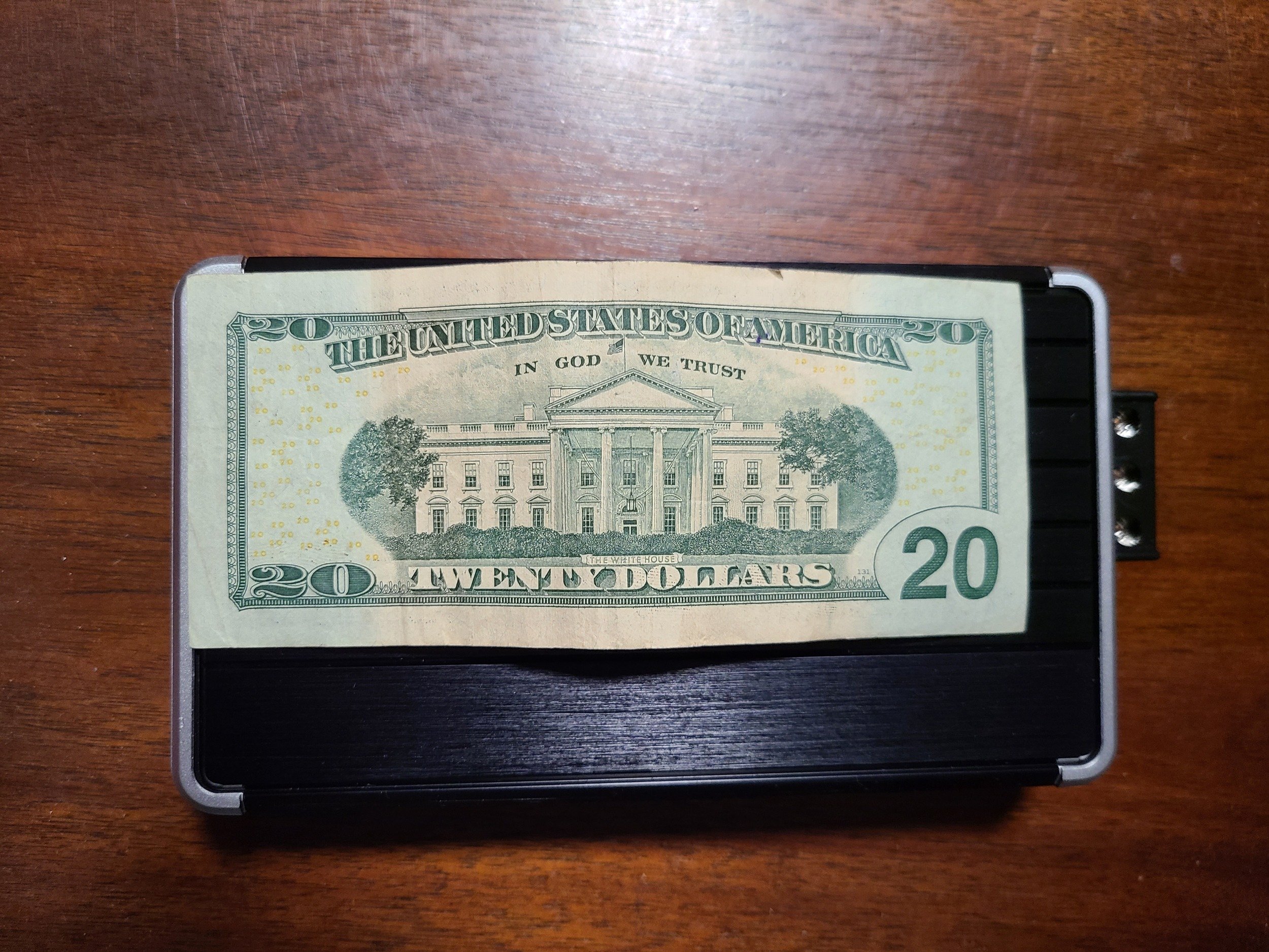

There are some really small powerful amps out there. This is a cerwin vega b52 amp. It is less than 1.5" in height, and this is a 150w x 2 @ 4ohms RMS, or 500w x 1 @ 4 ohms RMS. This thing will hide in or behind a glove box, under a panel, under a seat, etc.... You could fit 3 of these in that space you mentioned, and could probably fit 6 of em if you stacked em.

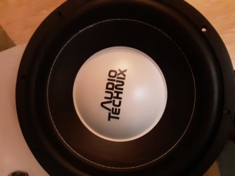

CT Sounds used to be Audio Technix. They have come around past couple of years from some bad ownership of which that individual has passed away and new ownership has taken place and new inhouse tactics. I run the 150.4, and one of 2 2ks atm and have been excellent with no issues thus far.Shipping was excellent.Product looks great and all perform very well for the $ from my experiences. Customer service is excellent thus far for me. Kurt will usually email you back within 24 hrs even after hours at times and answers all your questions and is quit knowledgeable as well. My first shipment was delayed due to the carrier for approx 3 days out, and to make peace with my first purchase and keeping me happy , they sent me a set of 6.5 Bio Mids for the delay.After that, all my shipments have been excellent no issues. For my temp set up until I finish out a Wall set up. I am running the CT Sounds 150.4 on a set of Polk DB 6.5 Coax, and a set of hertz 165k and a set of CDTDRT25 tweets, and a pair of Sound Qubed HDS310s in 4.0@32 HTZ on the CT Sounds 2k, and will be adding my CT Sounds EQ soon (When I get off my azz and install it) with my Alpine CDA9835 with a Kicker KQ9 EQ atm. Sounds fine and does fine for me at the moment. I used to a much larger system.
I still have an older 12" that still performs very nice when I run it in a ported enclosure on approx 5-600 rms clean.
