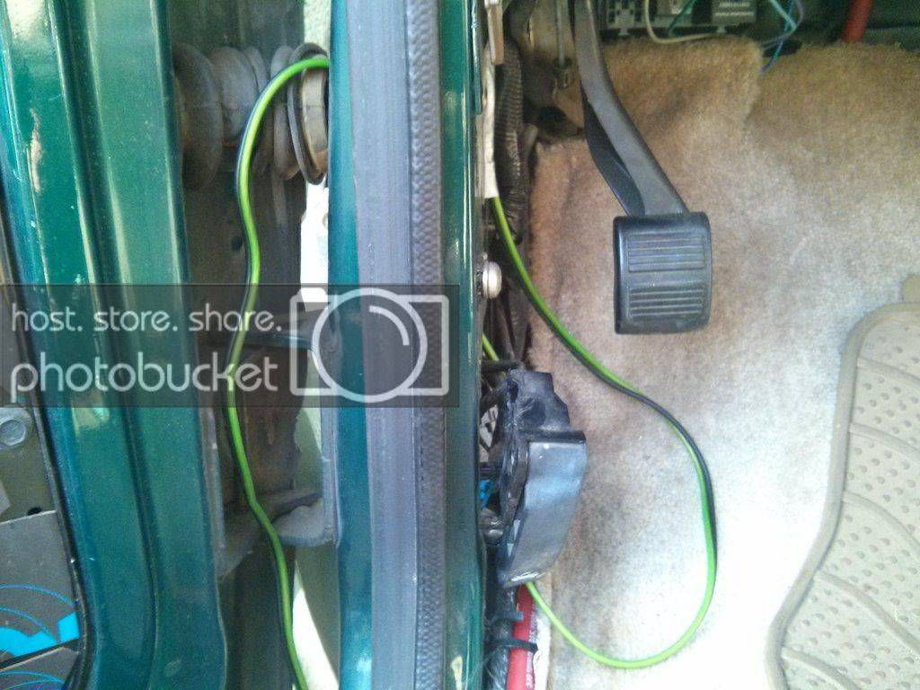

Pretty much what I said earlier so yes. In fact, I did the same thing recently. I got new comps installed and all I really had to do is switch wires around and add a little bit to existing wire. It's easy. It's the routing part that's time consuming....and yes, I'm well aware of the door hinge rubber boot that your talking about. That's where I routed 1 piece of spkr wire for the amp, for each door. If you go that route, make sure you zip tie things. Last thing you want is to roll down the window and find out that it tipped your speaker wire right out and no sound. I simply zip tied it with the factory wiring...easiest thing I can pass along to another person.
