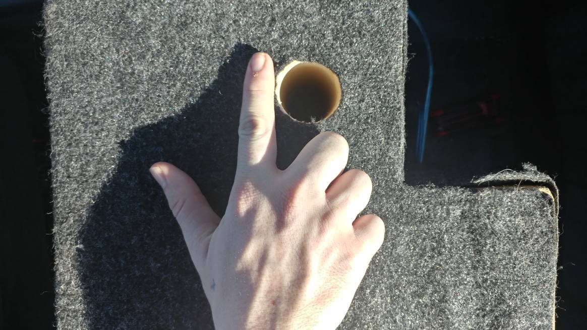

Hey sorry guys I've had my son today and it was a busy day! I took pictures if the sub enclosure I'm just still trying to figure out the file hosting garbage. Just for sh*ts and giggles though I faded out the rear speakers driving around today and can say that although I don't think it sounded better I also don't think it sounded any worse since the sub was in a way providing enough fill on its own. I want to get a new deck although if I upgrade I would really like to get a really nice kenwood or something flip out since my car can only handle a single din. The problem is I won't have $ to buy a HU like that till I get paid next week so I think I'm going to try connecting the 4ch with the high level inputs. Thanks your all your advice guys. I will post pics soon.
