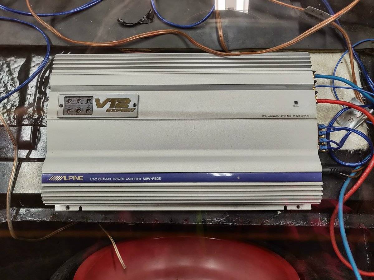

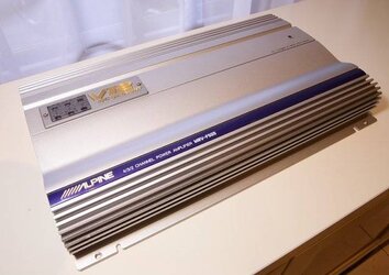

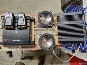

So over theast year and a half between chasing parts for my e34 540i bimmer, I ended up acquiring some interesting car audio stuff.  I installed a pioneer deh x9500bhs head unit, and have begun installing speakers in the doors.   I have some older Alpine spring 136a type r 5.25" woofers (silver with red r)weeter, and passive crossovers, but no tweeters.  For the amps, I have an Alpine v12 mrv f505 4 channel (100w rms per channel at 4ohm), an Alpine mrx f30 4 channel (50w rms per channel at 4ohm), and an Alpine 3542 2 channel (75w per channel at 4ohm).

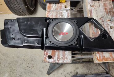

So my plan is, sound deaden the door, mount up the type r woofers in the door, block off the 3" mid.  For the rest of the speakers, I was going to run the stock tweeter in the door, or replace with the Alpine eBay ones I see people here using, and just run the type r crossover.  For the rears, I was going to replace the stock 6.5 and tweet with a passive component set, but I have no idea what to get, I want to budget about $200 for speakers, total.

Doors, type r 5.25 woofer and crossover,  need tweeter.  What to get?

Use the Alpine mrv f505 for the front four channels.
Sub jl 8 slim box until a bigger better mounting solution is figured out, and power with the Alpine 3542.
Good plan?  What speakers to get?

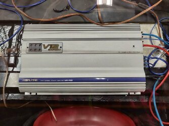

Car in question, and pics of gear...

yes, if youre wanting to run all 4 corners, youre gonna need fl, fr rl and rr outputs to amplify. If youre gonna run active for all 4 corners, youll need a DSP. If you want to run passive, then what you have is just fine and itll sound good esp with a big amp like that. To your next point, you dont need huge amps to get decent power. Zapco makes a decent SQ oriented 4 channel for around $200 that will do 80 or so wpc RMS. To the point about the diamond audio HEX S600s's, the guy selling them for a hundo is basically giving them away and they are VERY HIGHLY regarded for sq as far as comp sets with passive x-overs go. They are pretty bright, but thats how Diamonds sound. At least they arent the S600a's (aluminum tweeters vs the S600s's silk dome). If you arent interested in the diamonds, ill buy them for a hundo and pay you shipping for em. Theyre exceptional in my opinion
