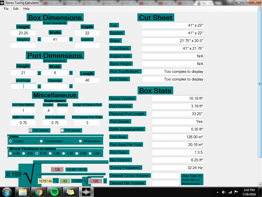

So I am designing a new box for my two DSS ethos 15s and just wondering if what I have will work
W:41in
D: 22in
h:23.25
Port
H:21in
w:6in
L: 40in
Does this sound alright ?? Am I crazy?? Will probably be bracing with threaded rod. Building material will be 3/4in mdf double baffle on top. Subs up port back toward hatch and will be on a vfl 175.1 at .5

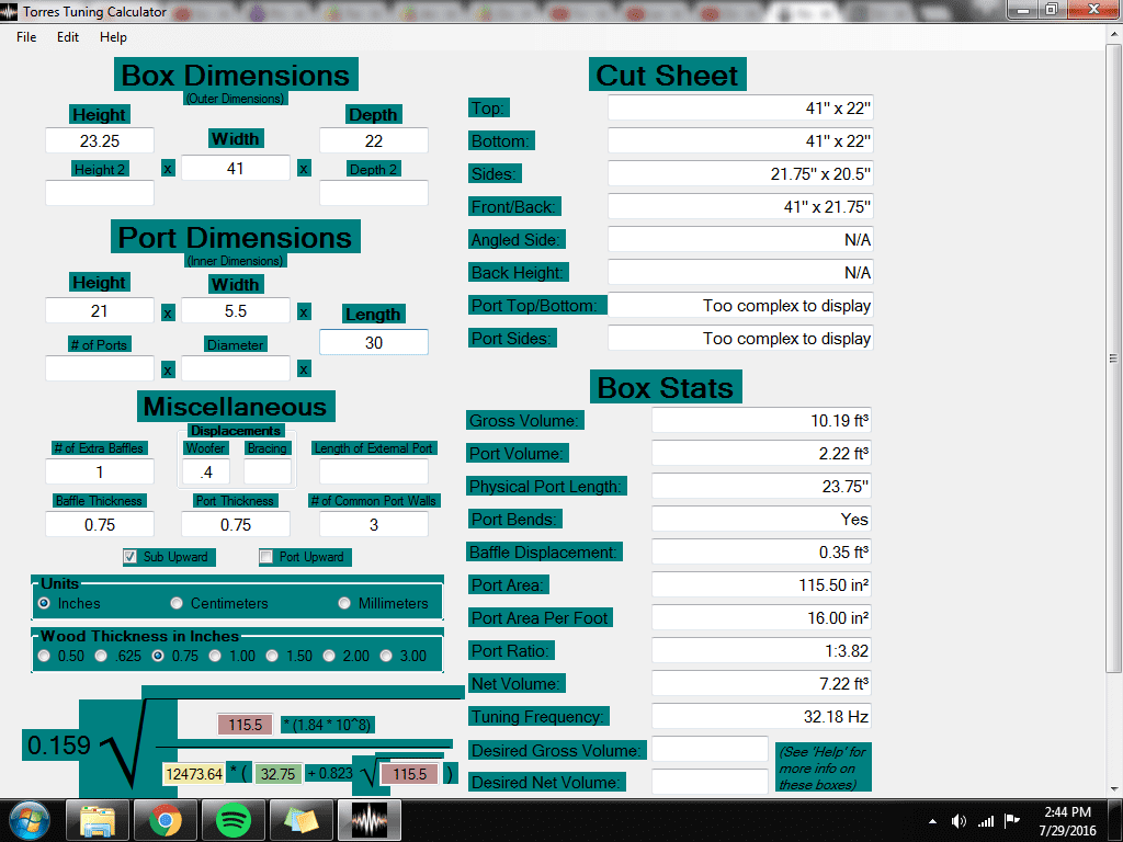

Here's your old one.
Now here's the newer one that I suggested.
actually after displacement, he barely has any airspace left.

You can do 28hz if you want more lows. Im just showing you possibilities, you can do whatever design you want, just download torres box calc.
