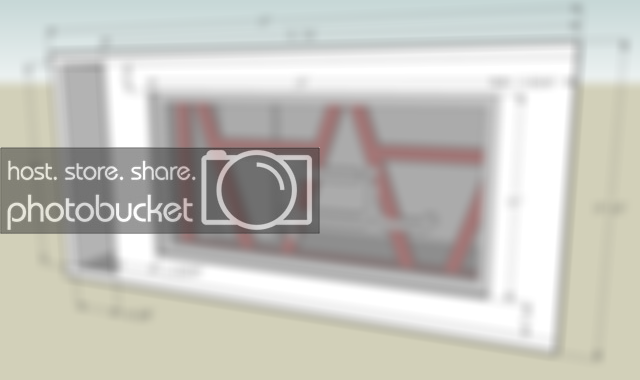

New box for my box
If I wasnt looking out for the guy I wouldnt have said anything about the port being too small and trying to run ported and sealed together. Im not on here to put people down but to help in what areas I know about(which happens to be box designs).
I would say, block the port off and make it all a common chamber and leave it sealed or make one big port.

Im gonna second some points mentioned before:
1.Box quality should never be sacraficed for looks.
2.Great sounding boxes can look good to.
3.Mixing speakers( or amps) will cause cancelation issues, no matter what you say.
4. Dont fill this forum with bs, do your research, then ask questions and opinions.
5. We gave our honest opinions so dont b*itch.
All aside, i dont blame the guy representing the shop but please, have some knowledge in your field. The boxes dont look to bad but the designs are crap imo. The customer gets what he wants... usually the customer wants to be louder then the other guy.

he shouldnt have a business if he doesnt know whats hes doing..doing a half sealed half ported box is not good..he should learn the basics before he opens up a business and throws suggestions at people on how to build a proper enclosure.
In all due respect WE gave him the idea to do a port and dual sealed. WE asked him if he would like have a box like that. Professional shop - YES - we're still in business, have good rep, and have a long list of satisfied clients to back it up. Not to mention the several cars that were FULLY sponsored by MFG. that a featured in some magazines. Yes, local shop - Anaheim, CA. - 714-533-3042 is the number! Call us up? Sure, we're professional as professional can get in this business and do take into consideration all the needs each client has according to their type of music and sound they would like. And as being professional we would only take into consideration of those who have had plenty of experience in the "car audio" department and seems like you do - aside from the youngsters on here trying to bash Steve for getting his system. Let alone, BASH us for doing it the way we are. Seems like that's what most of the members on these forum are doing is just either bashing someone for not knowing very little and trying to learn AND/OR competing with them because they have an inflated ego because they seem to have pride in what they know?! Am I right or wrong?

Let me ask this simple question, why does this customer, and his system, need or want a sealed AND ported enclosure? Can you give one factual reason why this setup would be advantageous over an all sealed, or all ported application? Just one. And no, looks or 'becaue the customer wanted it' is not a valid reason.
Subwoofers require a relatively narrow passband of frequencies they are responsible for, there is no reason you shouldn't be able to design and build a simple system utilizing either sealed, or ported systems, that will play flat (or peaky) within the frequency range rrequired. Suggesting both is necessary, advantageous, or even acceptable, shows a lack of design knowledge. Im sorry, but it does.
You are a professional shop. The customer in question admits he is a noob and wants to learn. Therefore, he should be GETTING advice from you, not dictating to you how the enclosure design will go. I highly doubt this guy insisted on this setup while you tried to persuade him otherwise... your attitude here, and his, suggest otherwise.
So this leaves me wondering how did this noob customer, and this professional shop, come up with a design that incorporates sealed AND ported subwoofers. Honestly, it boggles my mind.
Did the customer want a relatively flat response for good 'SQ' form the system? Then why not run all speakers sealed? Did the customer want a 'loud' system that involves building an enclosure with a peaky response? Then why not all ported tuned high? Did the customer want something in between? Then why not all ported tuned low? Was it because all you seem to know about actual enclosure design is calling the mfg and see what they recommend? not a flame, an honest question.

So now its not on you, but your fabricator? Do you not have the knowledge enough to see a bad design? Of course the fabricator will think it sounds good and perform as he expected, HE designed it. Who is to say different? You, the boss who doesn't know enough to step in in the first place? The customer? Who admits he knows squat? The sad truth is that box will be built, the fabricator will love it, hence you and your client will too. Not realizing how much better it COULD have been. In your mind, satisfied customer. In our mind, a half-assed job that sooner or later the customer will come to regret.
Your fabricator cannot substantiate a good reason for that box any more than you can.
Wow, I said no more opinions but I have to step in on this one. To pass off the blame on your fabricator is completely bull. If you had any idea of how an enclosure should be you would not allow this crap to be placed in a customer's vehicle. Your reasoning for why this was done is just outright retarded. If I owned a shop I would make **** sure my fabricator knew what the fVck he was doing(which you obviously havent done).
If you are in the Audio industry as an installer, you better make sure you cover all aspects of the field. Not your lame excuse that you do clean installs of radios and what not and just dont concentrate on the enclosures. That is completely unacceptable business ethics. If I were getting my car worked on, would I want a clean paint job but a half *** job on the motor? HELLLL NO.
Your logic is flawed and your excuses are weak. Please go learn a thing or two about audio then try again.(and Im still waiting on an answer to how many square inches of port per cubic foot, which im pretty much convinced you have no clue).
