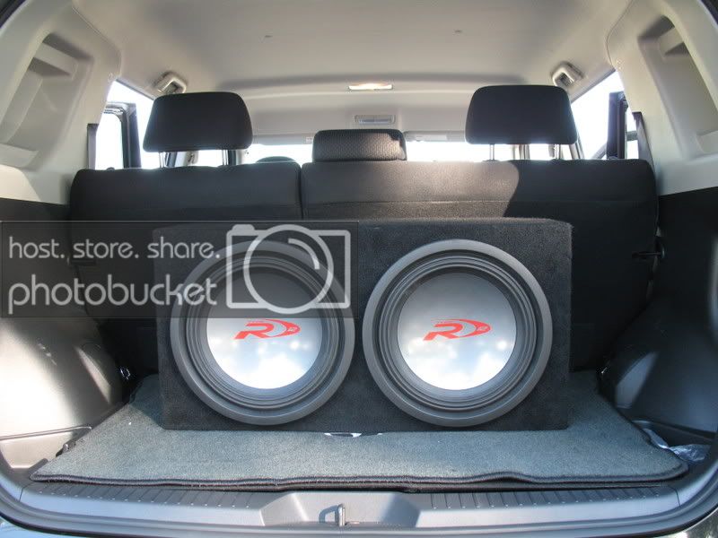

the previous set up... ****ing pre-fabbed boxes..

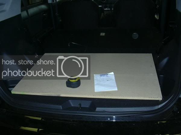

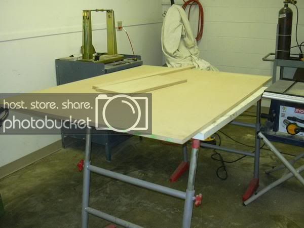

checking out size

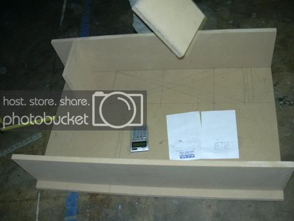

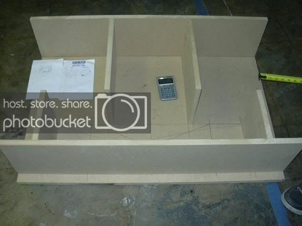

here's a little progress. Starting to lay things out

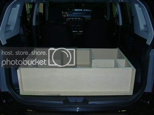

here's the box in the back of my car

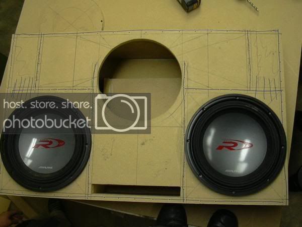

we wanted to try something a little different since i have 3 amps we made 2 of the subs sealed and one ported...

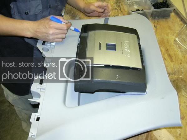

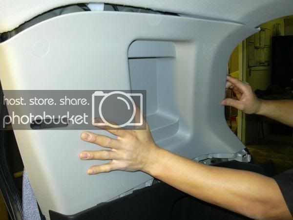

two of the amps will go here
one on each side... the other one doesn't match.. it's kinda ugly so we are putting it under the box in the little compartment under the floor

holy tiny port, batman.
wait, wait...
2 sealed, one ported?
ouch.
I dunno... seems to me like you get a different extension and sound from a sealed vs. ported enclosure, running one of each, or two in this case might fill a small void others may find with just one type of the other.
But I'm a noobie so I'm just pondering lol
why not just make a big enough box for all 3 type r's and port that box? that would clearly be better then 2 sealed and 1 ported. Ive never heard of that..
your better off making them all sealed in one big box or port all of them.. the way you have it setup will cause a lot of cancellation issues. 42hz is way high for daily also. im not sure what type-arrs liek to be tuned to but ima go on a limb and say 32 hz???
