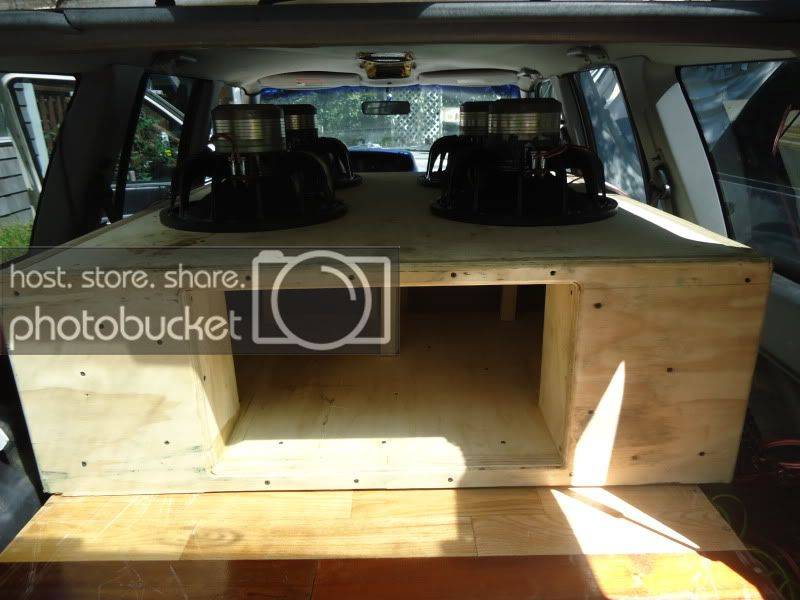

This was the loudest non--wall box I've ever had in a Jeep. Similar arrangements of sub up and port into that passenger side corner seemed optimum.
This here was my favorite sounding to date, subs and port up. Similar arrangements with subs up and port up (on the driver's side) all worked quite well.
DSC02884.jpg'%20alt='DSC02884.jpg'>
Something like this with port to the side is about as good as anything. If you're metering experiment with pointing the port into the corner, otherwise sub up port to the side/corner has always worked out well in Jeeps for me.
