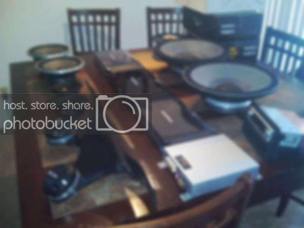

Okay, an update and a little more detail on the install. The equipment list is as follows:
P9 combo
JBL 2226G (x2)
JBL 2118H
JBL 500GTi
B&C DE500/Illusion lenses
RF T1500-1bd (x1)
RF T400-4 (x2)
The 2226 will cover from 30-100hz. 2118 from 100-250hz. 500GTi from 250-1.5khz, and the horns from 1.5khz up. The GTi are in some mildly customized Q-forms somewhat on axis, with the 2118 IB in the doors and the horns... where they go. //content.invisioncic.com/y282845/emoticons/wink.gif.608e3ea05f1a9f98611af0861652f8fb.gif 2118 get a 400-4 bridged and the horns/500GTi will run off the other 400-4. Slightly modified my amp rack from a previous install. It turned out to fit pretty good. The goal was to get all of this gear in a single cab S-10:

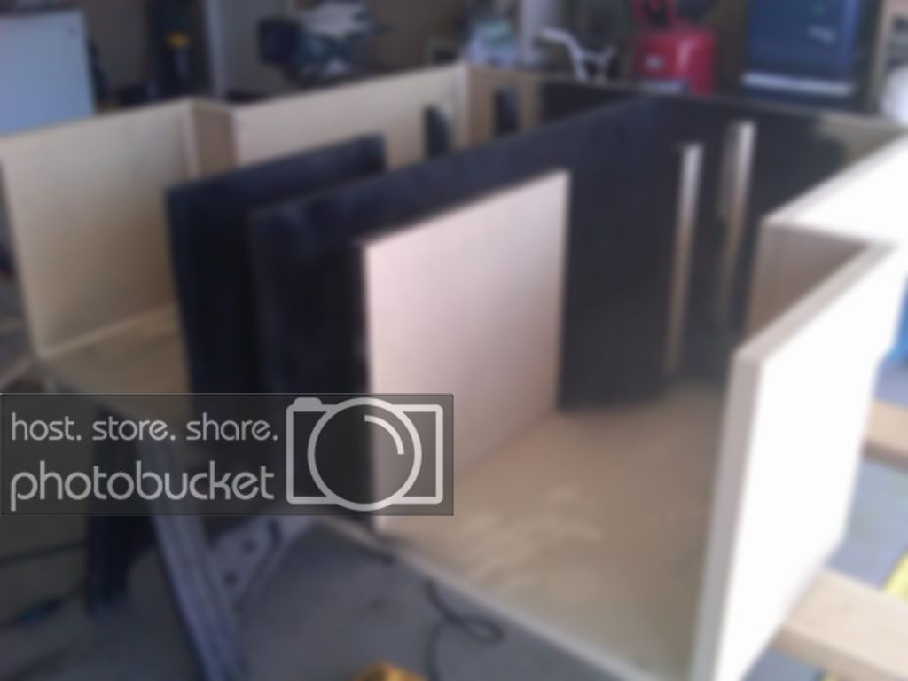

During the enclosure build:

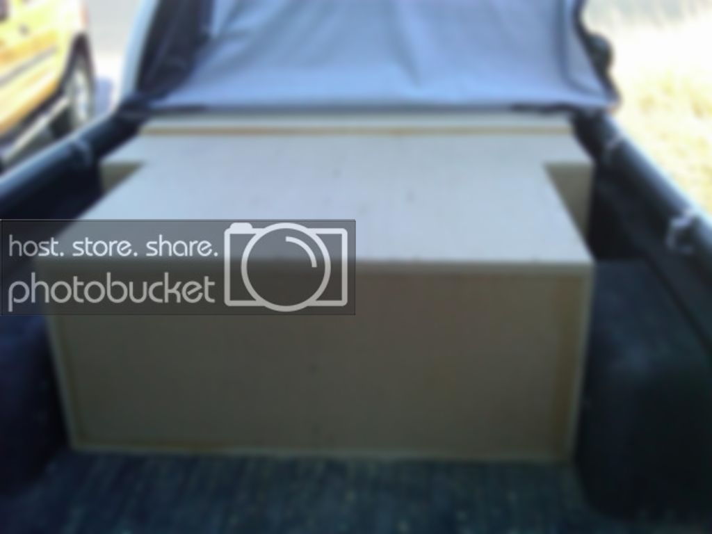

Installed in the bed:

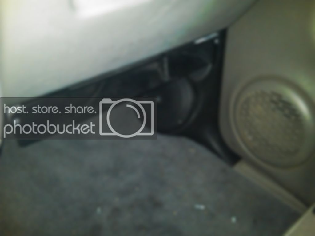

From the cab:

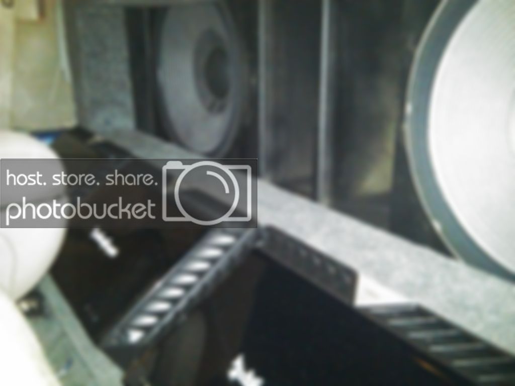

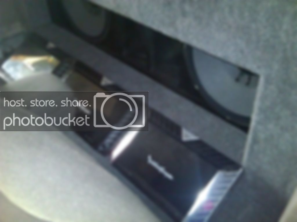

And a few pics of the amp rack. The port walls appear to not be painted in the pics, but they were taken at night and that is from the flash:
A shot of the passenger side:
I am borrowing a local friends' Illusion lenses while I track down a pair (Thanks Dave.) I ordered the Q Forms in gray to match my interior, but with the black lenses and the GTi being all black, I painted the pods to match. I think it gives a nice contrast against the interior and blends well with the horns.
The P9 processor is tucked away under the amp rack. I still have some wire cleanup to do and will probably end up re-routing most of them so they are hidden out of the way.
