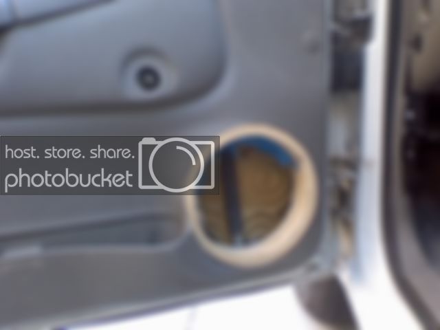

Here is the hole cut in the panels to get the 8" drivers to fit:

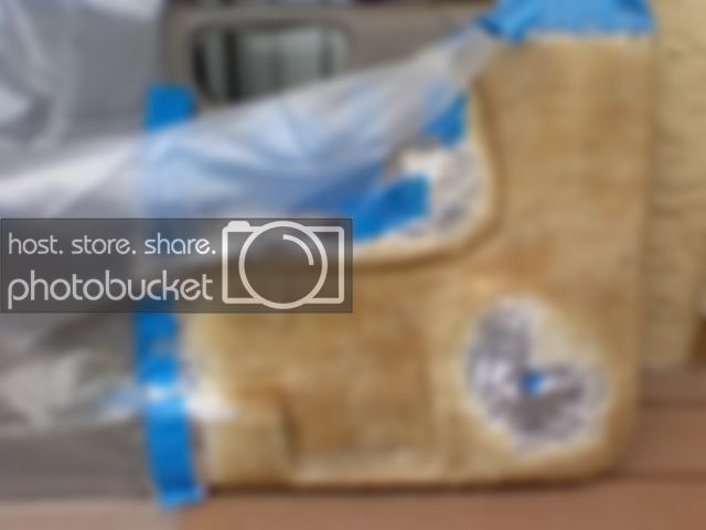

The idea was/is to mold a piece, then raise out a ring around where the mids reside, and have grills that I made from MDF rings/grill cloth pressure fit inside the holes. Here are pics so far:

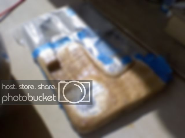

Prep work:
First few layers of glass:

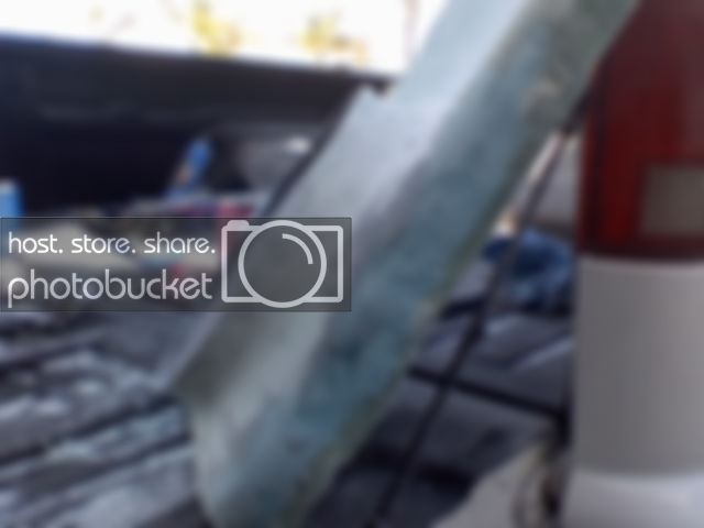

Mold removed from door panel:

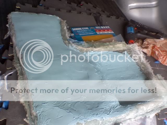

A bit of Evercoat Rage filler applied:

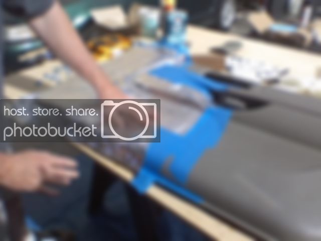

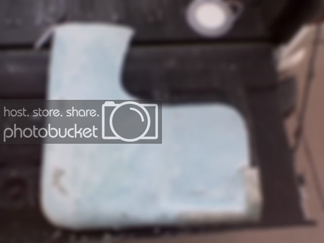

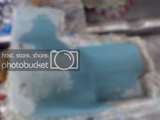

Second layer:

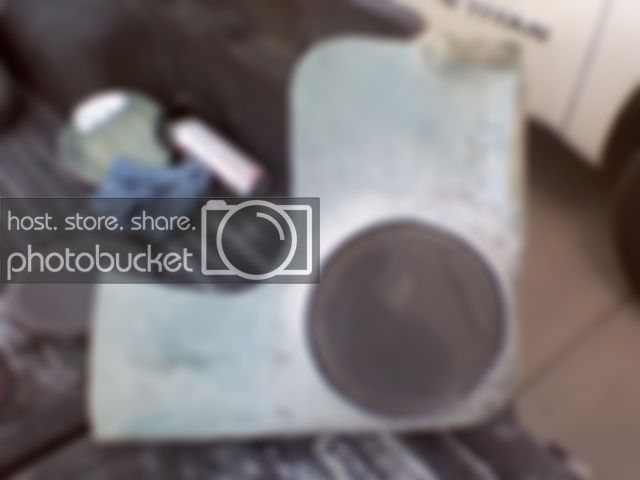

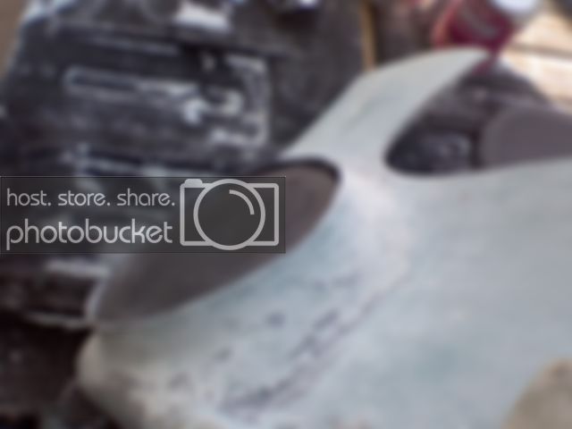

Some more Rage and sanding:

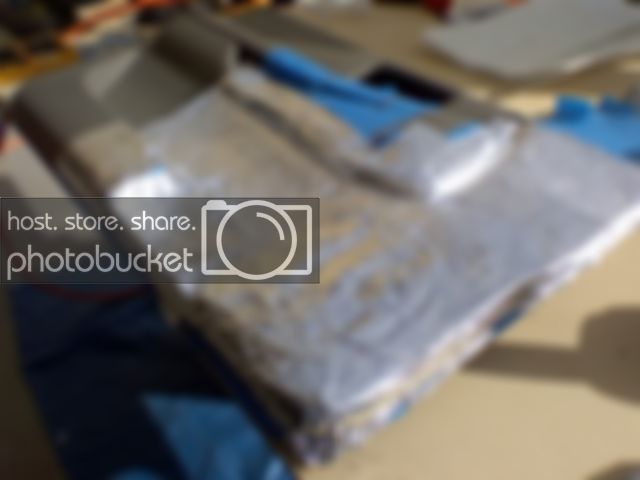

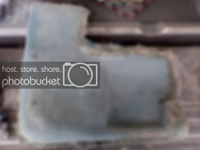

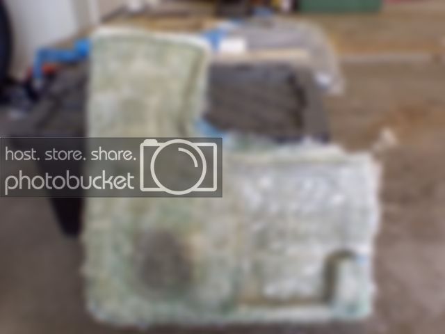

Now that the piece is starting to take shape and gain strength, the edges and excess are trimmed off:

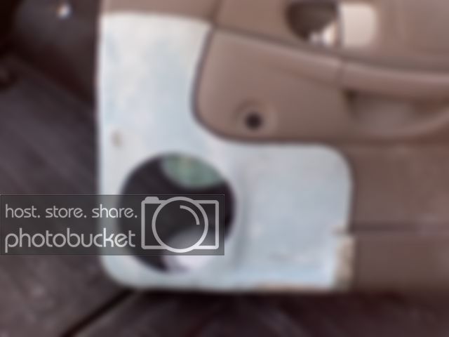

Test fit over door panel with hole cut for mid:

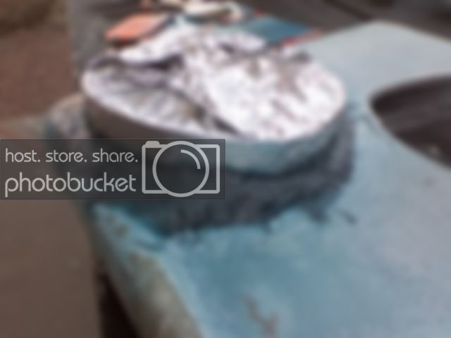

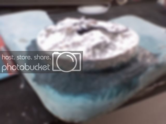

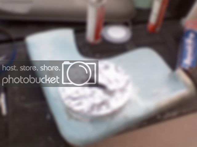

Here, I wrapped the MDF ring/grill with cardboard, then wrapped that with tinfoil and sprayed it with Pam, then taped in in place from the back and started building up the area with Kitty Hair:
Here is the molded area, partially sanded with the grill sitting inside the ring:
There is a lot more prep/sanding to do before they get wrapped, but I am happy with the way they've turned out so far, especially considering I've never done glass before. //content.invisioncic.com/y282845/emoticons/biggrin.gif.d71a5d36fcbab170f2364c9f2e3946cb.gif
