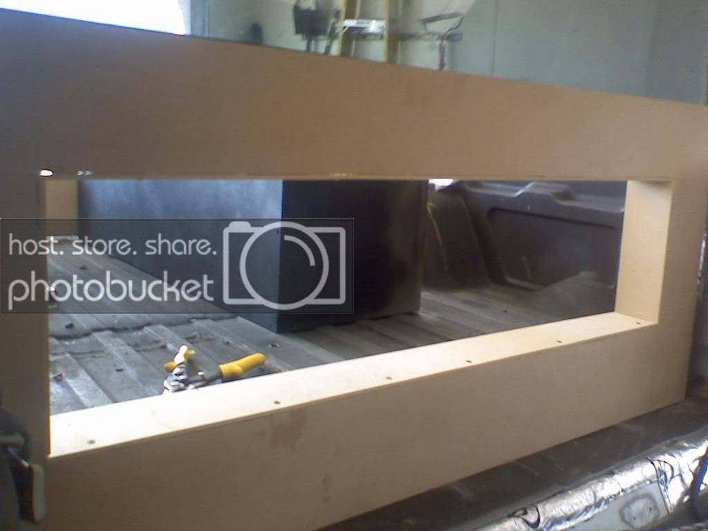

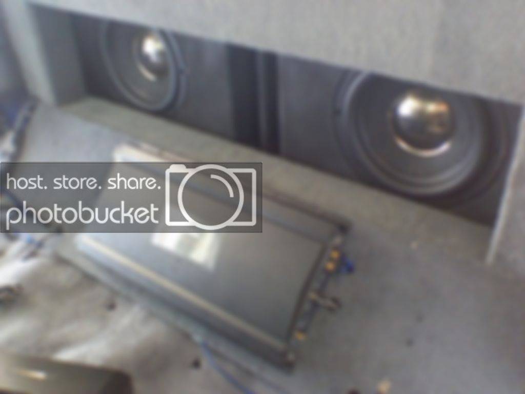

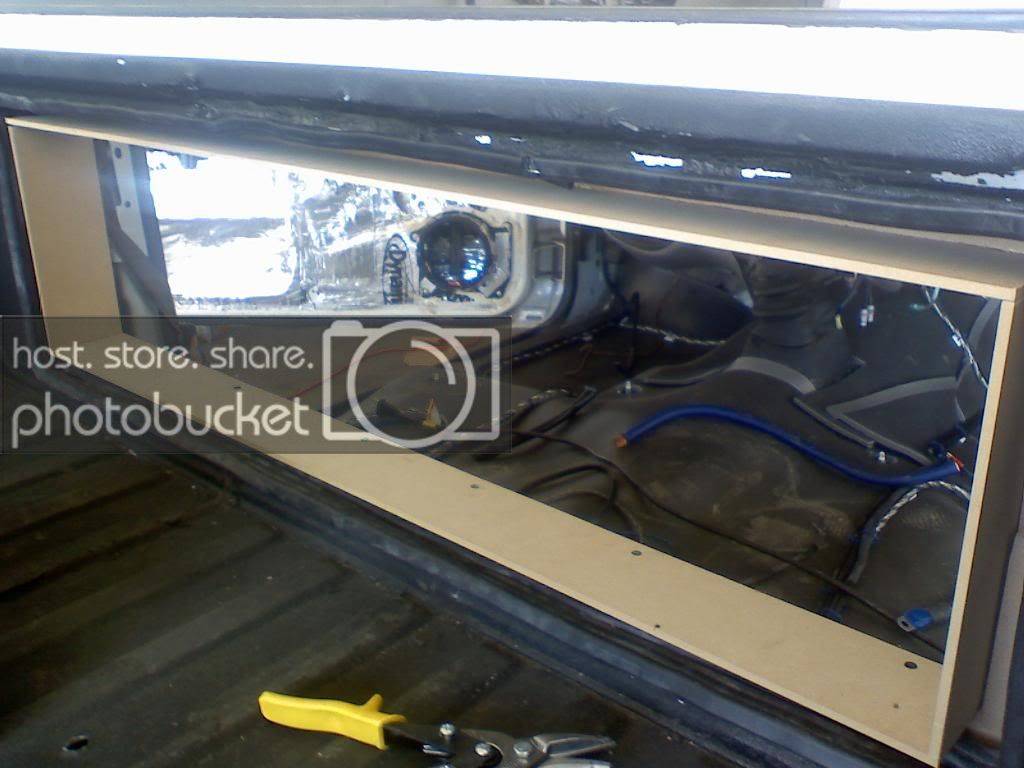

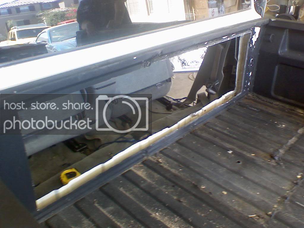

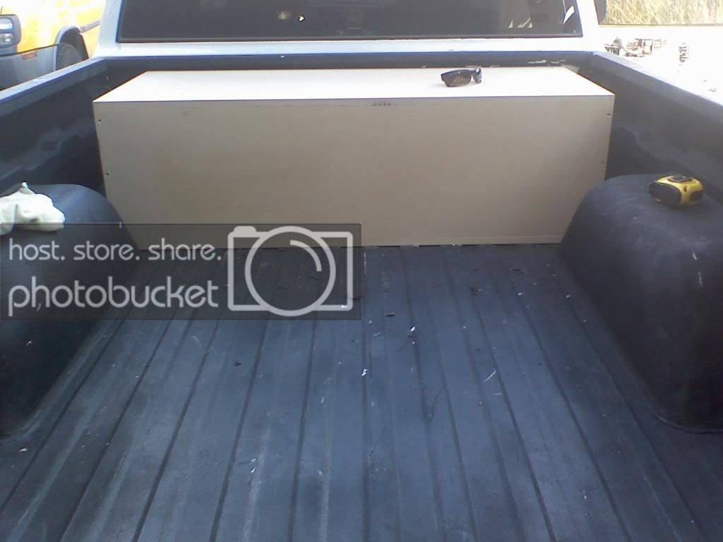

Cut the hole across the bed, extending it from the previous install:

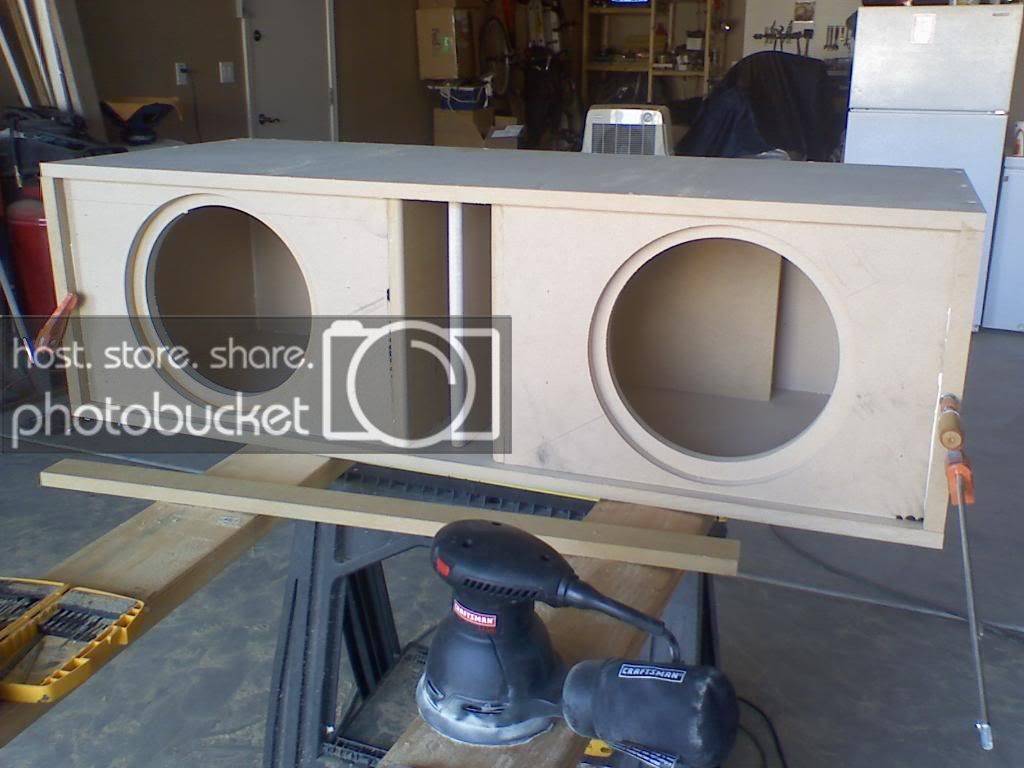

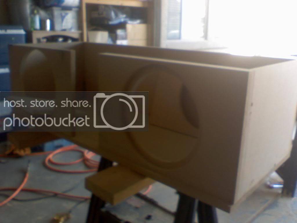

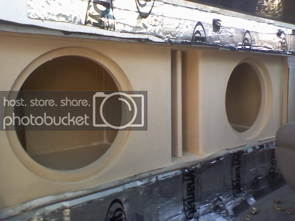

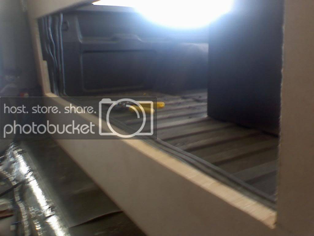

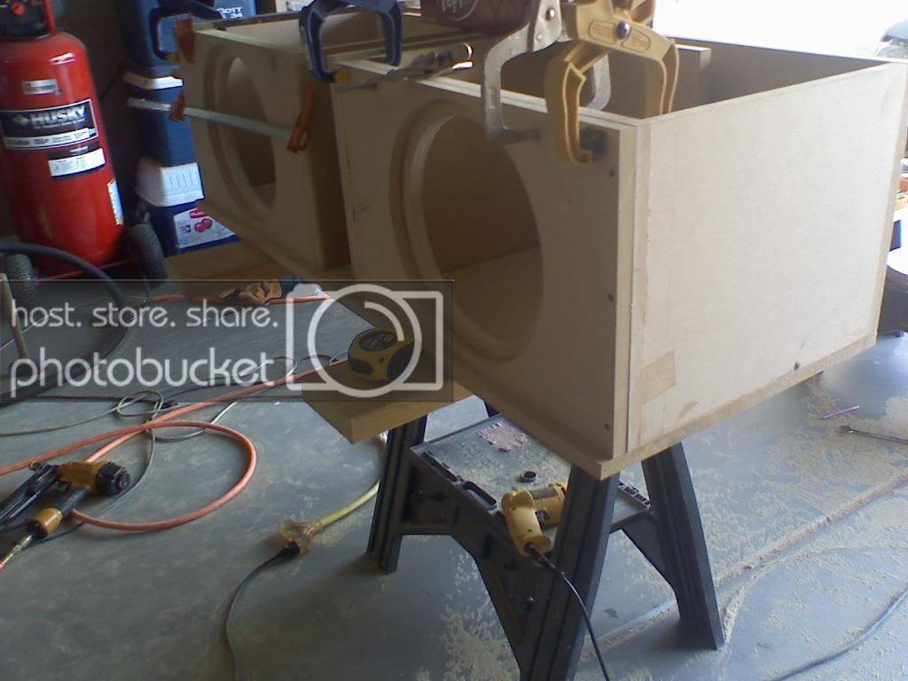

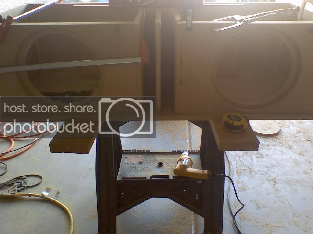

The enclosure:
Test fit in place:
Test fit on the horns:

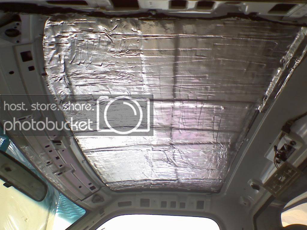

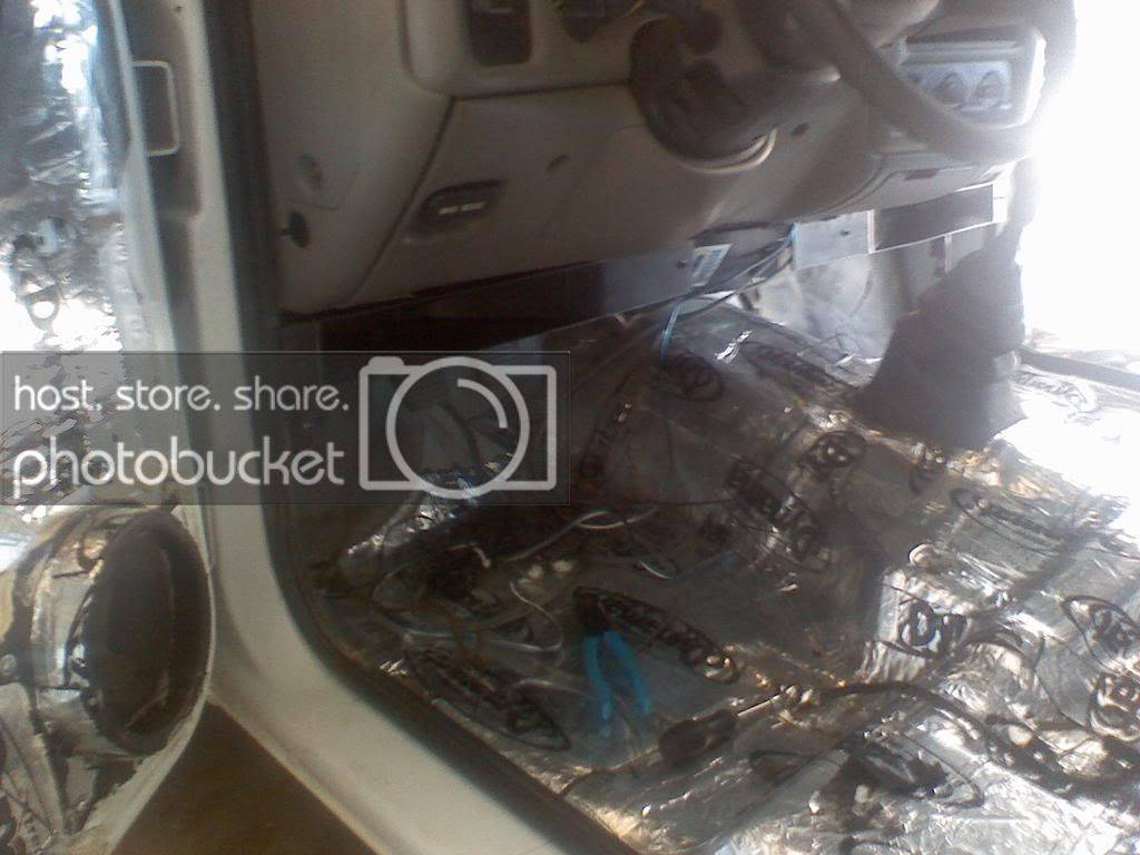

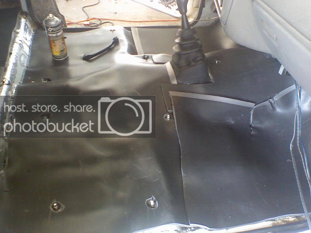

Damplifier Pro on the roof panel:
Continued...

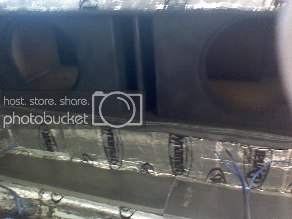

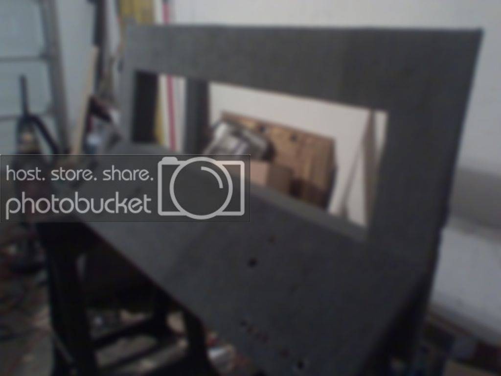

Enclosure coated with several layers of undercoating:

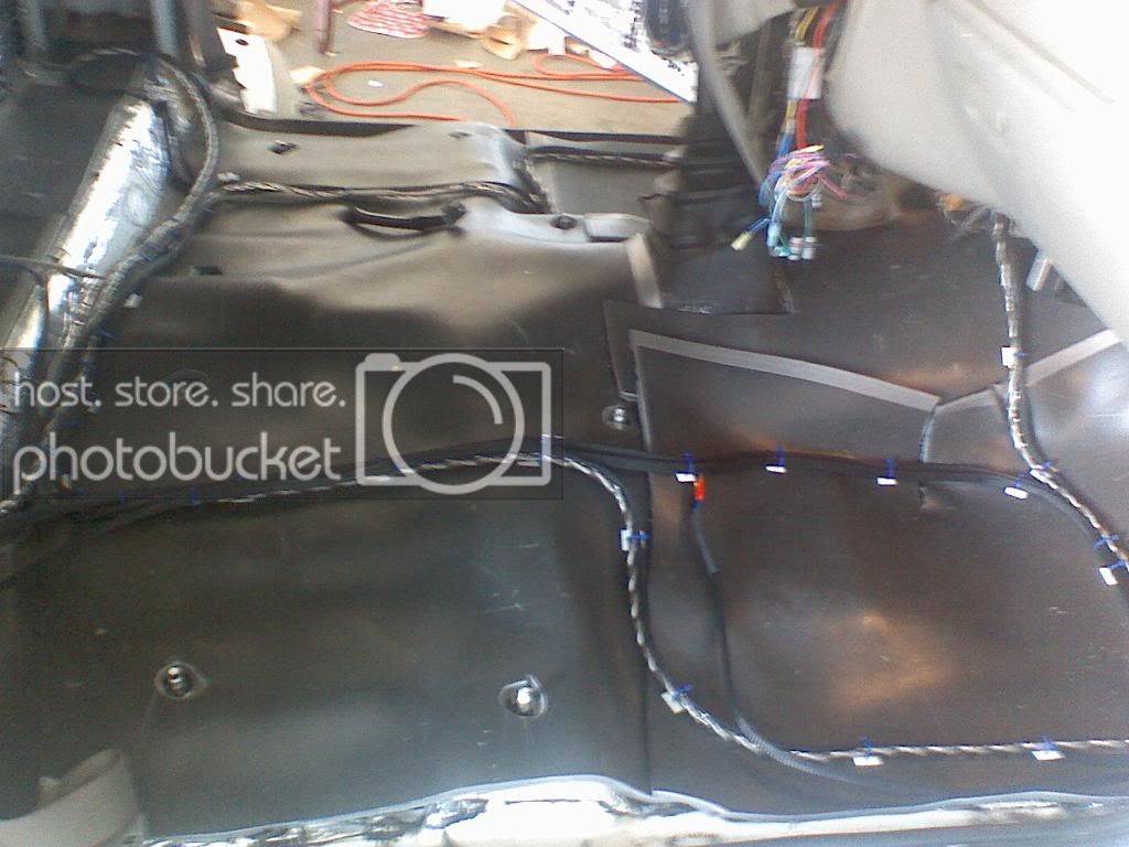

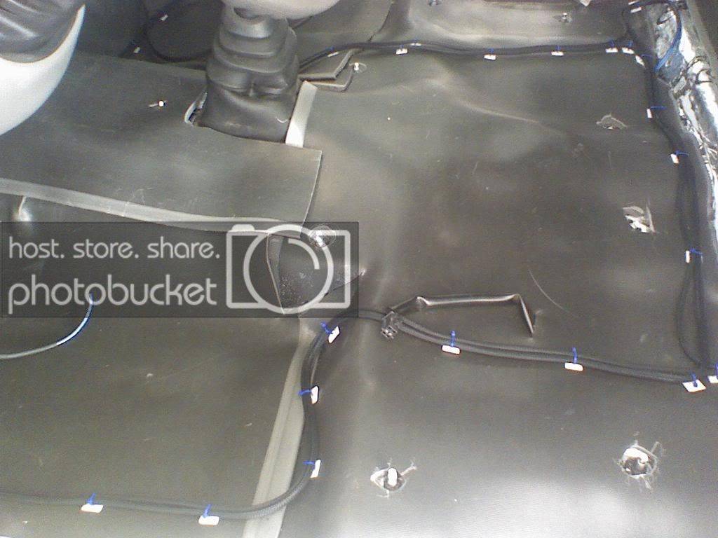

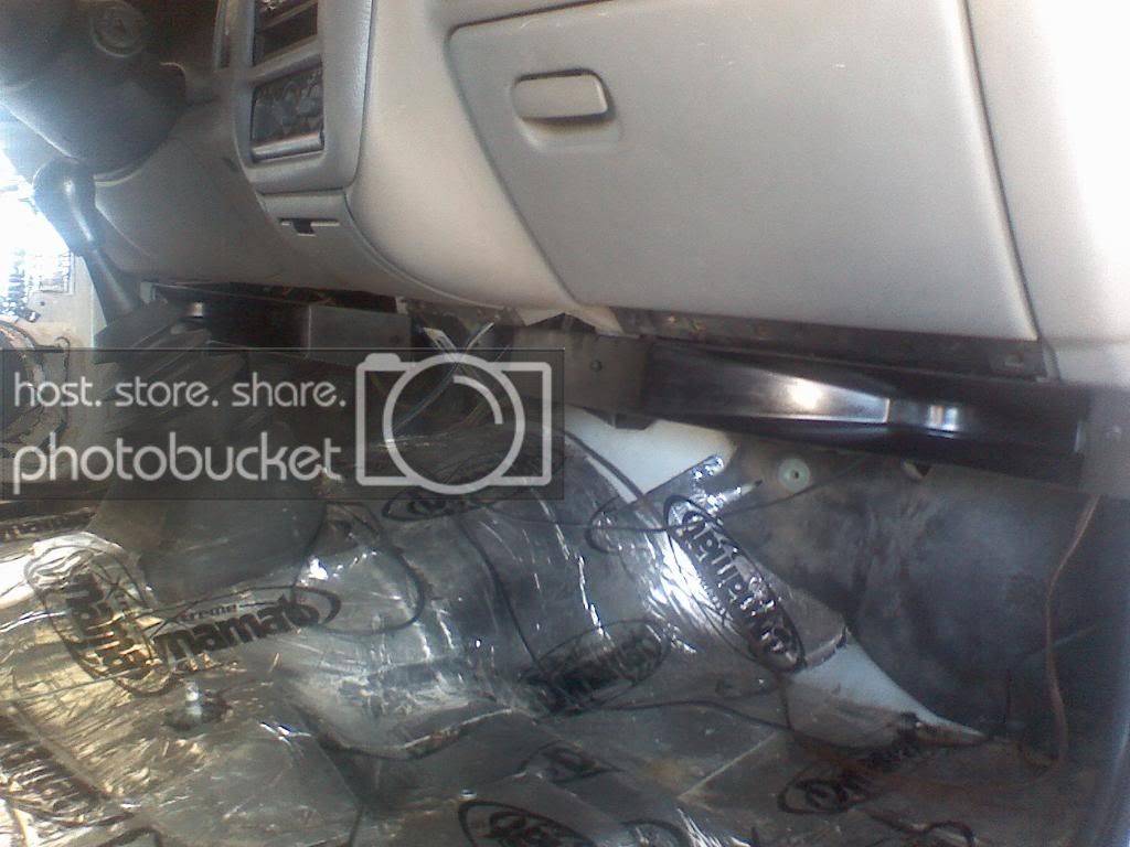

Luxury Liner Pro down, and TechFlex'd wire started:

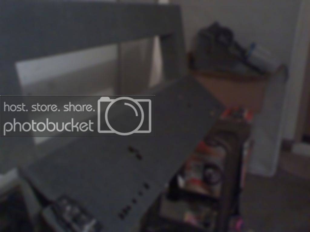

New trim panel built:
Framed with 1/4" x 3.5" MDF strips:

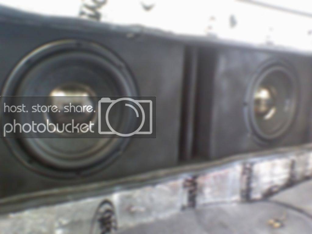

From the bed:

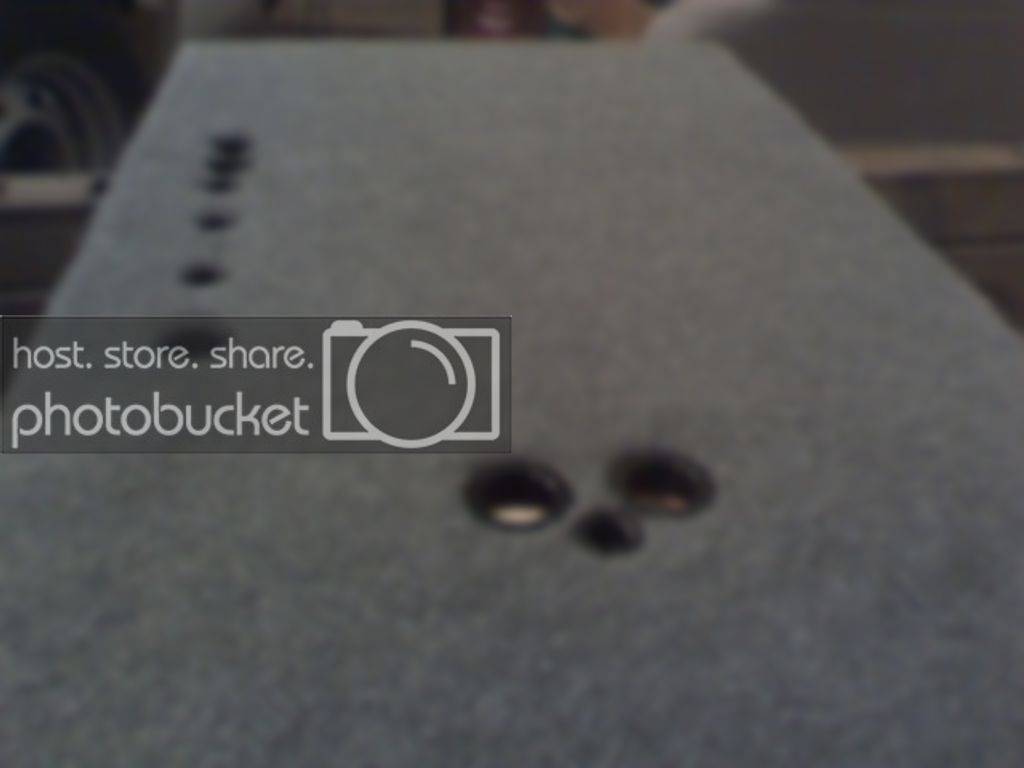

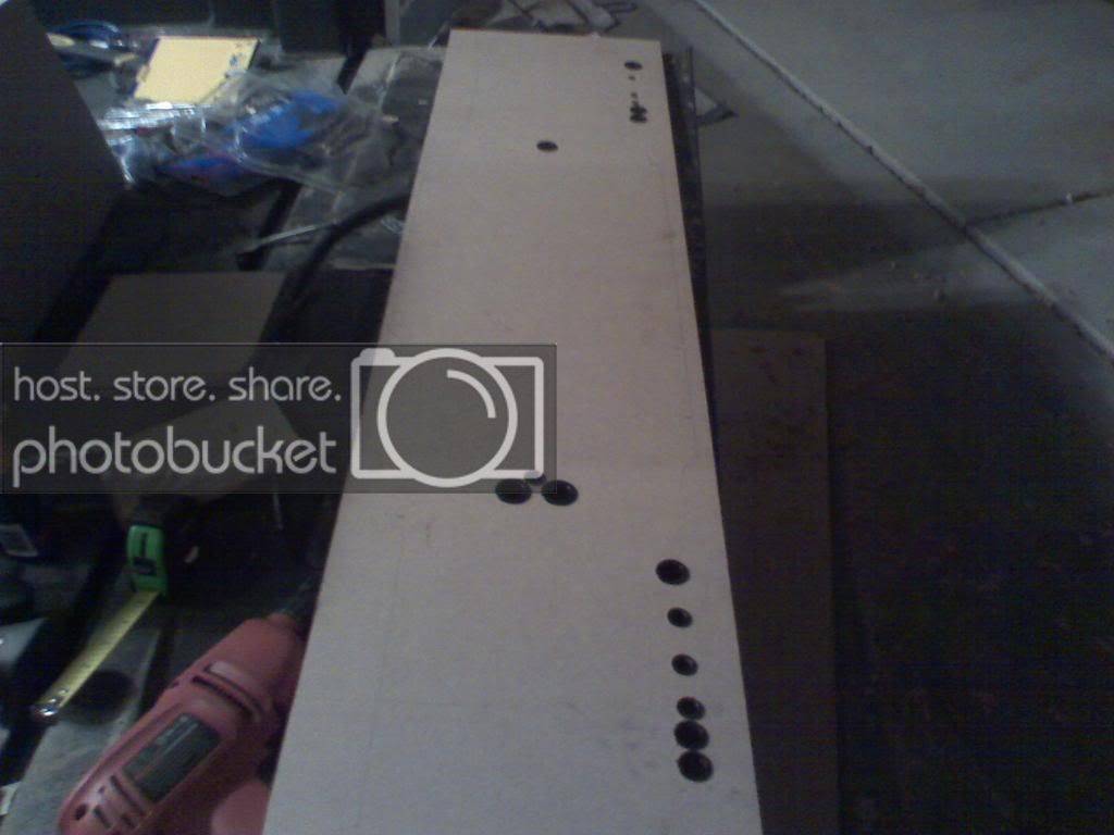

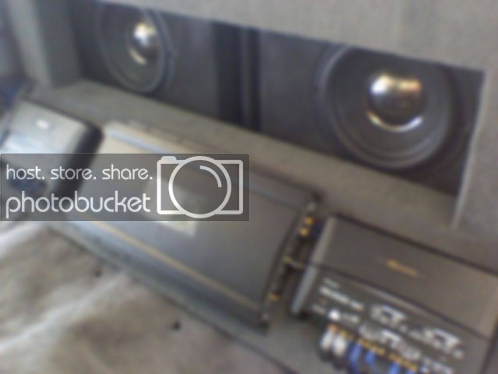

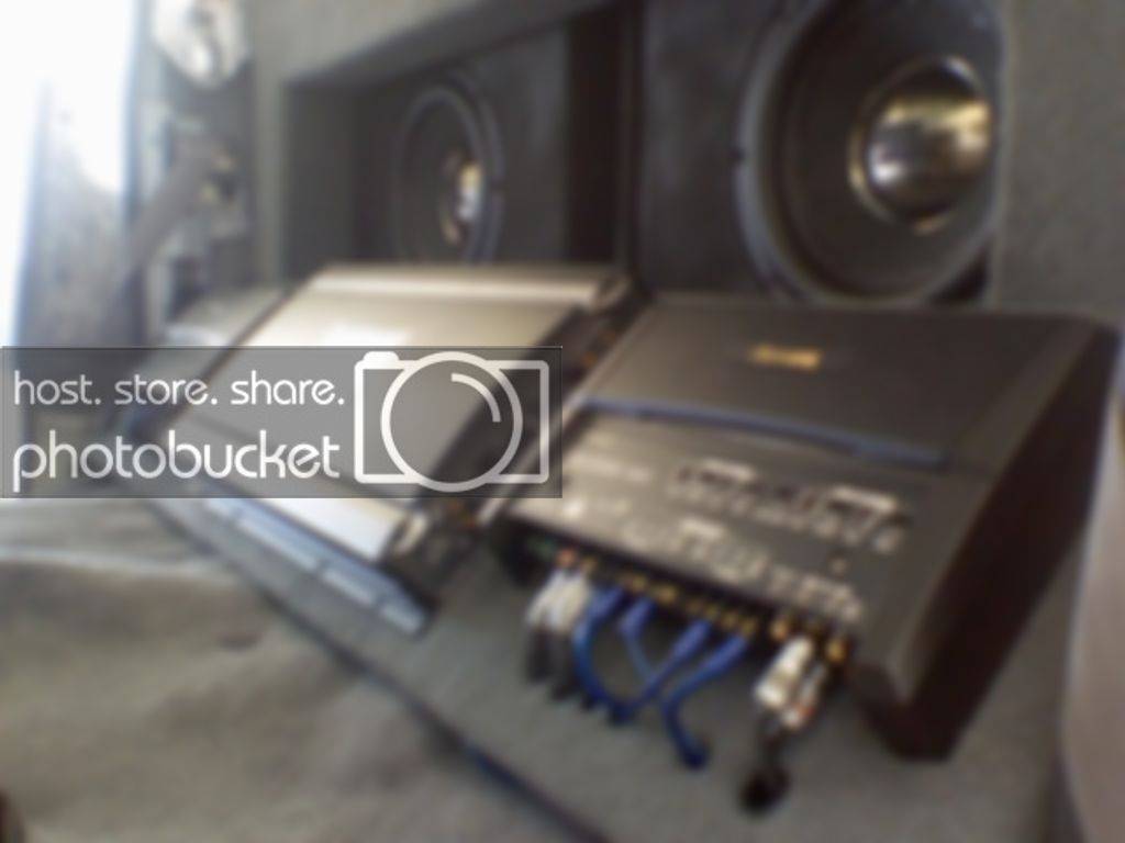

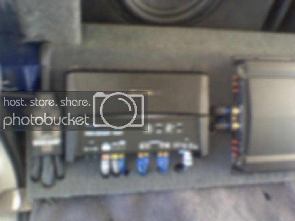

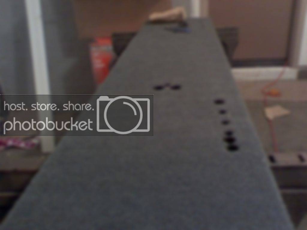

Amp rack built, holes drilled and grommeted:
Carpeted:

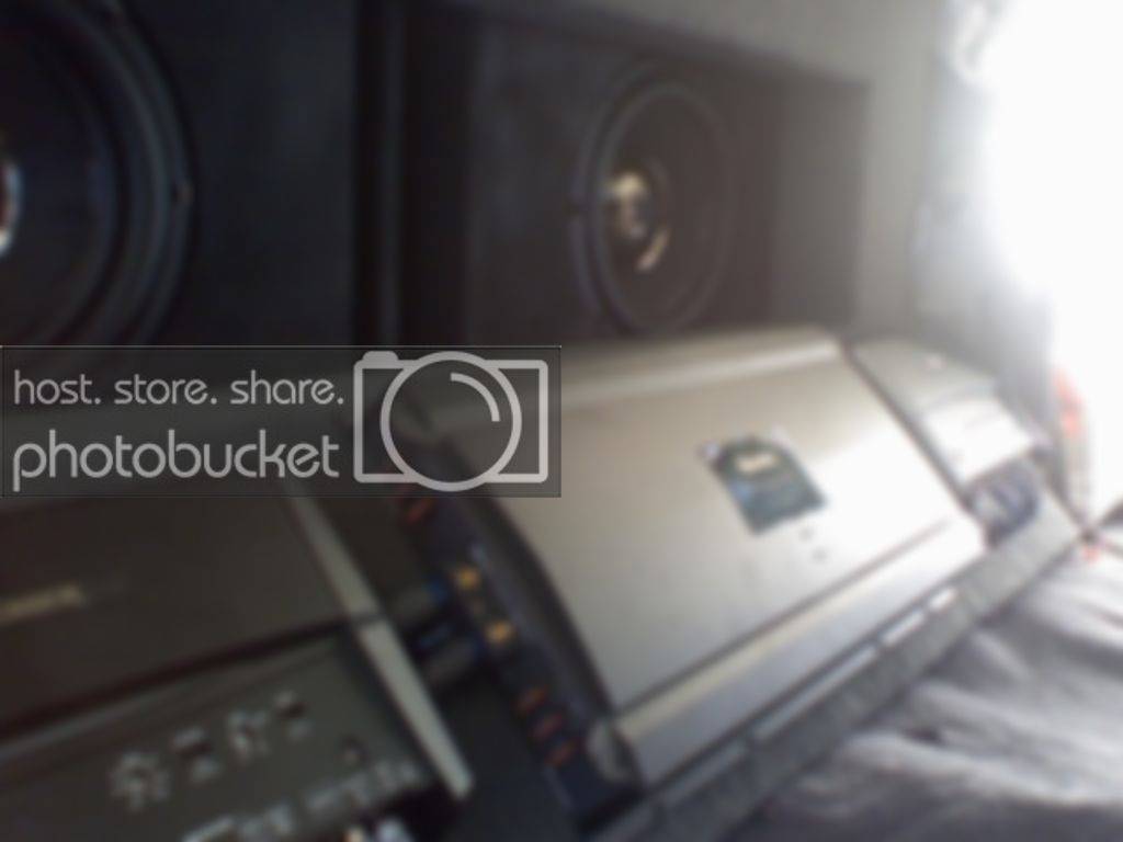

Continued...

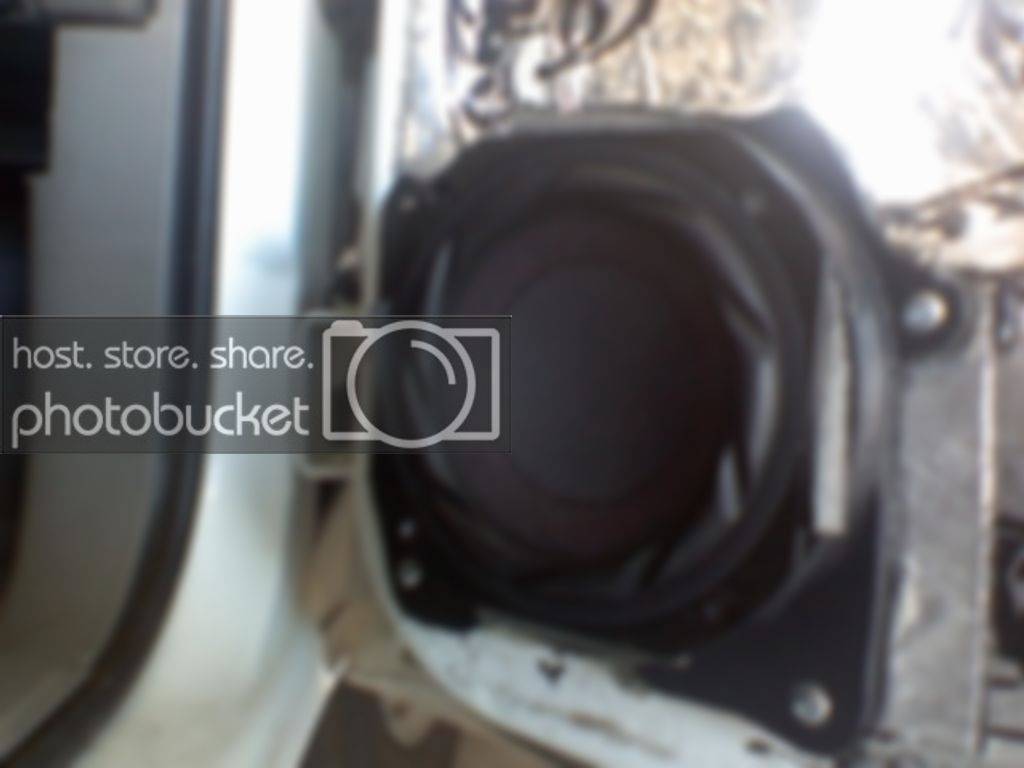

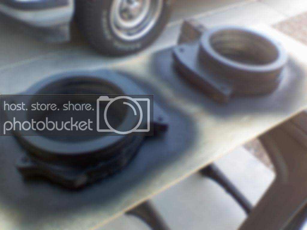

Thanks, Bumpin. It was a long 1.5 weeks, but it turned out great. The install is done, but I need to get some finished pics of the horns installed. The mids ended up being a little larger than 6.5" which is why I had to build the pods. I got the MDF rings from Marv, and built the bases myself. They ended up not coming close to clearing the door panels, so I cut the stock portion of the panel that houses the speaker grille out. I am more than likely doing 8" mids in the doors eventually, so they had to be cut sometime. I will get some grilles made for the time being and get pics up of them.

To whoever had the '94 S-10, this is my 4th or 5th go around at a blowthrough. I was going for a high impact, accurate, SQ(L) setup, and I got exactly what I was looking for. Some guys will enclose their entire bed and vent it into the cab; I'm not into that. The largest you can go without some severe modification would be 12" subs. The bed measures 15" from the underside of the lip to the floor of the bed, and with 3/4" material on both sides, you can only go 13.5" tall. One word of advice- measure twice, cut once. //content.invisioncic.com/y282845/emoticons/wink.gif.608e3ea05f1a9f98611af0861652f8fb.gif If yours is the same as mine, the gas neck creates a bump on the driver's side of the bed. So measure from that on both sides so you can make sure the enclosure is centered. I use Accordion Boot to seal off the cab/bed. You can pick it up online or at a local camper shell dealer. If you have any questions, feel free to PM me. //content.invisioncic.com/y282845/emoticons/wink.gif.608e3ea05f1a9f98611af0861652f8fb.gif

I failed to mention, but I have a 200A alternator, a new dual-post Duralast Gold under the hood, and a Kinetik 800 in the back, which you can kind of see behind the Kicker distribution block. It's tucked away in a little nook, strapped in place and surrounded by some extra Luxury Liner Pro I had left over.
