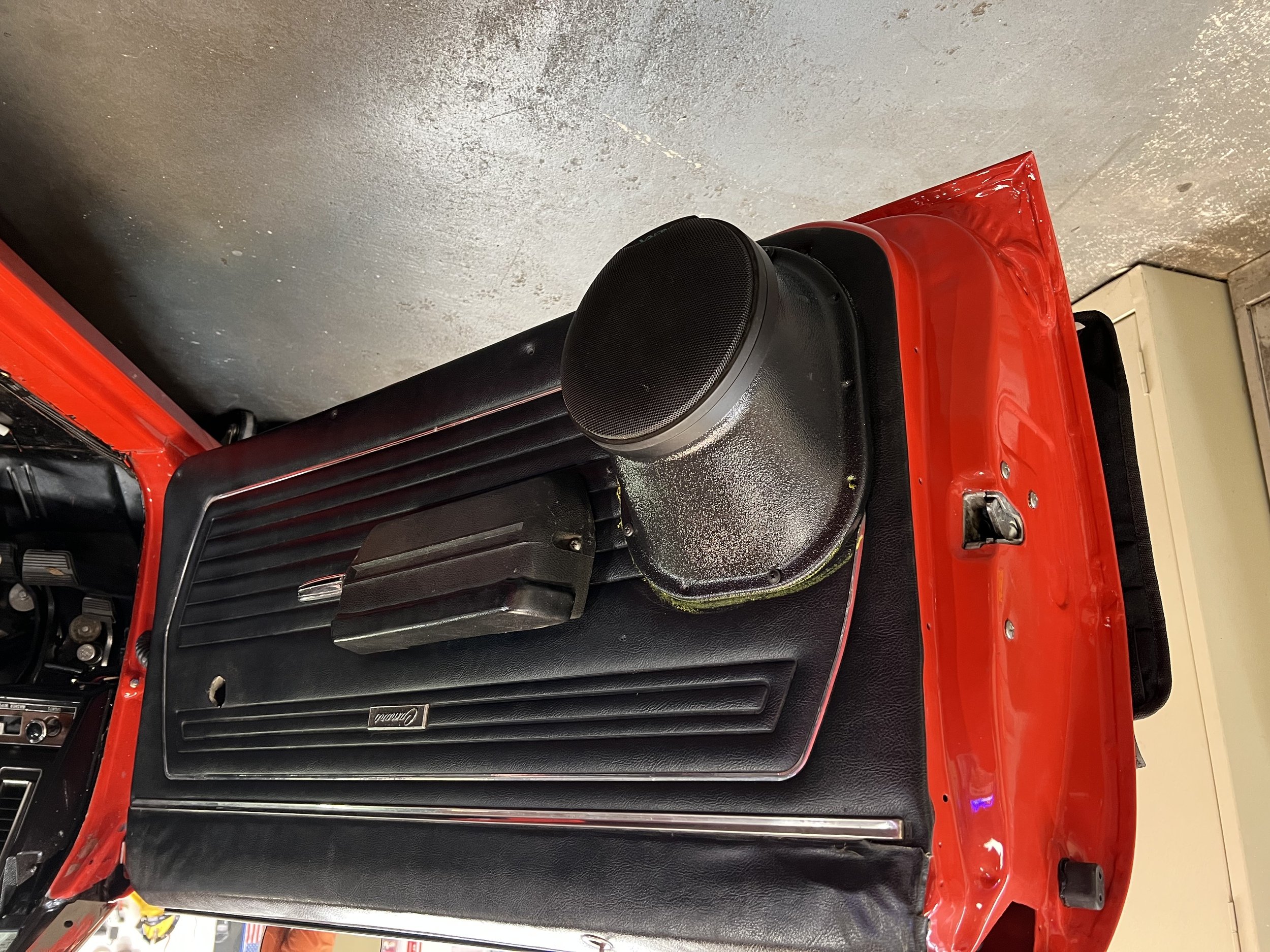

What is that going on in the First Pick?? Are you going to be doing any kind of Deadening or Road Noise preparations at all of Floor deadening at all and doors? A 6.5" mid -bass, and a 3-5.25" Midrange in a Door pod just below the window Crank looks Ideal and a 1" Tweet in a Pod or Angle mount can be Velcroed on the dash with Extreme Velcro so you do not have to make any screw hole penetrations on the dash and it hold up to 75LBS,as wires can be tucked . Be a nice 3 way setup

First pic I’m trying different speaker enclosures. Power door locks and window lifts prevent recessing large speakers into the doors. I’ve ordered other enclosures that are not so weirdly shaped. Lol Any suggested pods for the door? I’d like to see some tweeter pods or angle mounts too. I’m trying not to make too many holes in dash or A pillars.

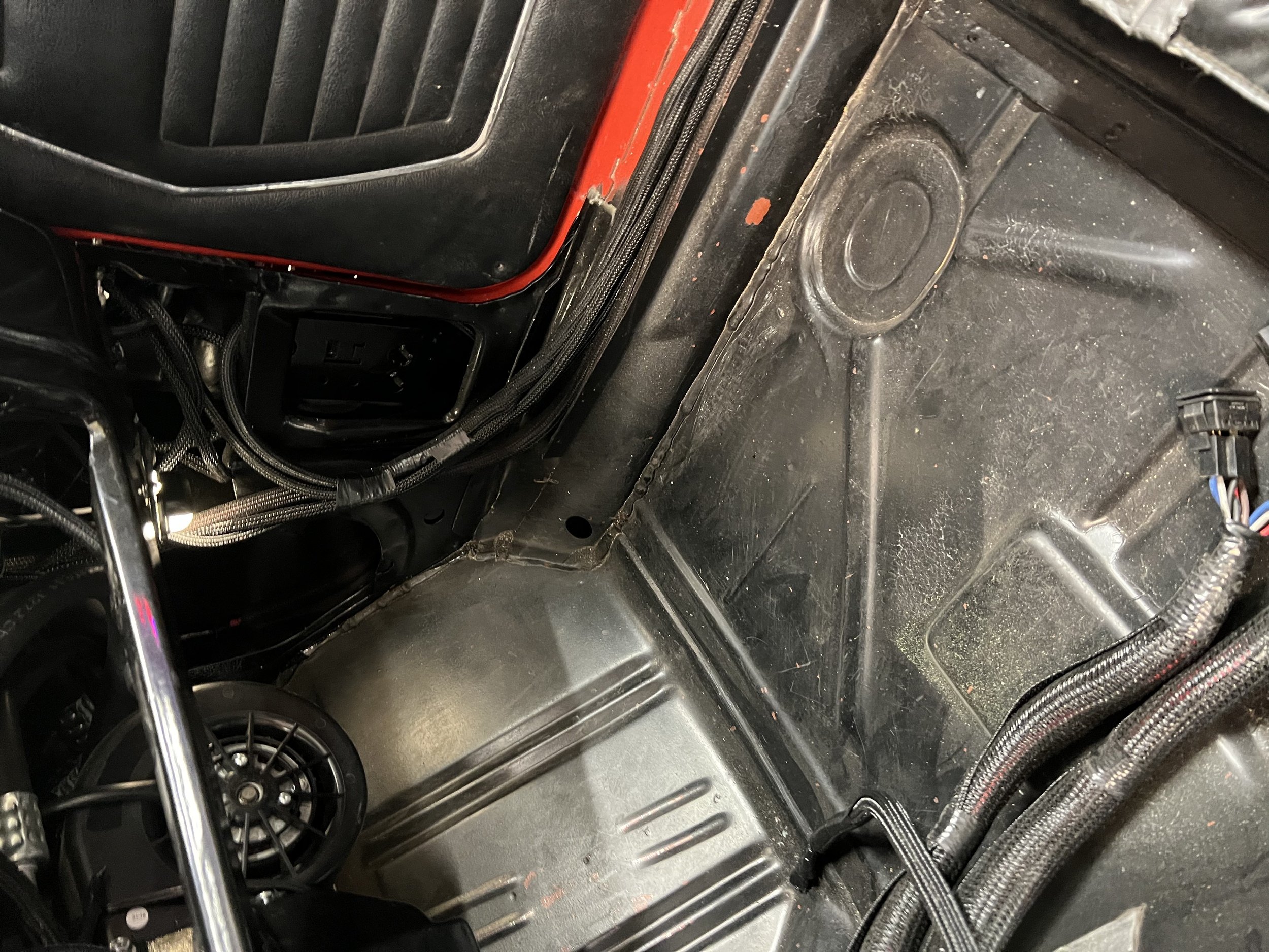

Definitely doing sound deadening and road noise. Still finishing wiring before I lay down final material. Inside doors, quarters, entire trunk, firewall are all covered in Dynamat material. Inner doors will be skinned and vapor barrier too. Floors will have deadening and road noise matting.

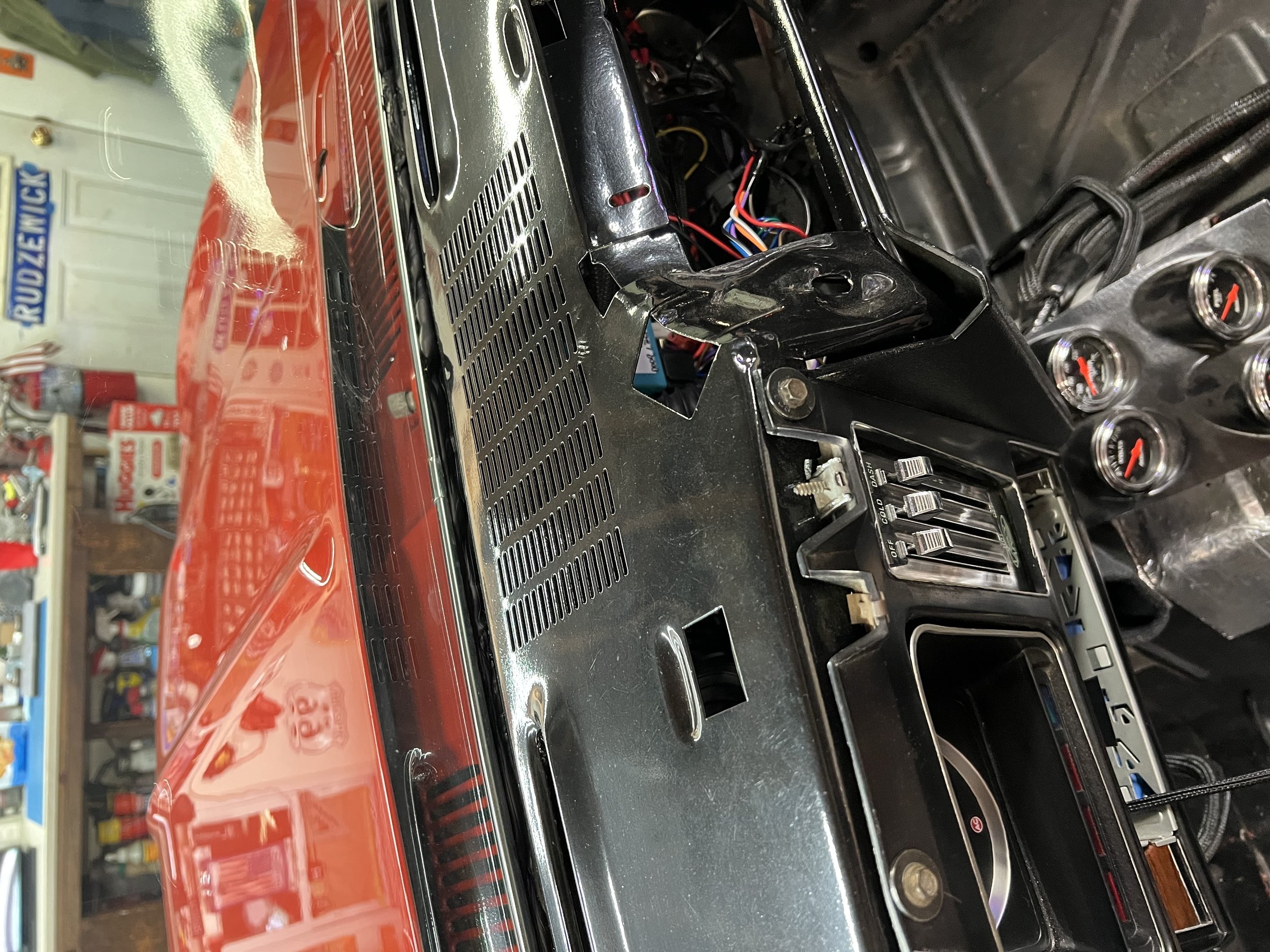

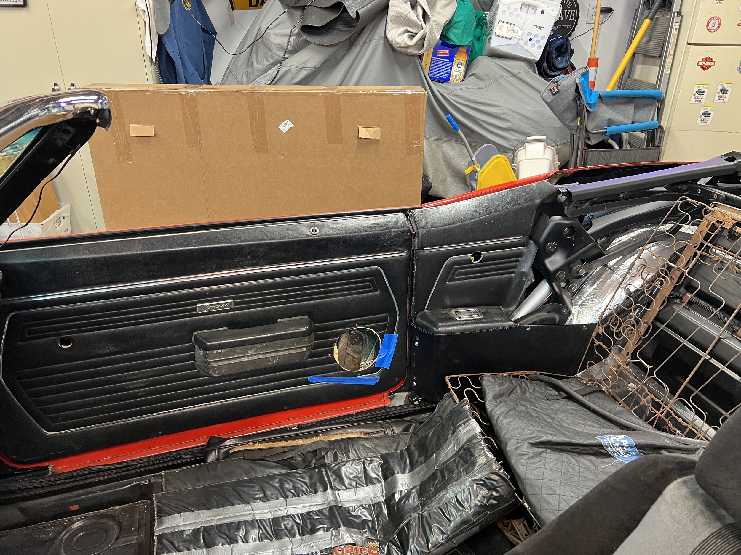

Indeed. I can't imagine the speaker holes in the door now are going to do much for you unless I'm misreading where the seats are going to be. Best option would be to build some custom kickpanels. Kicks are a great location for good imaging and it's a small piece to fab custom that you can remove and reinstall stock panel down the road if needed.

Speaker holes are from an old installation. New door cards will be ordered. Kick panels are tough bc not a lot of volume behind panels and footwells are tight. Small piece of fab custom is not really in my skill level. I’ve ordered a few different ABS enclosures and will see how they fit.

Well, it would be a bit of fuckery but you can always make a mold from your originals and fill that to form the shape. Use plenty of mold release, carnuba wax, etc. Easier than fabbing up new door panels at least and again, a great location to get good imaging.
