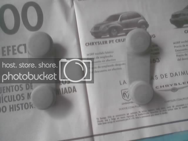

Anyways, today we got around to paiting the window rollers thingy, here some pix.
First i put them in water then i dryed them then i stuck them in rubing alchohol and cleaned them then i sanded with 180 and then i sanded with 320.
Then after i sanded everything i put one coat of black Krylon Fusion Black paint.
Then i let it dry and i noticed that it was as black as i wanted it so i applied the clear coat.
