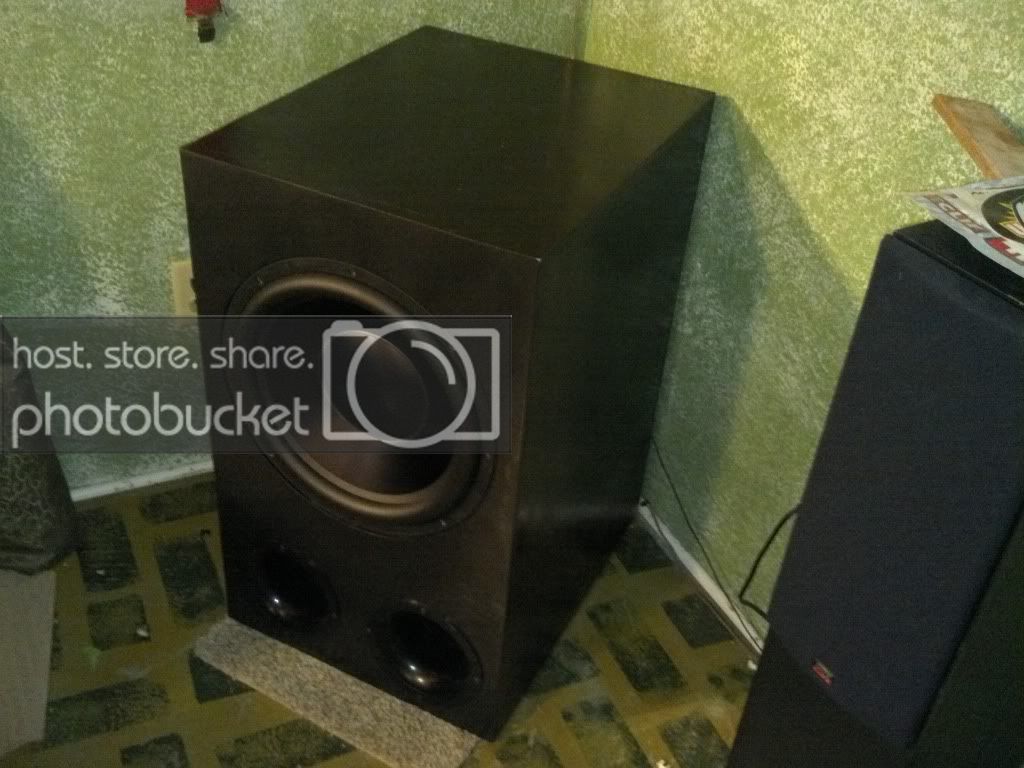

Ended up going 3.5ft^3 at 30hz. I tuned it high because it is only for music use. It does much better than I thought it would. Now I just need to build the second one!
That is 3.5 net after sub, amp, port, and window style bracing. I should have got some build pics... I will try to remember to on the next one!
The box is 30"Hx18"Wx22.75"D. 2 4" ports 15.5" long. The box has one "window" style brace right below the sub and a double baffle. The double baffle might not be necessary but I wanted to flush mount the sub.
