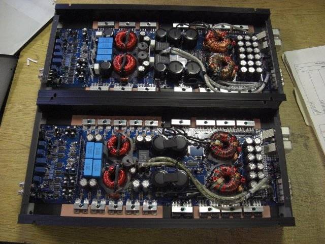

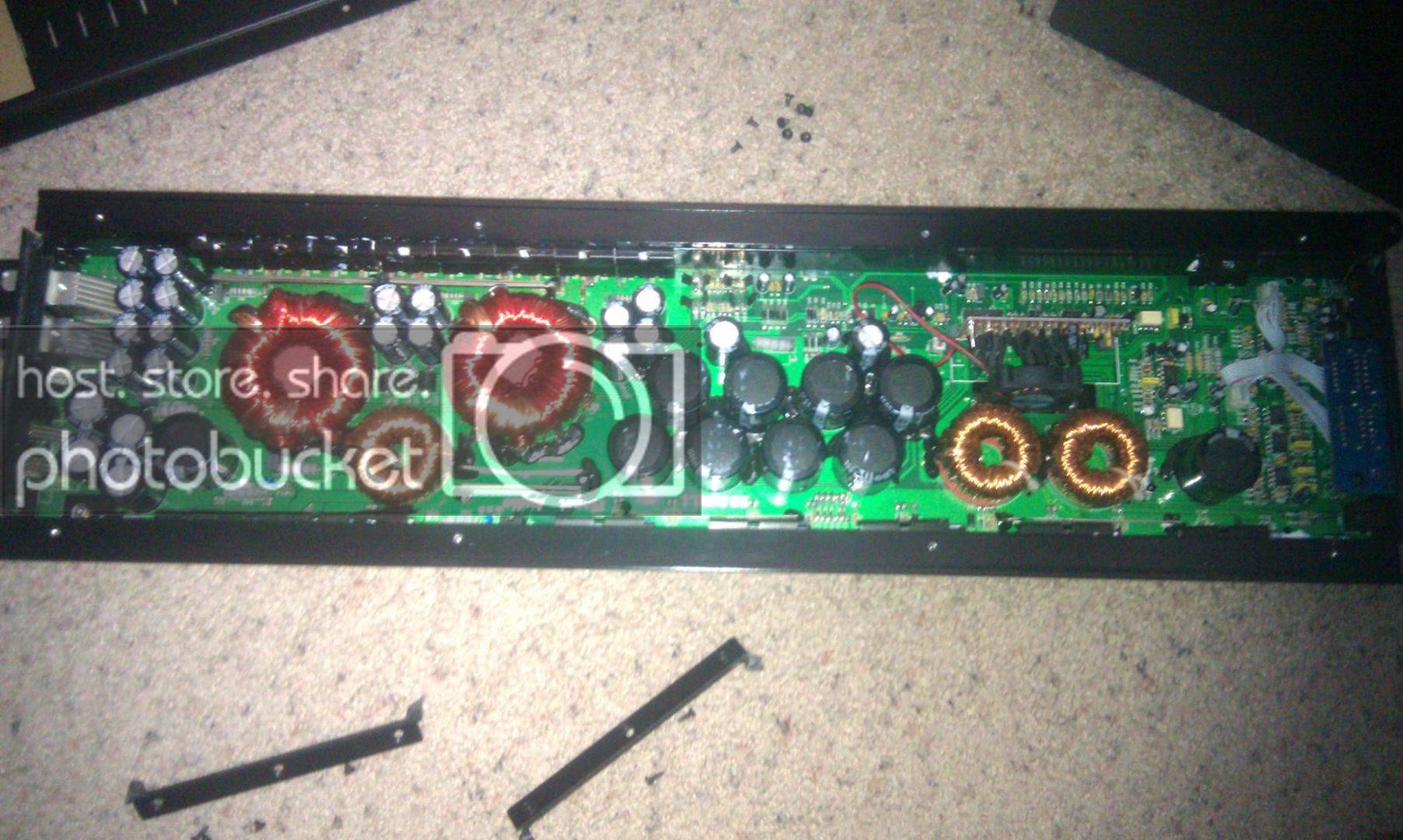

The BB2400.1 is hit or miss. I have heard some people who had issues soon on who knew what they were doing and others who had great experiences. They aren't the most reliable amps and the internals are pretty cheap hence them being budget amps. Personally I would rather run a Mb quart Onyx 2000d than a Planet Audio BB2400.1. Anyways some comparison pics of internals for you.
BB2400.1
Aq2200d

Ia 20.1 (not dc 2k)
Sundown 2000d and 2500d
Top is the 2.5 bottom is the 2
DC 2k
Good stuff, murph. Thanks for the effort.
Myself, I can't tell which one of those is better. They all look to be built pretty well, even the BB. I do great when it comes to class A/B stuff but I have very little practical experience when it comes to class D layouts. I went with the Clarion for my current stuff (actually class G/H), not only because it was the right amount of power, but also because it was a Zeff design. It actually sounds beautiful but I only have one. Ideally, I could strap them and have 3k @ 4ohms if I could find another. That's a crazy amount of power for me, personally. 2k(ish) @ 1ohm from one amplifier sounds more reasonable to me. I think it would be enough.

The parts on the BB are really cheap and the board is HUGE for the amount of watts it puts out. The AQ will be the cheapest one that preforms better than the BB2400.1. The IA 20.1 is the beefiest and most well built IMO but, also costs the most. The benefit with the AQ is the subsonic goes down to 10hz while most of these are 20hz if you plan on playing any subsonic bass. When talking class D amps once you get out of the budget section they all sound the same for the most part. A lot of budget amps have a hard time playing the lows 30-20hz.
