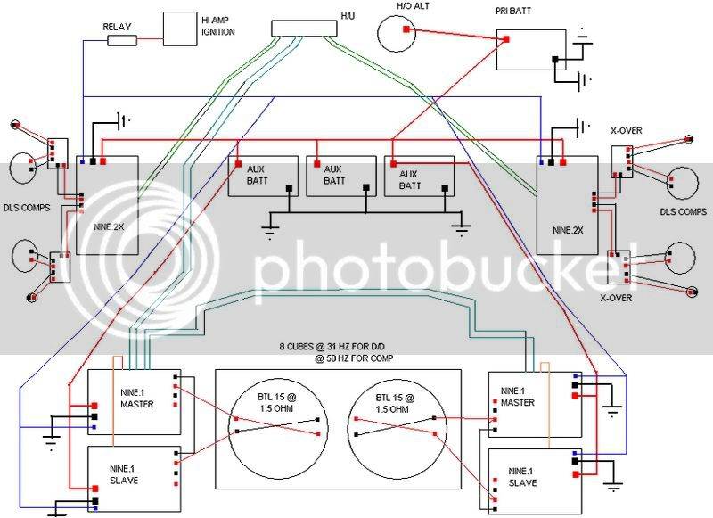

Need some opinions. Welcome all ideas.

How long did it take to do that drawing? And don't say 5 minutes, cause I know that's a lie!

Yes the drawing took me about 5 min. I draw them all teh time and got pretty good at it. As far as the wiring, i don't understand why you think it's so much. It's a diagram that is drawn to show detail. Not exact scale footage of wire. The reason i just used the link in the original post is because i am on an INMARSAT connection. If you don't know what that is it is a commercial and military satellite link and it's slower than mollasses on a cold day. It takes an hour just to get online and make one post. guess that shows my dedication to the forum. What i would like is opinions of the setup. What do you like and dislike? Obviously my goal is SPL but still musical. I'm considering a changable port for comps.

Well it's actually closer to 6000 if not more depending on voltage. The amps are 2400 strapped @ 2 ohm with 12.8 volts in. I'll be running each strapped pair at 1.5 with hopefully close to 14 volts continuously. I expect 1500 from each amp at the very least. I've decided to go with the 2 15s based on the comments about putting all that power on one sub for daily. I'm still coming up with ideas as far as a changable port. I may end up just doing one like meade. We will have to see. It's going to depend on how deep i can make the box. A changable port probably cant use any interior wall as a port wall so i will have to figure that out. Probably tuned to high 40s or low 50s. Does anyone know what the resonating freq of a 4 door 2006 blazer is? There is also going to be like 300 sq ft of deadener in it.

Yup , the dsp should have input sections, it may have one for sub? Hu to dsp. Dsp to amps, amps to speakers. Probably help you to draw this all...
