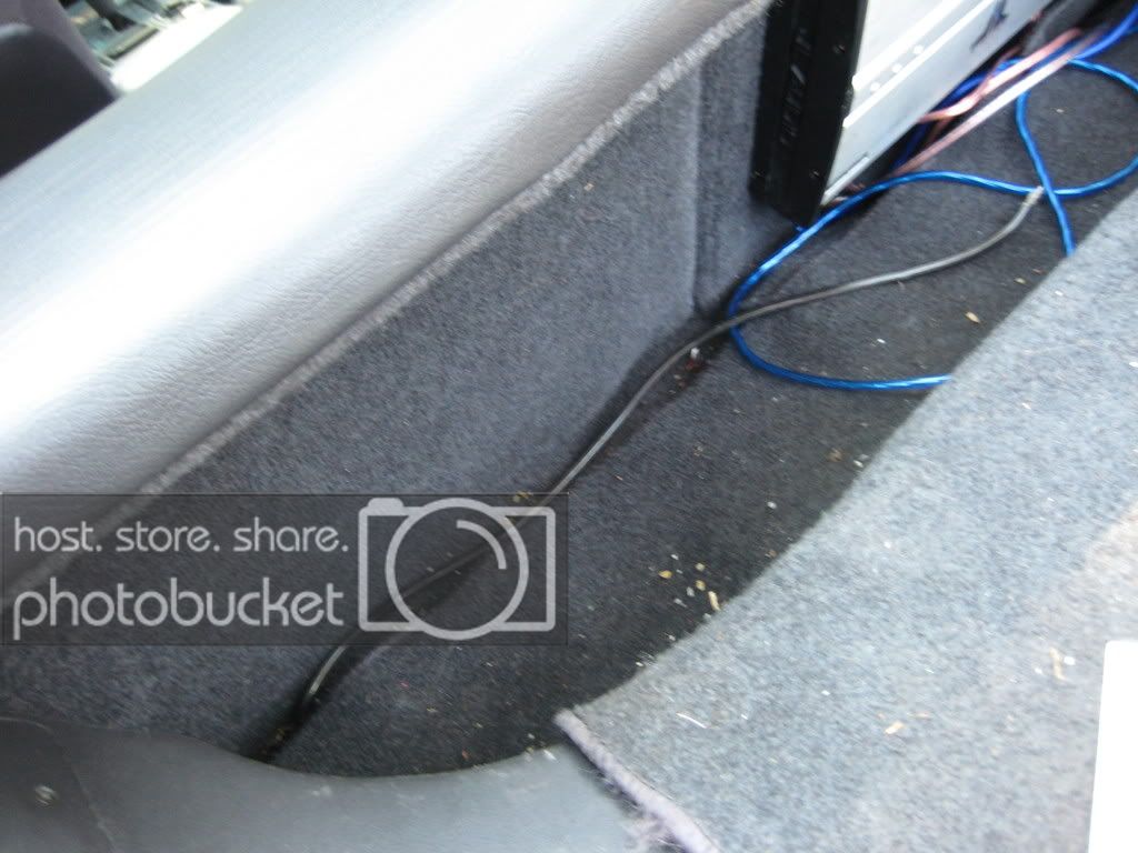

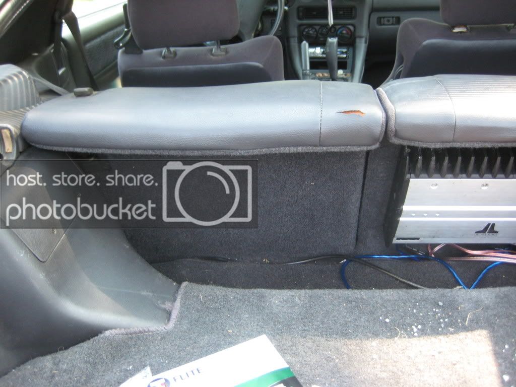

In the pictures, i want to put 1 8" RE RE in that space. I have tons of MDF lying around and want to put some bass in my car to go with my components. I can move the amp over some, and have at least 10-12" height, 12-14" width, but the problem is depth. I have about 6-6.5" depth, of which ill lose about 1.5 to the MDF. The mounting depth on the RE is 4 inches, so that leaves me with about 1/2" inside the enclosure, is that enough ? Also, how much room do i need to leave infront of the enclosure for the excursion so it does not hit that bump infront of it?
Also, i can get any wood for free/cheap, is there any other thiner wood material i could use to make the Box and not take up 1.5 inches of room?
So lets say to be realisitic i have 6.25 inches to work with. If i design the box to be 5.75 inches including MDF deep, that will leave me 1" inside the enclosure for pole vent, and .5 inches infront of the enclosure for excursion, does that sound good?
