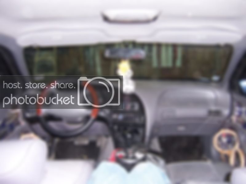

not my install, just to give you an idea of what's possible on A-pillars.
Thanks for the pic.
I just dont really want to get crazy with the a-pillars. I want to keep them as simple and low profile as possible.
Ive got some room there, but I would really start running into visibility issues in the drivers seat with anything crazy going on.
Pretty much the whole limiting factor with space up front is the dash. The design of it wraps around the driver and is pretty huge. Im a big fan of it though, one of the main reasons Ive had 2 of these cars.
