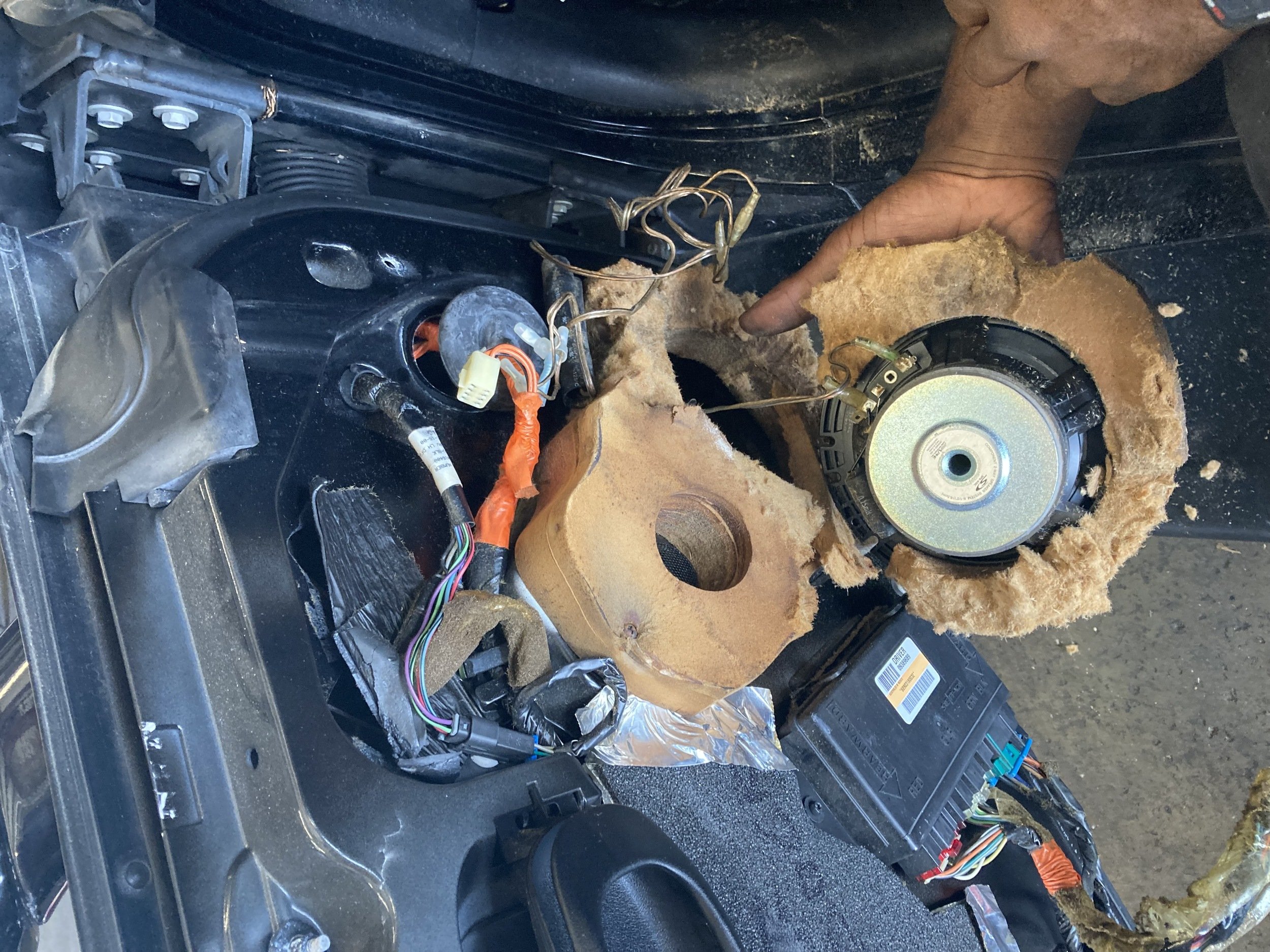

The car is a 2001 Z06 Corvette. This is what happened to the door.
Anytime the wire moves in the door accordion the whole door panel cuts out.
I think this is why their is a voltage drain issue happening with the car. The connection keeps opening and closing.
The speaker system is a Alpine SPS-610C
As you can see the MDF expanded for some reason. Even the screws look bad.
This looks like a very bad install job that went horribly wrong. Can anyone tell me where I can get new speaker plates?

There is a few places that do custom stuff like that. Never use MDF in the door panels. I have a guy who does custom 6x8 and custom tweeter pods for me off of eBay. He charges me anywhere from 11 bucks up to 25 shipped for ones that are 3D printed and they are very strong. If you have a 3D printer file or can find one he might be able to build you a set. If he can't maybe he can find someone for you. Also take a look around at the 3D file sites that are out there that is how I found my tweeter pod file he used then he changed it for my tweeters I am going to use.
