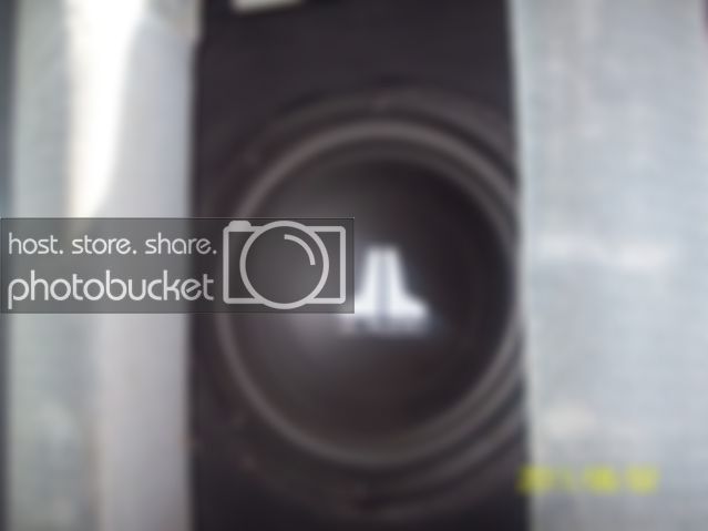

I worked on mounting the sub better today.
Building a baffle to seal the sub to the cabin was not as hard as I thought it would be.
I built the baffle, it came out good. Not perfect but not bad.
Def sounds good. Much better than before. Not as dead as when I just had the box firing forward with no baffle and not as boomy as when I had it pointed into the corner.
I have the trunk room that I was looking for out of this build.
I think I will swap out the 10" for a 12" with a better box (not a Ebay prefab) and add my JL Audio 500/1 to power it.
Right now I just want to finish this build and enjoy it for a while.
Here is a couple of pics - not pro quality but I am real happy with it.
