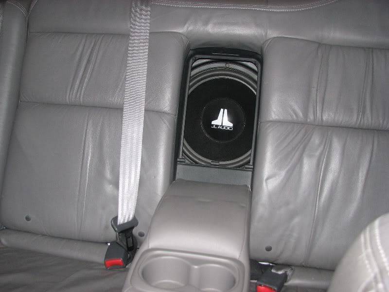

heres how i positioned my sub in my Accord sedan...
Do you keep your Ski Port / Armrest open?

i had this behind my rear seat for a while - this sub was Aperiodic with a baffle sealing off the trunk
trunk of that setup (i could fit golf clubs or strollers)
with covers removed - you can see the aperiodic grill, the baffle had a hole cut out so it was just carpet behind the grill
and with a JL - both were centered in the ski hole
now i have a pair of 12's in a trunk baffle setup.
