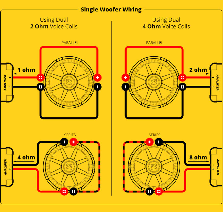

are u sure u didn't wire + to a -? it's a dvc sub is it 2 or 4 ohm dvc? most of the time u get a short wire say 1ft long stick it in both + terminals and a 2nd wire - to other - then stick wires coming from box (or amp) into 1 of the + and - on same side of sub so 1 set of terminals will have 2 wires in each terminal that will give u either a 2 or a 1 ohm load depending on what ohm each coil is.. also thier are pics of this everywhere...this wires sub to a higher load (less power from amp) https://www.bing.com/images/search?view=detailV2&ccid=xSrp8Qzf&id=96265BC3F2F44DFDD026B30542FA70AD73CA7DA6&q=dvc+sub+wiring&simid=608018008734172047&selectedIndex=0&ajaxhist=0 this wires sub lower (more power from amp) https://www.bing.com/images/search?view=detailV2&ccid=maQ0Ds50&id=53D0C499E1D6592DDC043D24E567D29B30422DCF&q=dvc+sub+wiring&simid=608056130867299580&selectedindex=1&ajaxhist=0&first=1&thid=OIP.maQ0Ds50rDYuyIRFy1JXFgDoEs

You said your kicker is 2ohm DVC, if so that wires to 1ohm if in parallel. 4 ohm in series. If you wired in parallel your amp isn't 1ohm stable and you could be smelling it

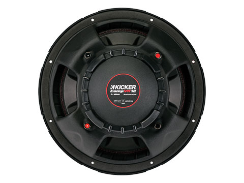

Two of the connections are painted solid red and black. The other two have dots. I had it wired correctly for parallel.

I do not think you have it correct at all.
You should be using ALL FOUR connectors of the sub not just 2 of them.
Here is a picture of your sub, explain which wires you have going to what connectors.
