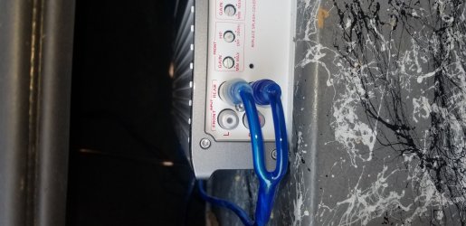

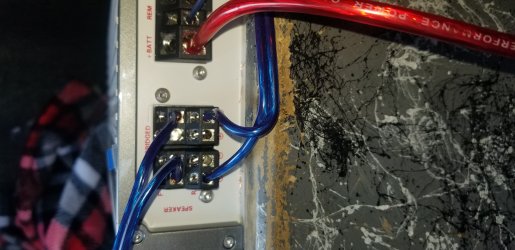

Lol thats why i came here lol. Thank you. This is correct? Now just split the input so all 4 rca jacks are full?
Yes.. Make sure that you have the + and Neg wires for the sub in the Bridged correctly and make sure that you have the Xover set to LP/LPF. Make sure your gains on the amplifier are set to bare min, and you can tune from there properly so you dont cook a sub coil. LOL, and yes on the Y splitters for the amplifier
