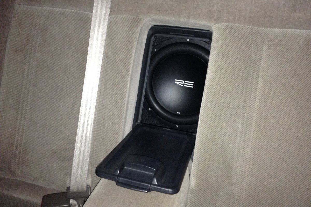

i have a 99 Accord sedan, have my sub facing the front bumper, firing thru the armrest/port thing. sounds really good. had it facing the rear bumper, but i didnt like it sitting like that, didnt want to put stuff in the trunk because i was afraid it might mess up my sub
spare tire is under sub/carpet thing. works fine
my amp is mounted on the side of my box. i put some rubber washers under the amp to help with vibration. 3 months and still working so far
