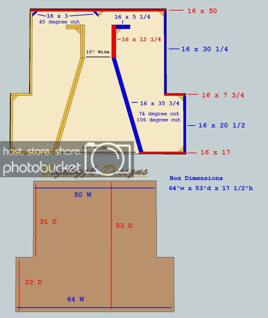

Need help with my blow thru tuning.
driftman11
Junior Member
This box is supposed to be 13.1cuft at 32htz. I was wondering if I could get Sumone to check it to see if it's correct. First time to design this type. From inside back wall to port its 5". At least check my tuning would make me happy! Thanks a lot..
